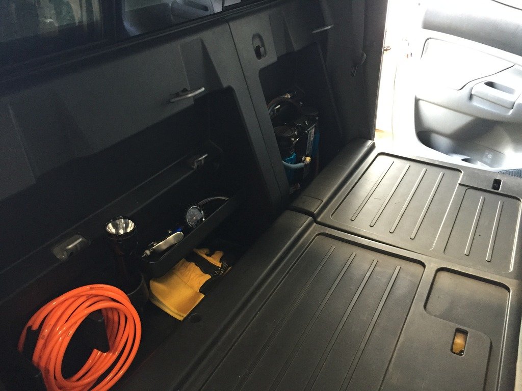

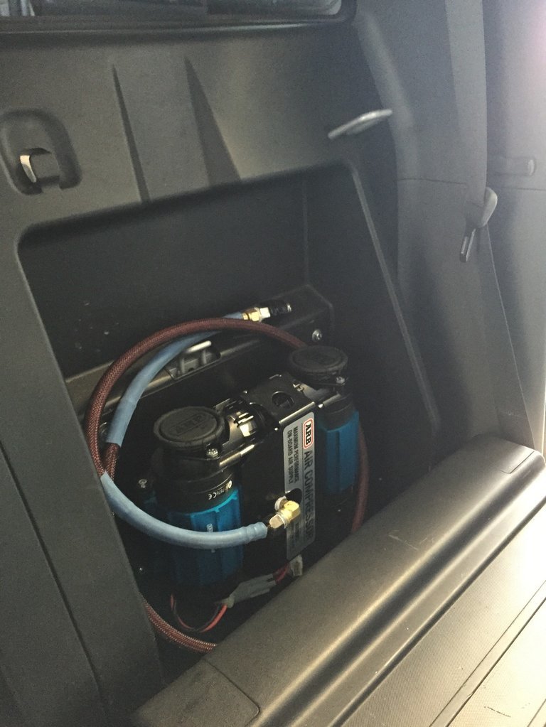

    I LOVE my ARB dual compressor. Yes it is expensive but you have TWO compressors.
    It all depends on what you are going to do with your truck.. What size tires are you going to be running? If its anything over 33" tires then i'd go dual because it'll take a while to fill them up each time with just a single.
    Do you plan on running any air tools? If yes then you have to go with the ARB dual compressor from what i have heard the single isn't enough to keep a tank filled.
    Are you going to run lockers as well? Im not sure if the single can run both front and rear lockers but the dual will easily.
    I plan on putting on 35" tires and running full lockers in the future so thats why I went with the dual. As for mounting the guys at Mule Expedition Outfitters made me a custom mount, wired up and installed my compressor yesterday in 3 hours, behind the rear seat on the drivers side. If you'd like to take a look at it sometime let me know id be happy to show you. The dual is to big to fit anywhere under the hood without moving something so thats why I mounted it elsewhere but under the hood would have been most ideal. Hope this makes sense and im not just rambling haha
    As for Viair I don't know much about that other than JDAM has one and loves it. If you don't plan on running lockers and just want a good portable compressor then it is a good option.

    NWTaco, that setup looks awesome!!

    Thanks!! I love it, I know I said before "who needs OBA when you could have a CO2 tank and fill your tires 3 times faster" but this compressor is so amazing, Mule did a perfect install on it and couldn't be happier.
    BTW if all you want to do is fill up your tires then a 5lb or 10lb CO2 tank is another good option, if you don't mind having to refill it every so often.
