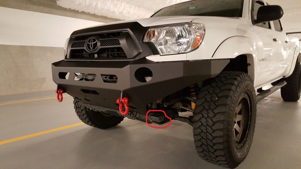

    so can i cut off the extension that i have circled on both sides?

    Don't cut there is a bolt under them that you take out and then they slide out

    Thanks! good thing i asked...

    They are held on with red loctite so may need some force to get out

    My ARB didn't come with the bolt plate so I did cut that section since you need something there to bolt to.
