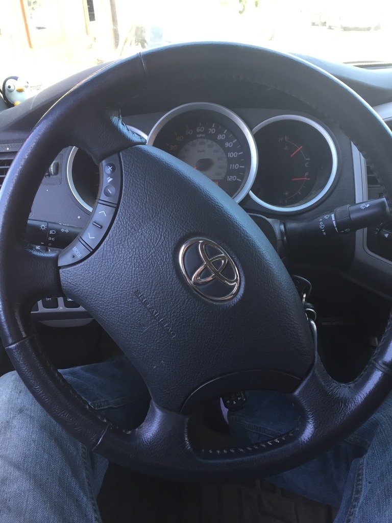

    Get longer shackles to raise the rear more?

    Could do a shackle flip but if you are at 3.5" up front your cv's must hate you..

    Does it pull to the right if you let go of the wheel. Mine is turned slightly to the right too. About 1/3 of that amount.

    Sure does, I'll be getting it aligned in the future

    If the only alignment problem is the steering wheel not being straight it's easy to fix it by adjusting the tie rods in on one side and out on the other side. If you turn them both the same number of turns alignment won't be affected.

    This can fix the steering wheel alignment but it will do nothing for the pull to the right. Both of us have that too.

    Could be your rear axle is dog legging, mine was like that

    What was the fix?

    Your alignment sheet will say if something is out of whack in the rear, I think it's toe but could be wrong..
    Put jack stands under the frame with rear at full droop, loosen the ubolts (on the side it's pulling to) and shake the axle back and forth. That'll recenter the axle. I didn't think I moved mine at all but it doesn't pull anymore
