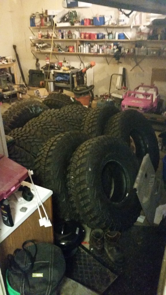

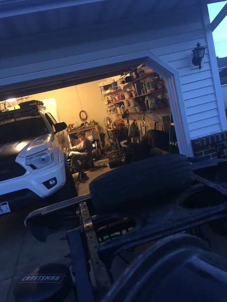

    Here's what's in the garage now...

    Theres actual work goign on wayyy in the back lol

    The sad thing is theres still two on the truck and the spare still in the bed...

    that's a lot of rubber...

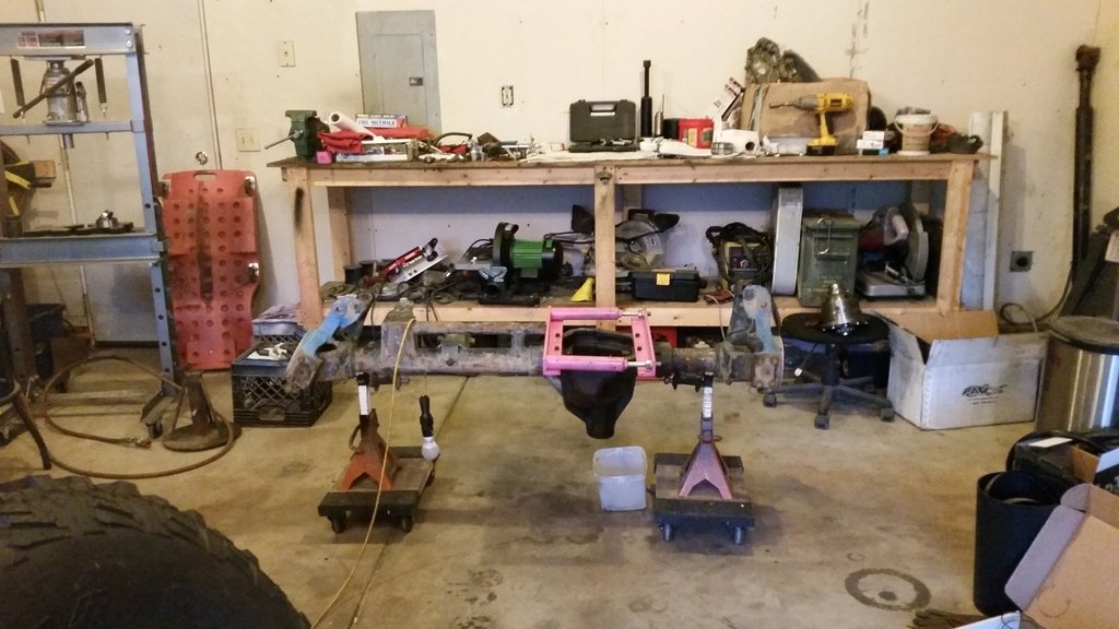

    Garsha91 came down a few weekends ago for his long awaited 63 swap. Never tackled this before other than mine, so getting it done in the time "alotted" meant we had to stay busy. Oh and did I mention this is a 2015! And true to form, I took next to zero pictures, maybe he will chime in with some more. Here's where we ended up after friday night:
    And here's where we ended after saturday night, lol
    He did come back on his way to the Badlands last weekend and got some bumpstops sorted out too :thumbsup:

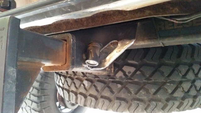

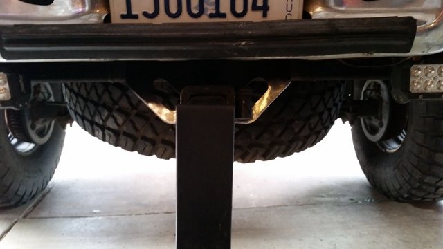

    Also had a local kid come with his Chevy that had broken and bent/mangled safety chain loops on the hitch. I backed them up with a 5lb sledge and worked them with a 3 lb ball pein hammer back into shape. Took a slice out of the broken one (metal stretched) and welded it up. Again my picture skills are lacking, here's the finished product:

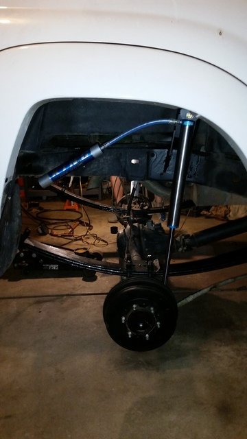

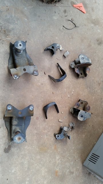

    Well. For those of you who DONT know. I went to @NwiTACO house this past Friday and Saturday for the Chevy 63 swap
    Disassembly began as soon as I got there. Yes. I know. Green. Move on.
    Here's the old leafs
    Everything is off
    Protecting everything important
    Got everything set up and organized because mark was cutting and I needed to keep myself busy
    Plasma cutting old shock mounts
    Started to clean everything up while he worked on the other side
    Cut off the lower shock mounts
    Saturday morning started fabbing the kits from BAMF and ruffstuff
    Finally painted them black because I didn't like the green or how they looked beforehand
    Fabbing the hanger mounts
    Making sure we lines everything up correctly
    Now time to mark where hangers and mounts are going to go
    Tack welded the front mount
    Tacked the hanger mounts
    Finished welding the front mount
    For those unaware these are plug welds. We did this right next to the gas tank so we didn't have to take it off or worry about it catching on fire
    Engineers painting rack
    Shock relocation mount all welded and painted
    Almost done. King shocks in
    Day time with everything back together
    Bonerific
