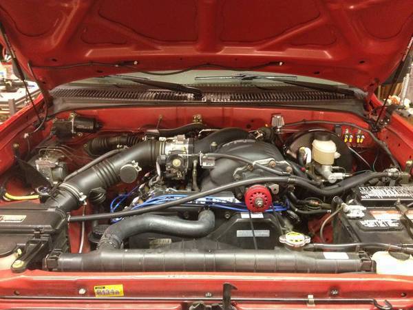

    supercharger is freshly rebuilt (bearings/seals) and sitting on my workbench, ready for installing. 7th injector kit and 2.2" pulley set to be delivered tomorrow. it's like christmas up in here!

    supercharger installed! did a test fire and short run around the neighborhood. seems legit! :)
    7th injector kit to be delivered and (hopefully) installed tomorrow as well as a-pillar boost gauge.
