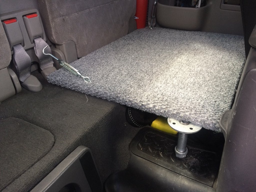

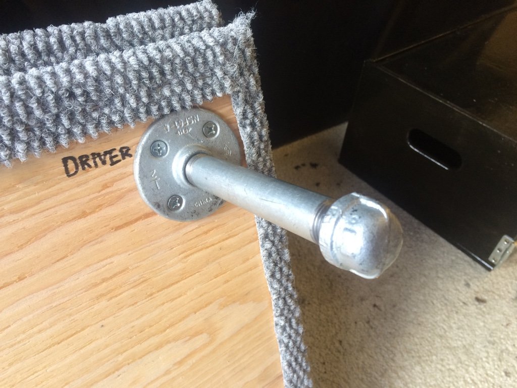

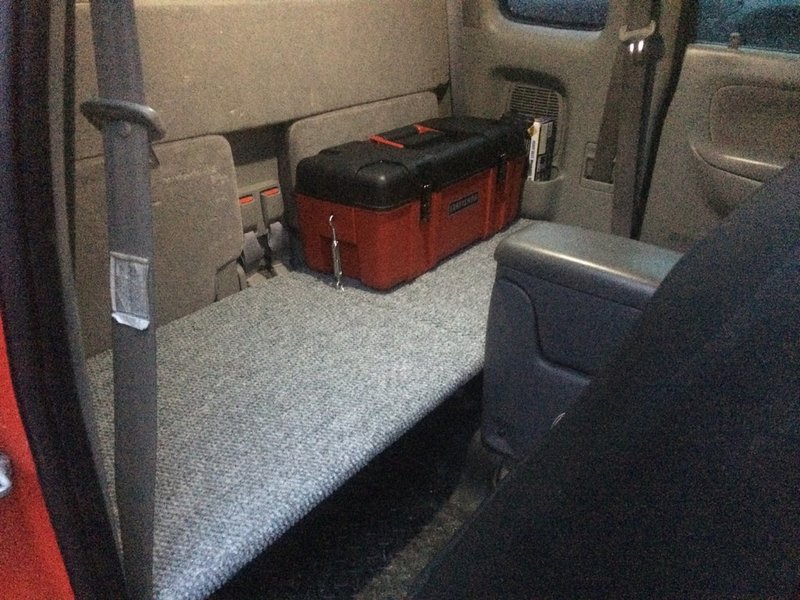

    Rebuilt my rear seat platform yesterday afternoon. It was just on the passenger side, but I wanted to go full-width since I never carry passengers back there anyways.
    Version 2.0 is split down the middle and has three front supports to hold the weight. Used 3/4" plywood and then indoor/outdoor carpet rolled over the edge and stapled. Each side is 25 1/2" x 20". That allows enough space for the carpet, etc. It's a snug fit, but not too tight. Each support leg is made from pre-threaded galvanized steel pipe, a 1/2" floor flange and a 1/2" cap. Just find the correct length for the pre-threaded rod for the height you want. The middle support flange spans both halves but is only attached to the driver's side so the passenger side can easily be removed. I'm more in-and-out of the passenger side compartments so it made sense for me to make the passenger side the first one to be removed. YMMV.
    A couple light-duty U-bolts threaded through the plywood serve as my anchors for the turnbuckles.
    Total cost was $80 (I had to buy a full sheet of 3/4" plywood). Not bad
