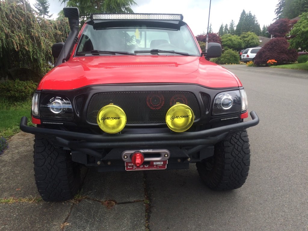

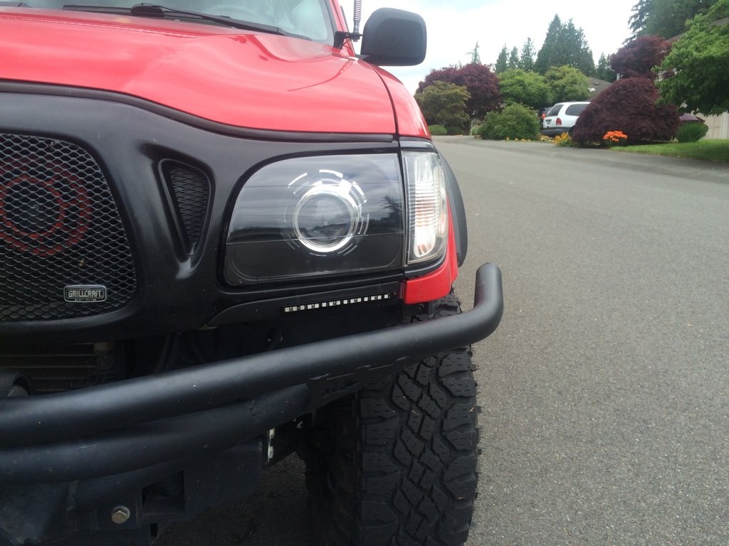

    Big day today. Installed LSC15 retrofits and removed ABS pump and re-plumbed my entire brake system. Removed the ABS to make room over the passenger fender for a second battery. Domino mods haha!
