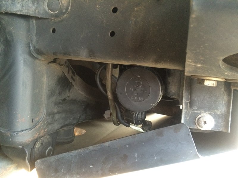

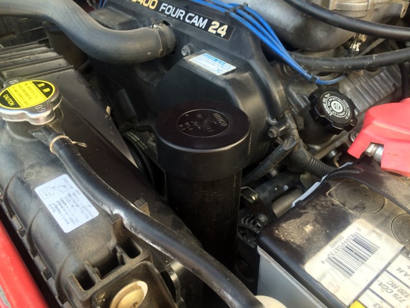

    Windshield washer reservoir relocate complete! I've calculated the final volume to be just over a half gallon... Not bad. I had a lot more space on the driver's side so that's where I had the "filler neck" come up. Drilled a small hole in the cap to prevent the pump from pulling against a vacuum. The reservoir is an "L" shape and the OEM pump is installed in the far end on the passenger side.

    What are you gonna do when you have to change your belts? The windshield reservoir will be in the way will it not

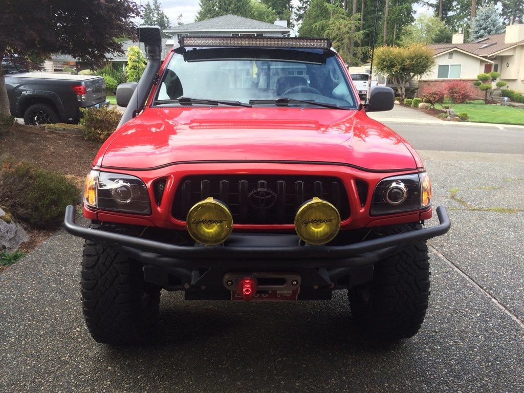

    Front end Friday! New color matched grill painted and installed.
