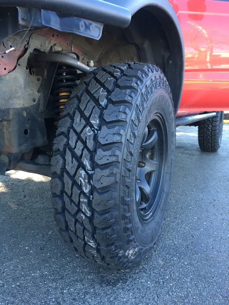

    mmmmmmm virgin tires. :bananadance:
    edit: great blog and IG. Thanks for posting your adventures. :thumbsup:

    Looking through the pages I didn't see if you have done the Tundra brake swap yet. Do you know if those Konigs will clear the swapped rotors/calipers?

    Yep, I've been running the 231mm Tundra calipers/rotors for a couple years now. They clear the 16" Konig Countersteers just fine! :thumbsup:
    EDIT: I actually have a set of 231mm calipers I'm looking to sell if you're interested.

    I love your build though. I think you've convinced me to go with skinny Coopers. :thumbsup: What's the offset on your Konigs, and are you running spacers?

    Thanks, Ryan! Well, I had to get a new compressor, but on a positive note, my AC blows ICE cold now so there's that.
    You'll love the skinny Coopers. I'm a huge fan. I am not running spacers. The back spacing is 4.5".
    I did have to *cough* persuade *cough* the pinch weld areas on the cab to clear up some slight rubbing with my previous 285s (duratracs) but have not experienced any additional rubbing/clearance issues going to the 255 ST Maxx's.

    Cool, thanks for the info. I'm running the TRD faux beadlocks which if I'm not mistaken have 4.5 backspaceing also so now I know where I'll be with 255s and no spacers. I'm considering the bora .75 bolt on, but who knows. Yous looks great without any.

    No spacers, the tires sit just inside the OEM fender flares. It looks perfect, in my opinion.
