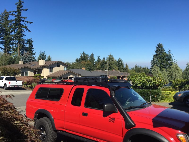

    Bad ass!! I think you are the second first gen to put them on. At least from what I've seen. I just mounted those rifle case boxes on mine today!

    I know of two others at least, but there's not many of us.... They look fantastic. Really stoked for the functionality they will provide too.

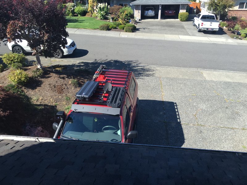

    They do look amazing. How did you mount the treads on there? Thats my next step. Just mounted the boxes today, going to put my treads in between

    I built 2 mounts out of 1" square steel tube (0.0625" wall) @ 12" long. Two holes vertically to hold "maxtrax pin mounts", then 3 holes horizontally to allow 1 1/4" 1/4-20 carriage bolts to pass through from the side of the roof rack crossbars. Painted the assembly with black rustoleum bedliner after drilling the holes and I bought little plastic 1" square caps off Amazon to finish it off.

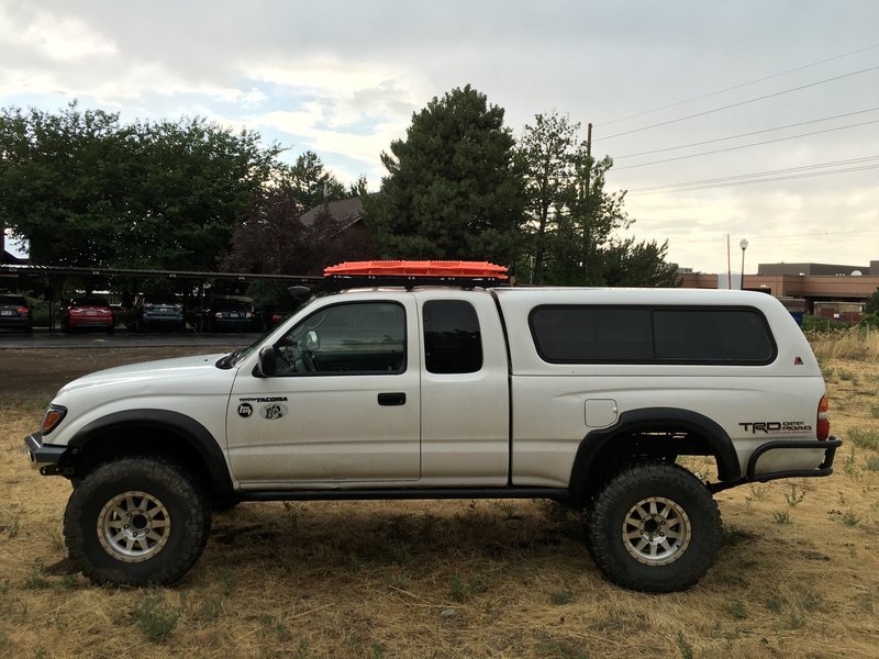

    Not sure of the brand shell actually. It was a craigslist purchase and there's no brand/sticker/serial number anywhere. My best guess is Century just going by similar Google images pictures. :notsure: It's pretty solid though and for the price, I'm super happy with it. The Yakima tracks installed pretty nicely and I've had no leaks at all with just a little bit of silicone dabbed over the holds before dropping the tracks and then over the holes again before dropping the mounting screws down through the roof.
