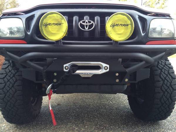

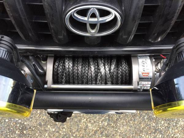

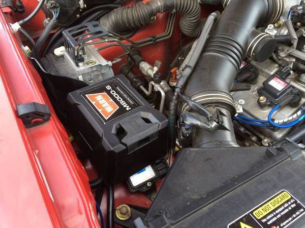

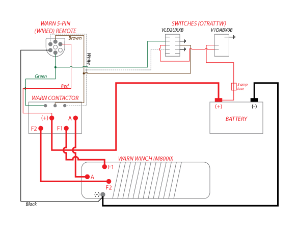

    I recently installed a Warn M8000. Along with that, I relocated the control box to the engine bay for weather and longevity concerns as well as installed some switches in the cab to control the winch (in addition to the Warn wired remote).
    Here's the final product:
  10. Nov 25, 2013 at 1:02 PM
    #30
    davidpick
    davidpick [OP] NWXPDTN
    Jan 21, 2010
    #29760
    2,380
    David
    Leavenworth, WA
    1988 Pickup 22R 5sp 2wd
    Weber 32/36, RV Cam, LCE exhaust headers, Desmogged
    Parts
    12-15 ft of 2-gauge wire
    2 gauge terminals
    2 gauge solder slugs
    ~ 6" of 9/16" heat shrink
    Assorted screws
    Process
    This is pretty straightforward. All we're doing is creating longer cables than the ~16" ones that come with the winch so that we can move the box into the engine bay. The location I choose was 4' away from the winch connections so I used 12' of 2 gauge wire cut into three 4' pieces.
    The solder slugs are awesome. Cut the insulation on your wire so that it can slip into the terminal. Place the terminal in the vice and put 1 appropriately-sized solder slug in the end and heat with a propane torch. Once it melts, keep the heat on and push the wire into the terminal until it seats. Remove heat. Allow to cool and slip on heat shrink and apply heat (I use a simple BBQ lighter) until it contracts, sealing the connection.
    Mount the box as desired and "connect the dots": A on the solenoid goes to A on the winch, F1 to F1 and F2 to F2.
    Easy.
    Next post will discuss wiring up the in-cab controls.

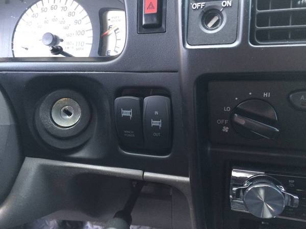

    This part is a little more complicated, but it's not too bad. This is a rough guide and I may forget some steps, so attempt at your own risk. Hope this is helpful though!
    Here's the end result:
    Parts
    Crap-ton of 16- or 18-gauge wire
    Your desired switches
    Female spade connectors (insulated recommended)
    Soldering iron/gun
    Solder
    Heat shrink
    Etc.
    Process
    I used switches from OTRATTW. They look great and are really nice switches. If you're using different switches, you'll have to adjust the wiring appropriately. If you get the same switches as I did, it will wire up as shown above.
    I used THIS SWITCH for the winch power switch (the second In/Out switch has no power until this switch is turned on). I am using the simplest SPST switch. Part number V1D1BN0B.
    For the second switch, use a DPDT (very important) Momentary On Off On switch. I used THIS ONE. Part number VLD2U66B-00000-000. You need the DPDT because the 5-pin-style Warn winches switch the ground for the In/Out functions and we have to do the same with the in-cab winches.
    Notes
    OTRATTW wiring diagrams here: V1D1BX0B and VLD2UXXB (or view all)
    I spliced into my green, white and brown wires by creating a little cut in the insulation and soldering in-line. I prefer solder over a quick connect for longevity, but it accomplishes the same thing. A little electrical tape and a small zip-tie around the solder joint ensures it won't be shorting anything out.
    If, after you wire this up and you winch goes In when you push "Out" and Out when you push "In", simply switch the white and green wire into the switch and it will sort it out.
    You can combine grounds. I created a ground wire that split into 3 so that I grounded the two pins on the second switch and the LED ground on the first switch with the same wire.
    As I said, hopefully this is helpful. Happy to help with any questions...
