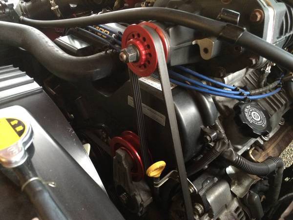

    URD idler pulley installed today. took about 15 minutes. mmmm anodized red....

    Color coordinated with the color of your truck :D

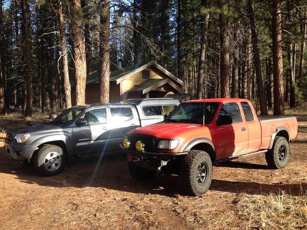

    Had a little adventure weekend down in central Oregon a few days ago. Did some camping, some snowshoeing, exploring, offroading.... good stuff!
    Camping at the cabin on Yamsay Mountain. That's my buddy's new 2014 DCLB Sport Tacoma behind mine. Hell of a truck!

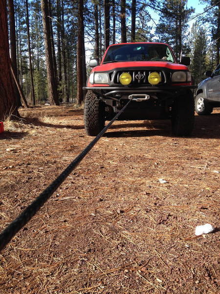

    Getting some winch experience:

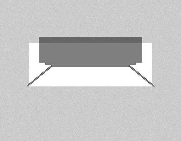

    This is my bedrack design for my soon-to-be-ordered RTT! Planning on fabbing it up Saturday (will post actual pics then). The majority of the bedrack will be 1"x1" steel tube, with the angled legs as 2"x1" rectangle tube. 1.5" angle iron will hold the legs in place and to the bedrails. Should weigh about 55 lbs all said and done, according to my calculations.
    I wish I had and knew how to use a CAD program, but I had to make do with Photoshop haha.
    Any thoughts, comments, criticisms, tips, ideas are more than welcome!
    Bird's-eye view (the white part is the bed space, the dark gray rectangle is the RTT outline):
    Side view from the tailgate looking forward (white area is the top of the bed rails to the top of the Cab):

    Looks like a well thought out plan. I think it is a good idea to keep the top of the RTT out of the wind. Mine is pretty close to what you are planning and I found the aero and mpgs were not negatively impacted. And there is still plenty of room for storage below the rack. Can't wait to see it in action.
    Which tent are you planning on getting?

    Thanks! Yeah, the tent will only stick up about 2-3 inches above the cab... I'm trying to balance the wind protection and lower center of gravity while getting the most out of having it up and out of the way for bed storage.
    I'm looking at the CVT Mt. Bachelor or Tepui Kukenam (Ruggedized). Most likely it'll be the CVT though since I have friends in Bend and can use it as a good excuse to head down and see them while picking it up. Plus it sounds like the discount will likely be better with the CVT (if last year was any indication).

    IIRC, the bottom of my bed rack (1.5" tubing) is 12" above the bed rails. This puts the top of the RTT about 3" higher than the cab.
