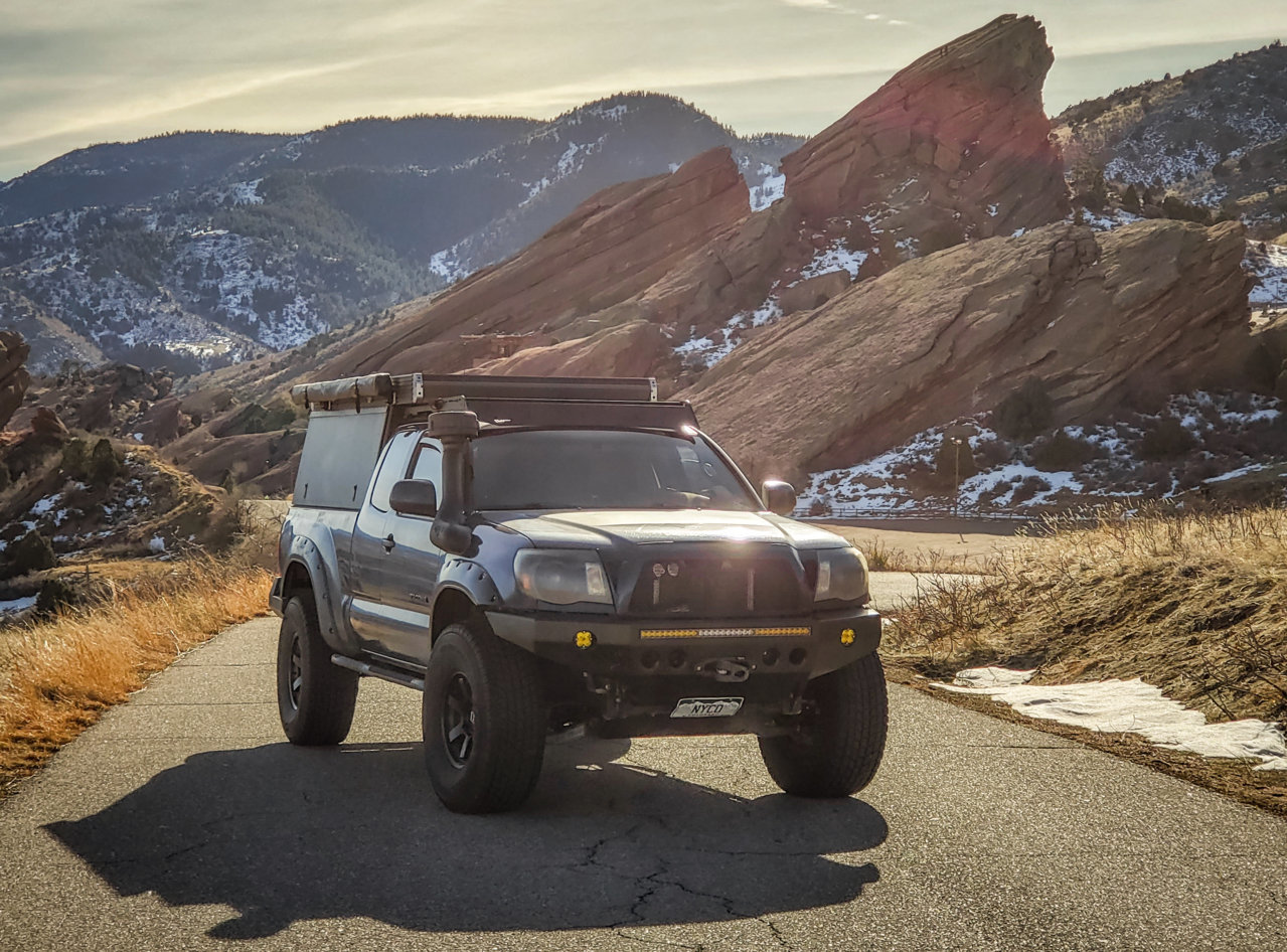

    2006 TRD Off-Road 4.0L V6 - "Blue Betty"
    Mods:
    Engine & Performance
    . -TRD Supercharger
    . -URD 2.85" Stealth pulley
    . -Airflow Snorkel w/ AFE Pro Dry S
    . - Enginaire 4-150/465
    . -URD MAF Sensor Calibrator
    . -Doug Thorley long-tube headers
    . -Exhaust re-route
    . -18" resonator
    . -Magnaflow cat-back exhaust
    . -TRD short throw
    . -Marlin Crawler 4.7 TacoSupreme
    . -RockSolidToys FJ Case
    . -4.56 front and rear gears (nitro front & rear)
    . -ARB RD 111 front locker
    . -EBC Stage 4
    . -URD Twindisc Clutch and TO Upgrade
    Front suspension
    . -Icon 2.5" Ext Length Coilover w/ CDC and King 14x700 now with CDC resi
    . -Total Chaos stock length race lower control arms
    . -Total Chaos upper control arms
    . -Slee Off-road extended brake lines
    . -Wheelers SuperBumps
    . -Total Chaos spindle gussets
    Rear suspension
    . -BAMF HD Hanger
    . -Icon 2.5 Series w/ CDCV (custom build 11.3" travel, 16.85x28.16) and RXT lower mounts
    . -Deaver U402 EXII leaf pack
    . -All-pro U-bolt flip with Timbren bumps
    Shoes
    . -FN Wheels Five-Star 16x8
    . . -TRD Center Cap Mod
    . -Interco Trxus MT 35x12.5
    Armor
    . - InSain Fab Aluminum Front Bumper with Comeup 9.5 Seal and Factor 55 Flatlink E
    . -Sawtooth Kickout Sliders
    . -Pelfreybilt full aluminum skid set, IFS, Mid, TCase and Gas
    . -CBI Bushmaster 2.0 (no longer with swingout)
    . -InSain Fab Bed Rack with Canvas Wrap
    . -InSain Fab Tire Gate
    Lighting & Electrical
    . -Anti-Dark under hood lighting system
    . -Piranha Dual Battery Management System, kit by Outback Proven
    . -1/0 upgrade and blue sea relocation
    . -250A HO Alternator
    . -Morimoto HID retro-fit w/ Philips D2S 4300K and Denso Ballasts
    . -40" Heretic Studios Lite Series
    . -Baja Designs Stealth 30" bar and Baja Designs Squadron Fogs
    . -CBI hood mounts with 2x2 LED pods
    . -LED rocklights
    . -2012 lower dash with OTRATTW Switches
    . -Flyzeye Designs AWA SILVER V2W
    . -AEM wideband and boost gauges on a Flexpod mount
    Audio
    . -JVC KW-AVX740
    . -Polk Audio 6 1/2" component speakers (front) 6 1/2" 2-way (rear)
    . -Kicker CX300.4 amp
    Others
    . -PrInSu Designs Acessrac with 40" Heretic Studios Lite Series and two Plano 108364 and Maxtrax mounted
    . -CVT Mt Rainier RTT
    . -CVT 55 awning
    . -2Way Air System by Rock Smasher Engineering
    . -Viair ADA Heavy Duty
    . -Midland 75 CB hardwired (hidden cb mounts)
    . -BAMF CB Antenna Mount (driver-side tailgate)
    . -Firestik Firefly 4'
    . -Diff breather mod
    . -Relocate 7-pin
    . -invisible sway bar
    . -Ultra-Gauge
    . -locker anytime mod
    . -Sockmonkey'd
    . -hood blackout by Crawlorado
    . -tinted taillights
    . -one piece custom driveshaft (now used as spare)
    . -clearanced bushwackers
    . -Homertaco grill

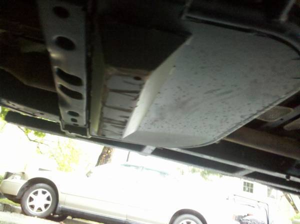

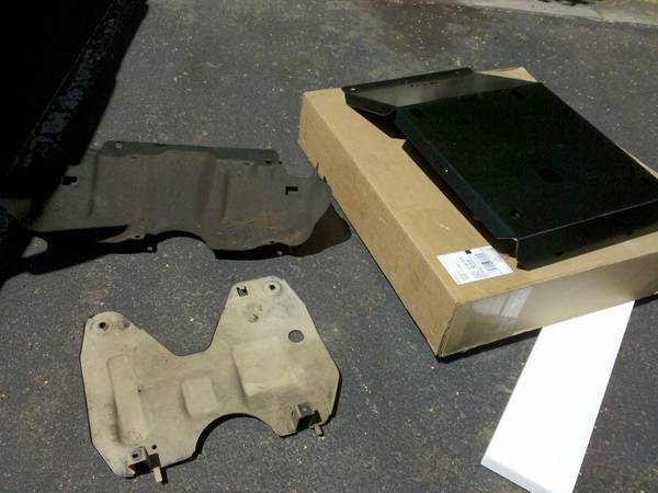

    so far bull proof...i used them a lot, and mean A LOT over the weekend
    the tcase skid paid off the most so far due to there not being a suitable skid from the factory protecting the tcase...i'll take some photos of the scraps they encountered in moab
    they mount up very easy too.
    i'd also look into the bud built skids...if i knew that their tcase skids had spacers to go over the exhaust cross-over, i probably would have gone with them. But the all-pros so far have done their job without a problem
    old ifs skid versus all-pro

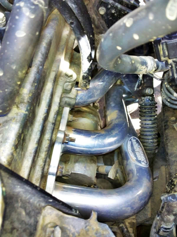

    Whats going on here, middle right side of pic?

    lol NM, thats the steering shaft. I was thinking it was a rear shock sticking up through there. :smack: :cookiemonster:

    Yup its the boot on the steering shaft which when disconnected makes installing the driver side header muuuch easier

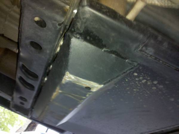

    so this is what i mean that the tcase skid did its job....
    after a weekend in moab
    NOW CHOPPED
