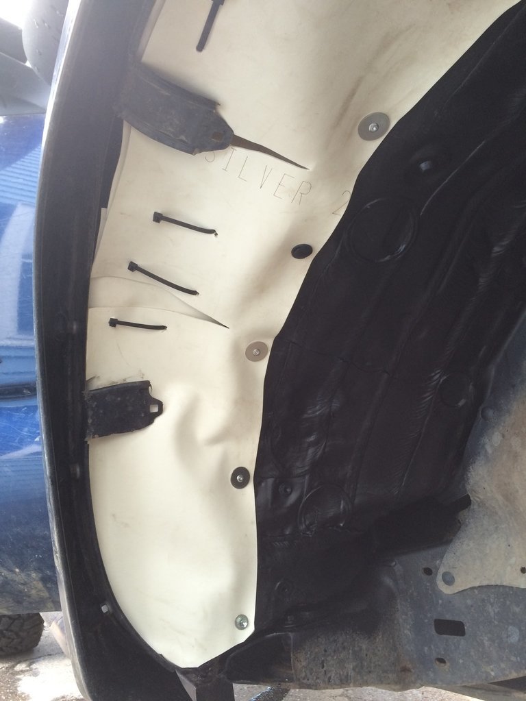

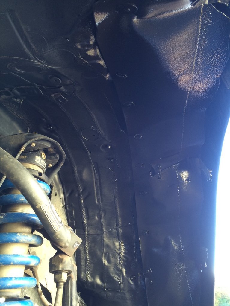

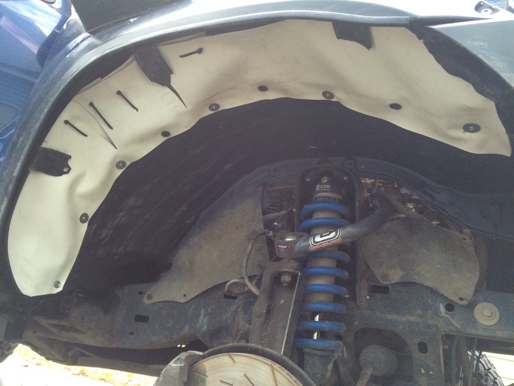

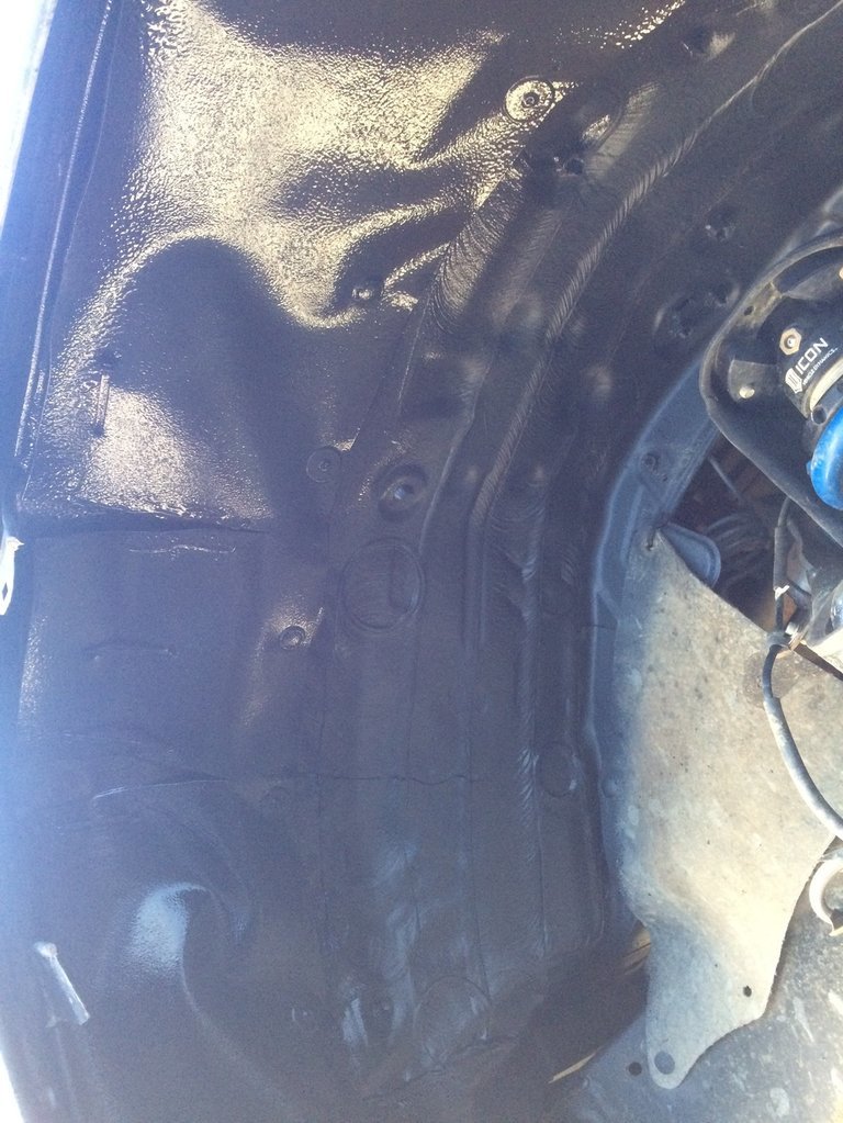

    finally did something about my fender liners....
    picked up a 6x8 roll of vinyl flooring for $25. cut 9"x48" strips. used some plastic fasteners in the factory holes then used some pop rivets to hold the rest up. reused the fold over for the outside to hold things up. had to cut some reliefs and make extensions around the curve. then coated with undercoating.
    note: make sure you add rtv to the hole after drilling and before getting the rivet in

    not perfect but for version 1, not a bad solution. :cheers:
