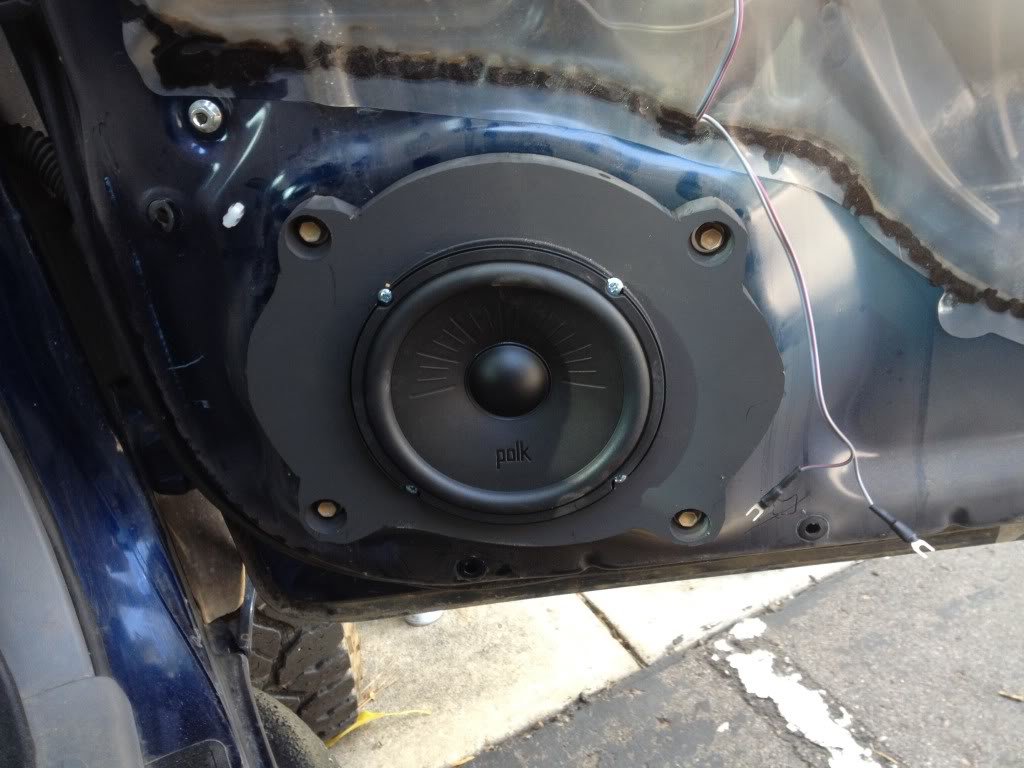

    Audio upgrade:
    Front-Polk Audio - 6-1/2" Component Speakers with Polymer-/Mica-Composite Cones
    Rear-Polk Audio - 6-1/2" Coaxial Vehicle Speakers with Bilaminate Polymer-Composite Cones
    Additional items:
    3/4" MDF for front 6 1/2" mounts
    #8x3/4" self drilling screws
    1/4" washers
    jig saw
    drill w/ assortment of bits
    assortment of common tools
    new sounds
    to save some $$, i went ahead and picked up some MDF to create my own mounts instead of going through *********.
    prep...take door panels off...see other thread on that

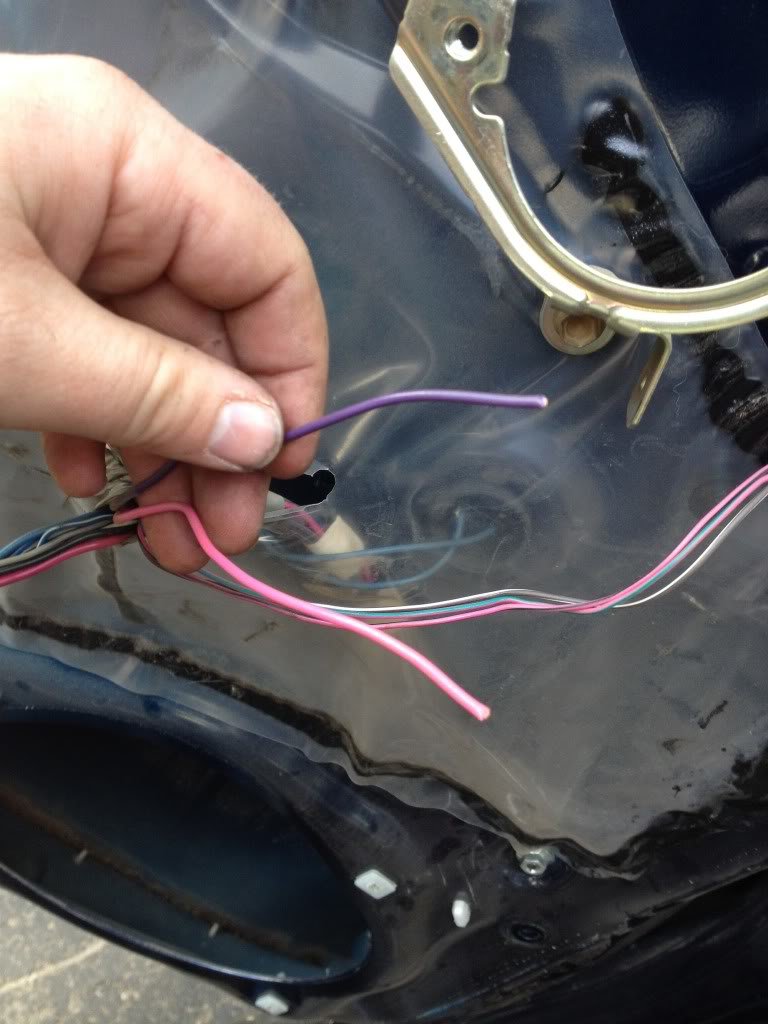

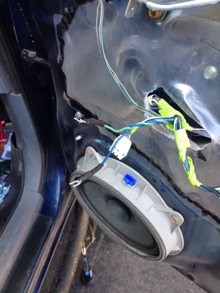

    the stock wiring comes from the stereo to the tweeter where it takes the highs and sends the rest to the woofer. so i just took the wires coming from the stereo and cut them at the first connection closest to the tweeter..
    4949D7D4-02DE-4EF8-9142-744439A2A299-557_23ee92dbe964a2eee3e3bafe9b7f3fef0c1d5e5b.jpg
    threw on some connectors that will go into the crossover
    80B4D223-87FF-44A0-9FD1-D1302239D3D5-557_c8534427cd5120652e42f53da2b2c6f8d3f0c0e8.jpg

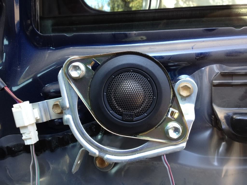

    for the tweeters i re-used the factory mounts...require you to cut out the old tweeter. you will not save the factory tweeter so it will get messed up in this process :laugh: the main fabric of the tweeter can be cut with some extra fabric left that will give the new tweeters a tight place to rest in. using some rtv i put some adhesive around the old fabric and slid the new tweeter into the hole i created.
    58B80350-73F3-4859-B8F7-A7A279E0EF77-557_2a86b056d2a2b5a2b0247027d3adac4c126a34b8.jpg
    and i just noticed that i put that tweeter mount in upside down :D the tabs go into slots which i didn't notice apparently until the second door install. oops
    so next step is to get the woofers installed..

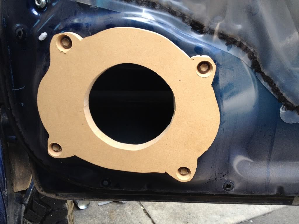

    take the stock mounts/speakers and trace out on the MDF the outline. using the mounts provided with the speakers, trace out the cutout needed for the speakers. and cut...you now have mounts :D
    i used a step down bit to create enough of a countersink to re-use the factory bolts used to secure the mounts. used 1/4" washers on the bolts in securing the mounts.
    test fit
    DFE857A1-A3E9-46F4-B6A5-5E0BB5A0A1EE-557_ca05cbd80f02ce3ae5d070abbeac5d86caf3b082.jpg
    then threw a bit of flat on the mounts so it'll be less noticed behind the door panel. using the self tapping screws i mounted the speakers.
    F1529911-3EEF-4D7A-82ED-83111DCB6096-557_da905f951b87fe5b38c5f4a75ea9559c041dada2.jpg

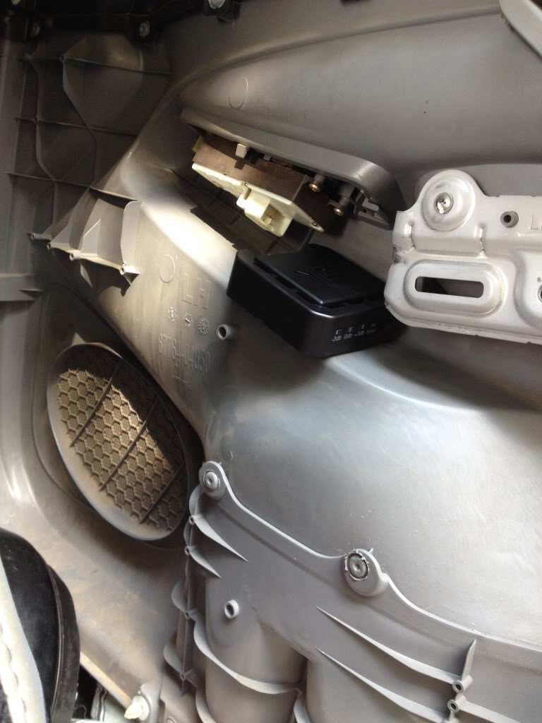

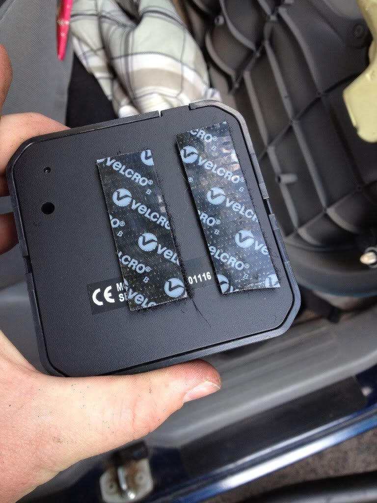

    to mount the crossover i threw some velcro on the back and mounted it to the backside of the panel
    6B83BC0E-ED1A-4CD1-961A-8372F77B534D-557_f3f4b0351910220c4ce28a0364edf452a5917b40.jpg
    this allows me to take the crossover off easily when taking off the panel
    82C85903-EA4F-4642-86FF-A32ACA11BB1D-557_a6348483aa77532961e1f991bbcec6243f4b1c8d.jpg

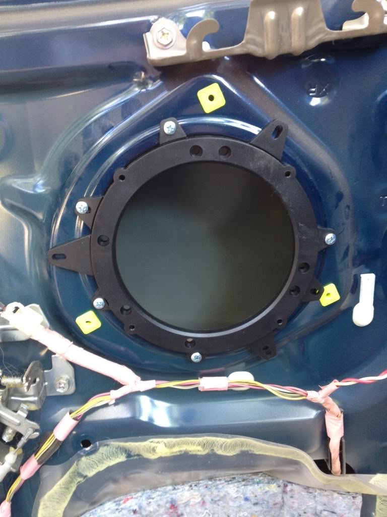

    for the rears i was able to mount the speakers using the mounts provided by Polk using some more self tapping screws
    19116450-357E-4AAF-9E6A-5BA61229F474-557_9d81c62d91302c57f7416775426735dc8a02530f.jpg
    used wire harnesses from best buy for the wire connections
    A4AEB727-B070-4D60-BF2B-98FAD9B29970-557_62fe498eb18aea7449105ab7300d512d60dc2588.jpg
