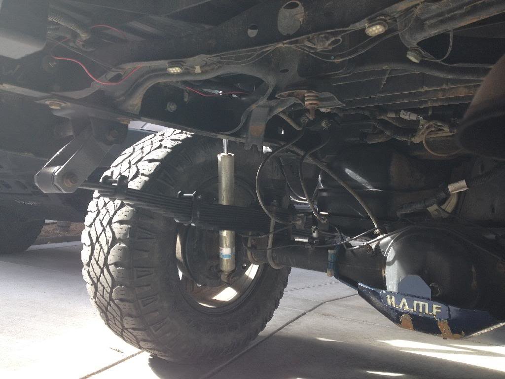

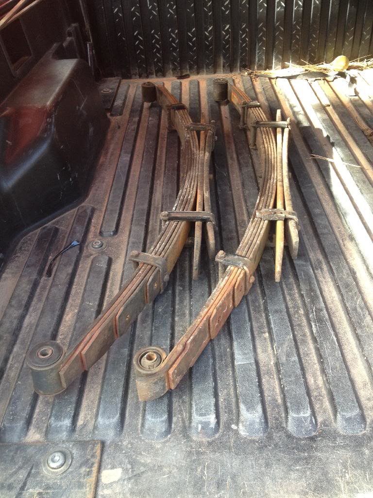

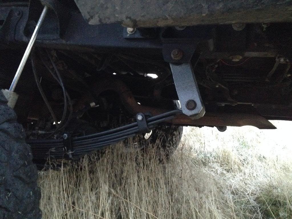

    part 1 of this year's overhaul...
    out with the old
    FE562178-C454-4049-B5B2-286C547DC782_zps_cccca208527112d5b9619824c66506f50e546df6.jpg

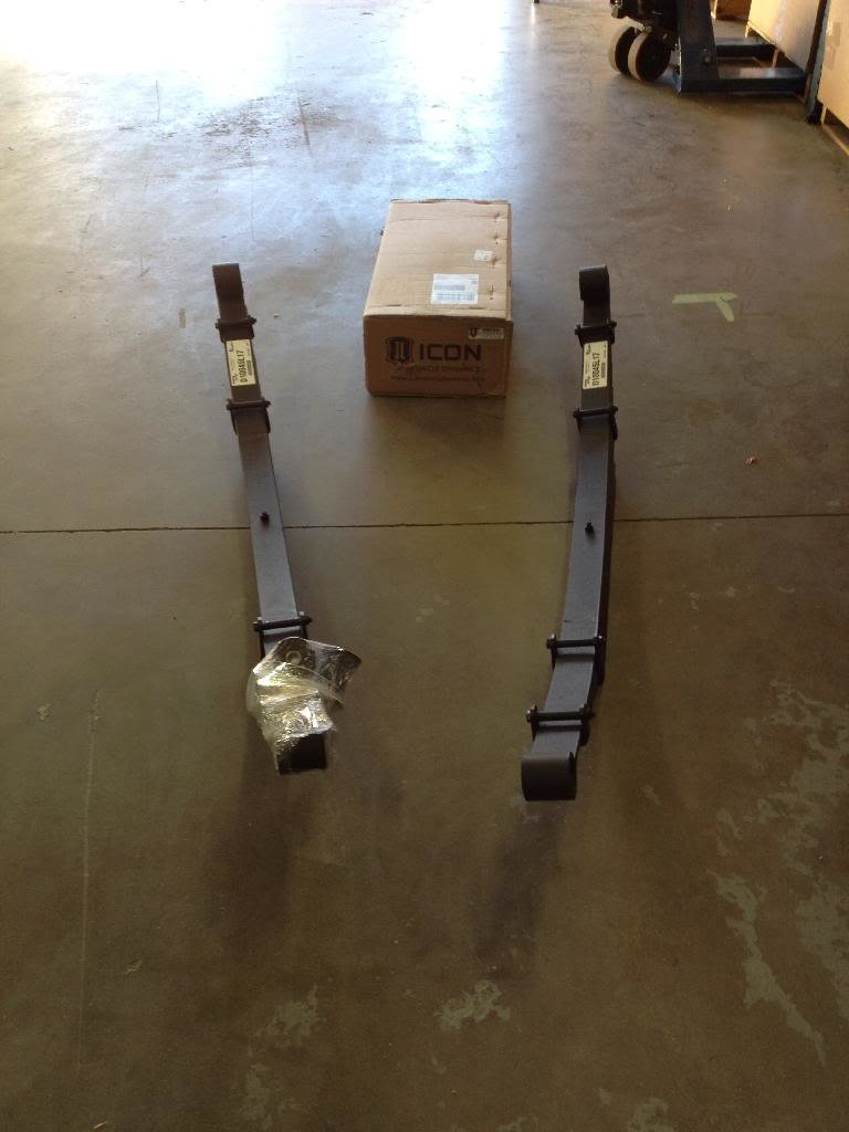

    in with the new
    FA1F36AD-5ABA-45DF-84C4-DD3EB3EB115A_zps_d690193c52150b64e8d11b13a19cfc883b1ceb73.jpg
    81BC7A60-2CB1-41FE-A5E8-9D262BD31B85_zps_8df091f9ef5efb9e3a1f4e1448bfc180610d2b5a.jpg

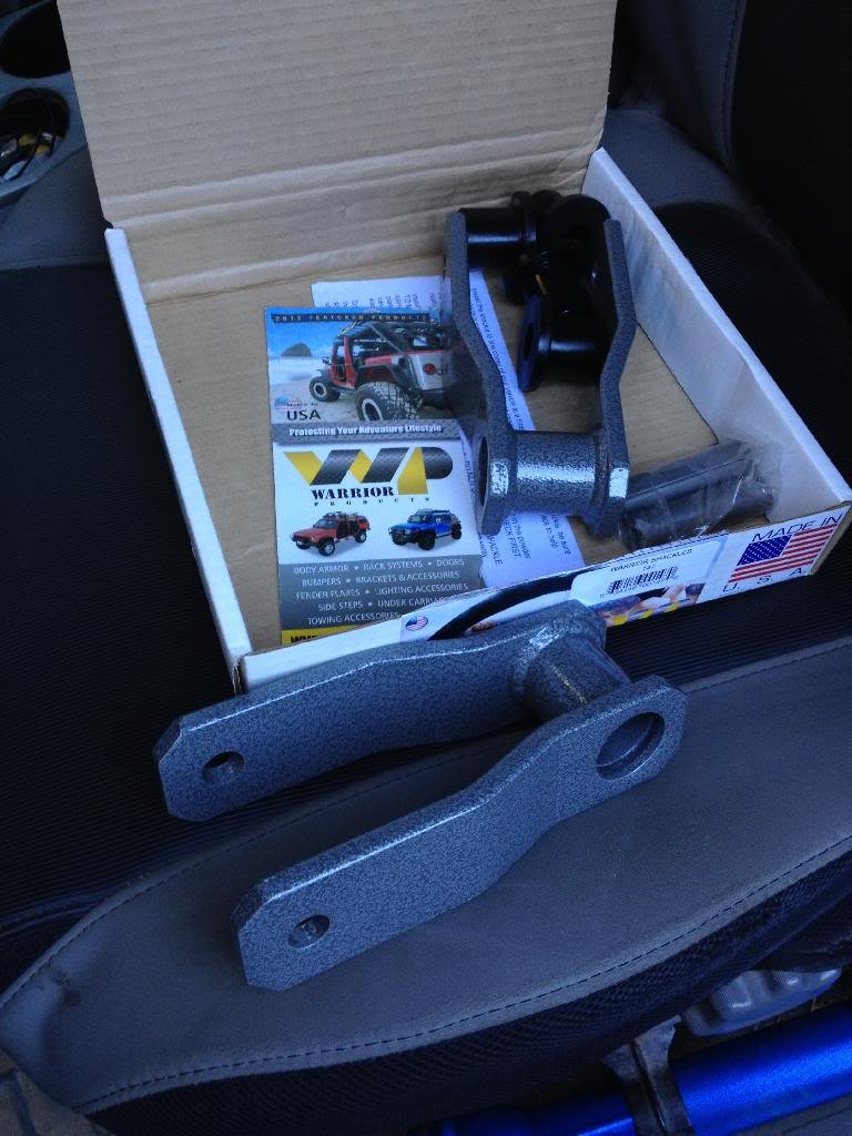

    the Toytec BOSS leafs are a 2" lift leaf pack, http://toyteclifts.3dcartstores.com/NEW-BOSS-05-Tacoma-Leaf-Springs_p_1094.html
    although they offer less lift than the Dakar, the leafs are a tad longer but have less arch...
    so in order to take advantage of the longer leafs and an attempt to keep the ride and travel similar to the Dakar, i found the 1" lift XJ shackles...
    D5058C6B-5335-4963-83FC-00C543F16E32_zps_d2efddcf5565244cacabc51b553754c2fb4cfedf.jpg

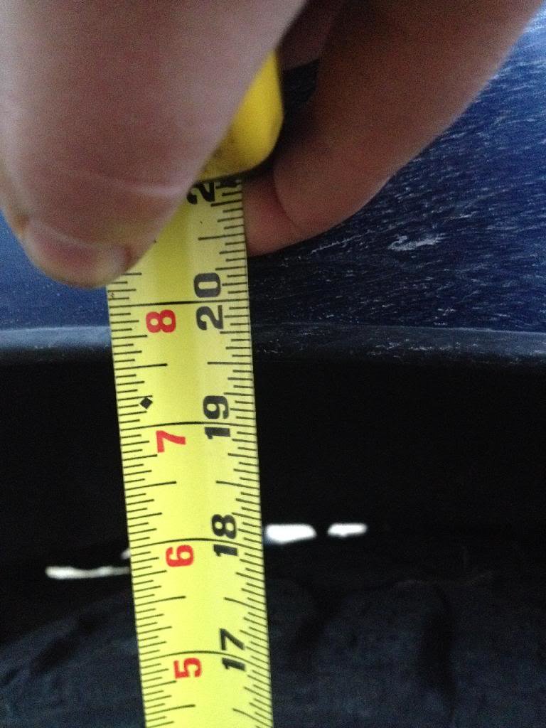

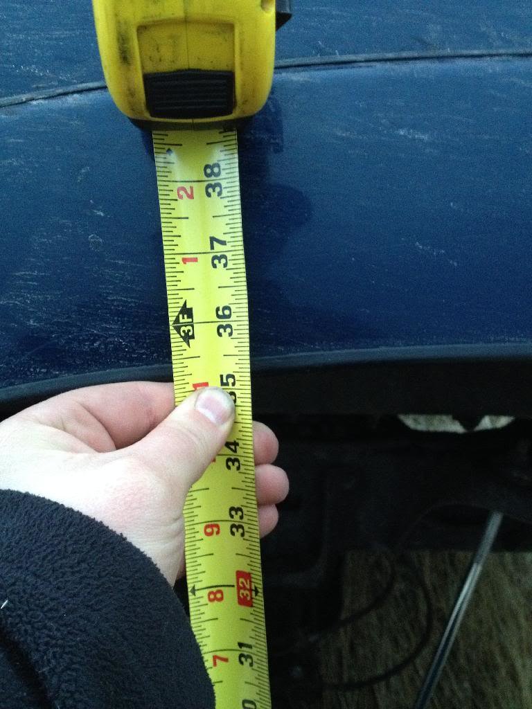

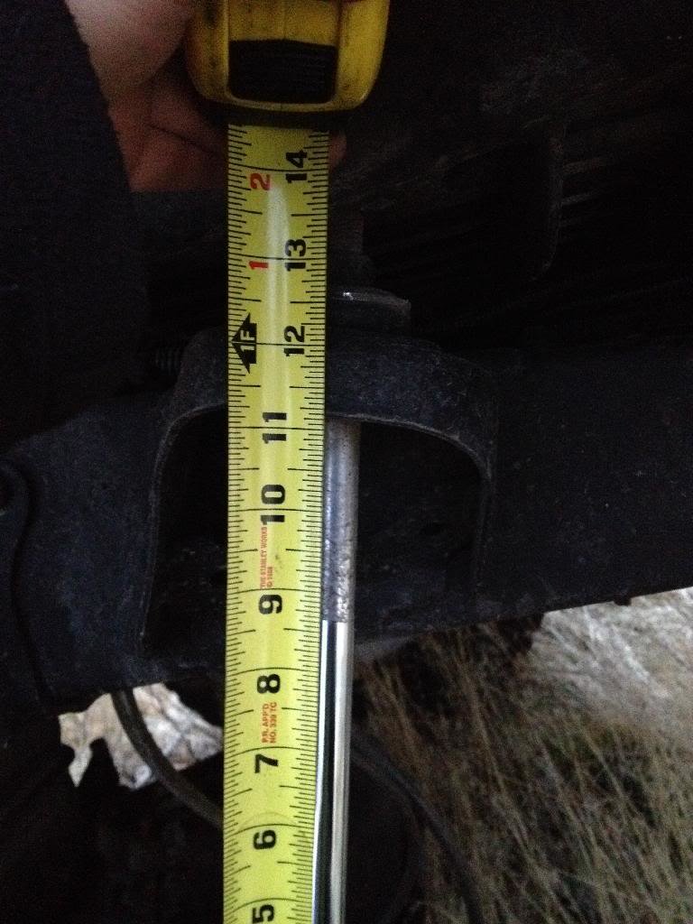

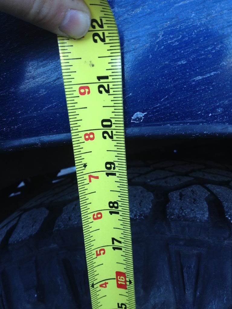

    hub center to fender before
    CAEA63F8-8C45-44D8-948D-4BC1A70DBEAA_zps_32079d41a5aa6331e5988fc6a96c5e58cf56df02.jpg
    ride height before
    584B3269-849E-412B-B902-555EDCE27D8B_zps_0bfbca989df22c167efcb60b75a2b2b8a98208f0.jpg
    droop before
    65C6294E-DDF7-4885-A089-80A6A56D5357_zps_0f9a3bc90f4b1ad7b21d3658f7cbd3e0cfd26a70.jpg
    shock extension before
    ACFB3818-54ED-46FC-9F07-648EFBCAC546_zps_e8308c7b07d9f7f749c92e1cfbee7394254cd2ef.jpg
    compressed before
    09586D0A-631D-4B2F-80BF-DE6208D4F34A_zps_2dc9a31d5447dd74e3dd4adfafb4c6f51bdbb909.jpg
    shock on that compression
    79437EE8-9584-4AA0-93E6-262B1CC19503_zps_d9904d9a8e2a88fdeeec12a87efdb0f2a52caee5.jpg

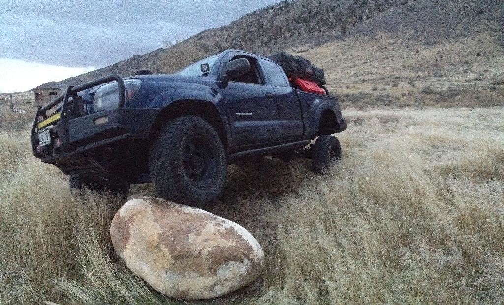

    didn't get a shot on my phone showing the truck but it was driver side driving up a steep bank til the driver rear lifted..

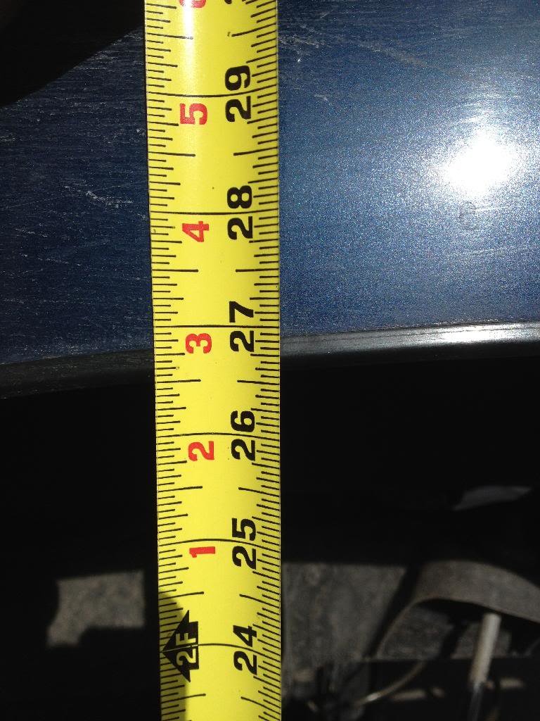

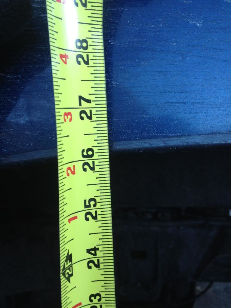

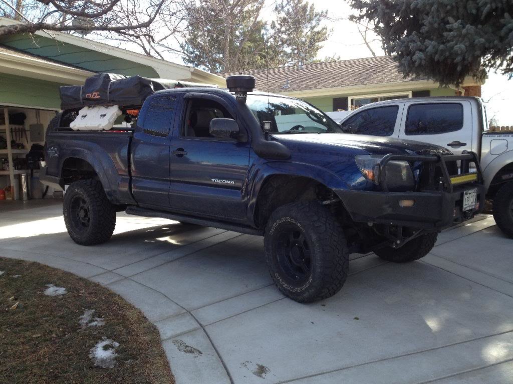

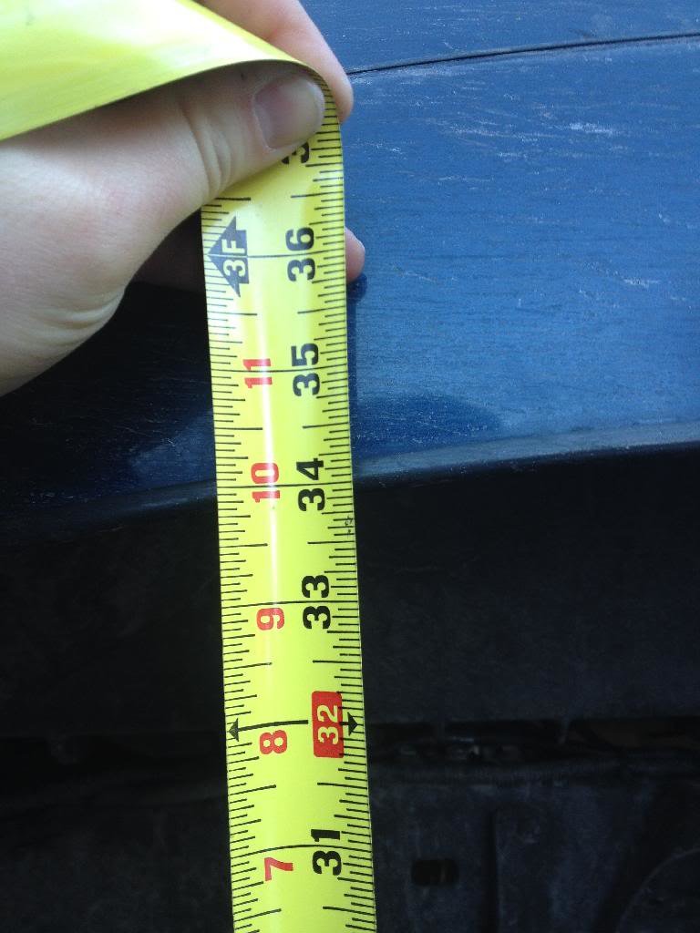

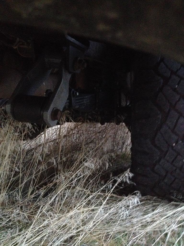

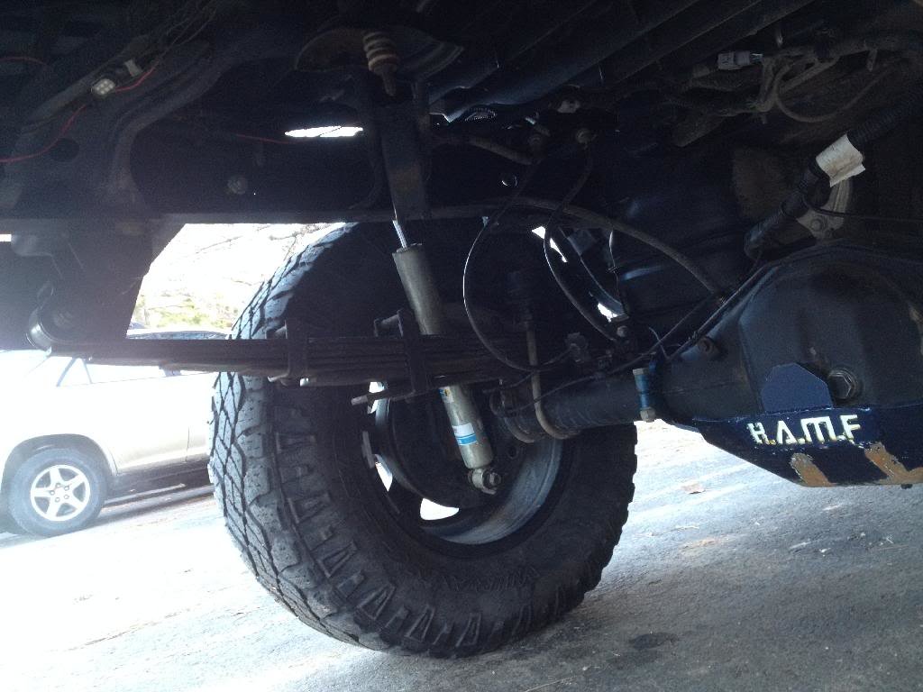

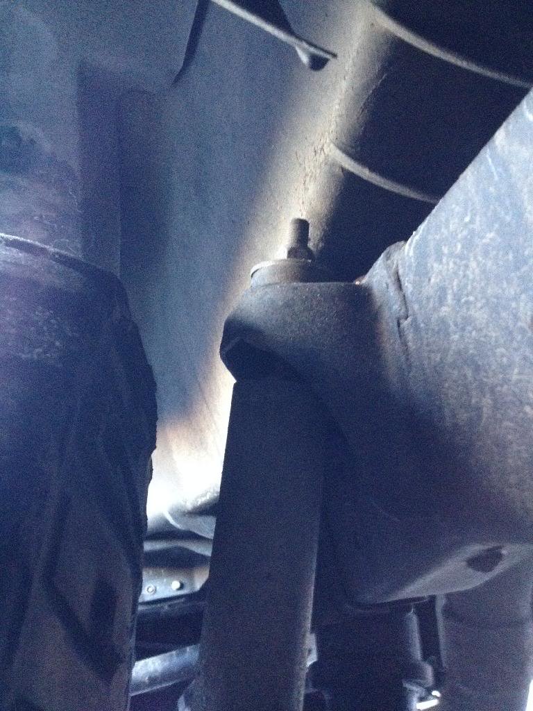

    new ride height
    A1171707-44A6-44B6-9942-BE2BAC2852A8_zps_455517a5e2b65c8bc64bdeb38c05efec9219562c.jpg
    103B8D98-6138-4F25-B89D-F4E40723EAEB_zps_59df50dd9884c77ff3c9a4e183d19a6e9b944dad.jpg
    A38544B0-C8E7-4175-8837-2DA33946164A_zps_6f9097463744eef3d8d710693395cb91c85d3fad.jpg

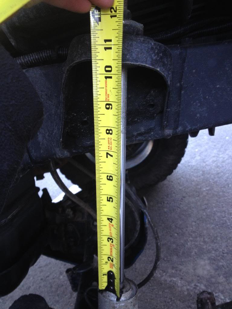

    new droop
    942C9973-DD3C-4D95-9798-01F42ADA6A11_zps_5cf76dc0c2d0429ac8dfbbef74fb729c54c90b8e.jpg
    shock extension
    2808E1C9-E7DE-4B84-A3ED-26676C2555A1_zps_5311ec4ba22b7f90bb95ed786ece683cebce9c89.jpg
    droop
    EF25E84F-24F5-41C1-B72C-5CE513C344D9_zps_cf06ff40c5a5db33b45c13c3b252b2590566abd5.jpg
    compressed
    97452061-52BE-4BD7-9BD9-E5A982E1D78D_zps_79e1be04ca88261647c14cfc62485f68f83482f4.jpg
    7CD17CA7-7F1C-4455-A8CF-83DE4AD0123B_zps_364c67163c71fa096f1c269341ce7befa3176e4c.jpg
    testing the new setup
    0F4FA9D9-6018-4D9E-BF58-816FF436372C_zps_20b01c5ad703a67fe22af3b2aaa110b92c3f2d8f.jpg
    277D96AB-C194-4191-83A8-AF9A7DB5AB21_zps_1cc4bf190b6887846a3572dd80ca212b04a11a8c.jpg
    7608D45D-F65C-40A2-9F20-3F2FED79F5C8_zps_ce13935ff7cf4c471e250c3529f020a1a155e451.jpg
    D3647AEE-5E09-4BEF-9EAB-7A8BCAAD1674_zps_f45dad5e824c298281dd0784eaa054ce25af99f0.jpg

    Nice. Did you check the droop without the shock? I see you have more droop now so it makes me wonder how close you are to maxing out the shocks
  16. Jan 26, 2014 at 8:18 PM
    #2716
    NYCO
    NYCO [OP] go explore...
    Jul 27, 2010
    #40842
    19,126
    bOb
    Colorado
    Blue Betty - '06 TRD OR
    dents & scratches
    They're maxed out. They are my limiting factor again.

    Limiting straps or shock reloCation and new shocks.
    Seems like it's a never ending battle

    Might also notice the spacer Eric made for me on my brake lines. (Photo with new setup at ride height)
    On full droop my lines were TIGHT!
    SO much better now!
