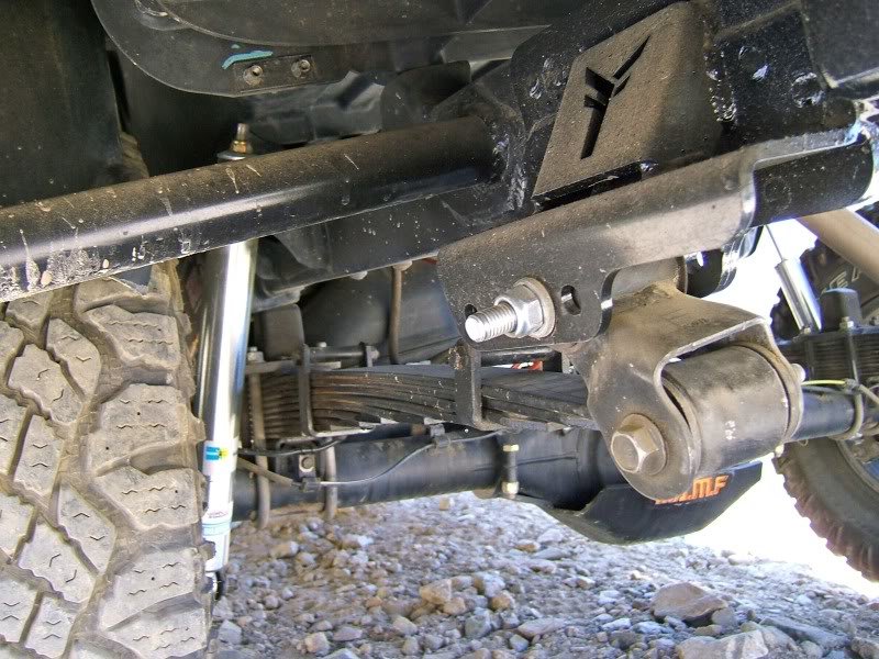

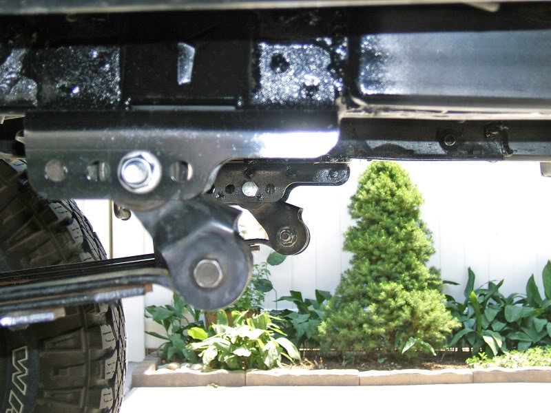

    Something to note on mine though - I am running a different fabricator's design for a shackle flip that took some heat on TW early on. It allows for adjustibility to various lengths of springs and shackles. You do not see this design very much. Below is a pic set up with the factory shackles. I am now running Defined Engineering extended length shackles in same hole. I gained a bit about 1/2" in height. With a longer spring in the future I can move the shackle to gain the desired angle for movement and or adjust the lift a bit.
    There is negative arch for sure but so far the springs don't mind flexing.
