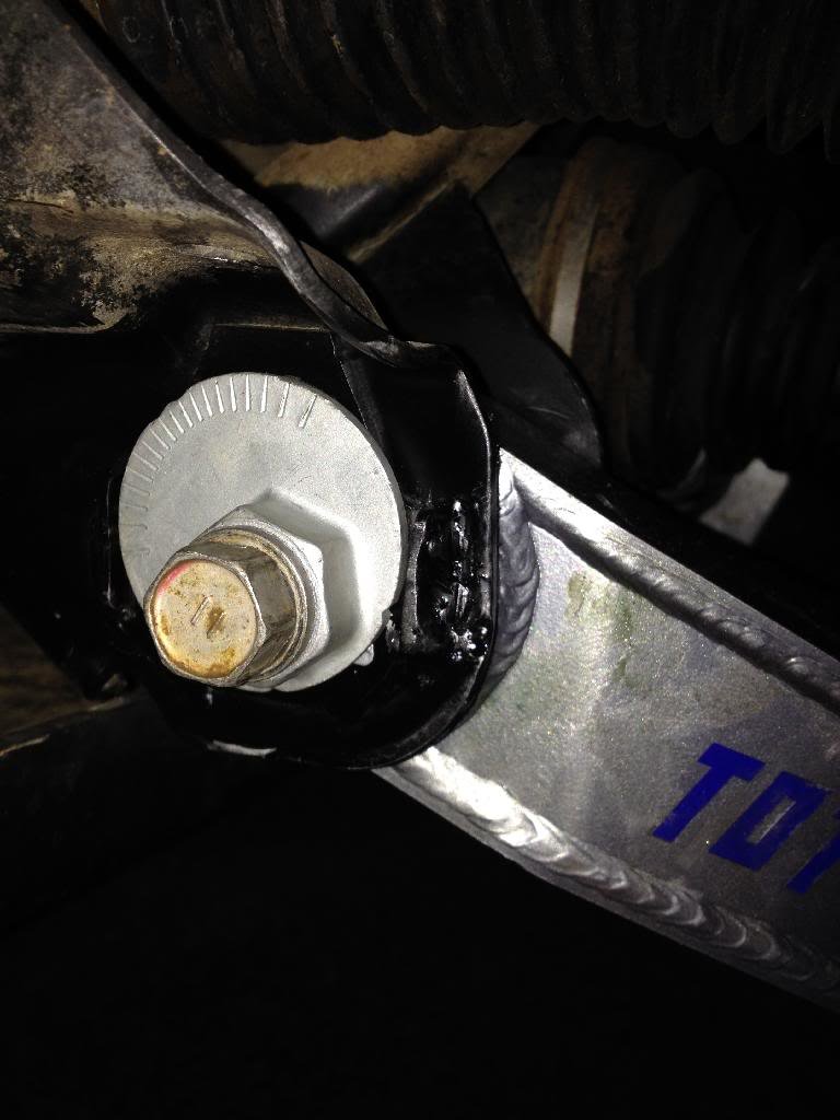

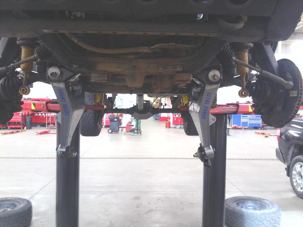

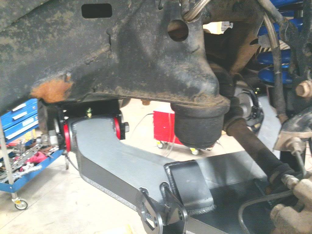

    first impressions are great with the new setup...Jace kicked some ass today and get everything done...
    cut the old LCAs out, install TC lowers, install Icon C/O and adjust (swapped out the springs earlier this week), replace my driver side wheel bearing, then align (MUCH NEEDED!)

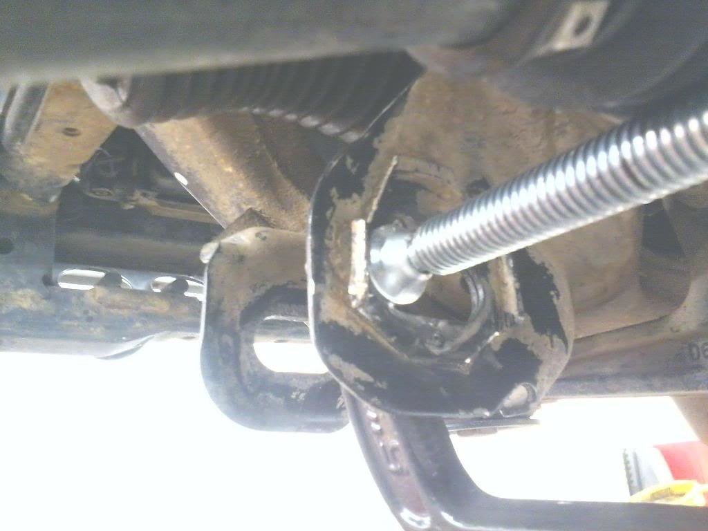

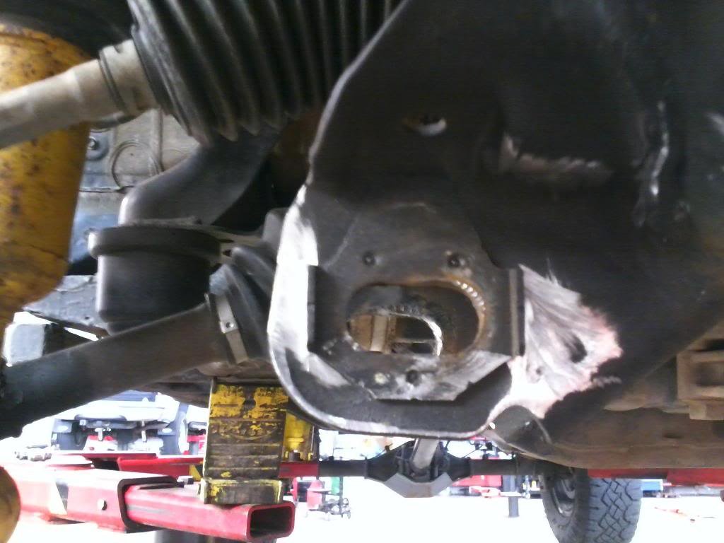

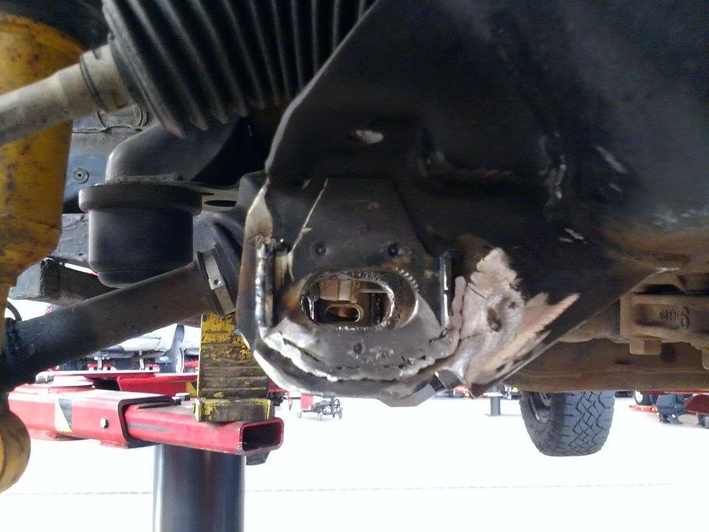

    old LCAs cut out..prepping the cam tabs to be reinforced
    FDFB9A60-1A1E-4ED0-A0E3-6B70939122FC_zps_368cb1243e3fbb68832e40595ec5c3f52c978615.jpg
    threw a bead around them for reinforcements
    47E622F2-06A3-4892-89B7-988577A34F36_zps_b06200db08bc97c75b9313eea98528776774aae1.jpg
    finished tabs
    22490D8E-15EC-456A-AFD0-56484FDEB2E1_zps_1437d50ef6f85d5f80af2430f6730028c970f54c.jpg
    some tabs needed some love to get back to shape
    B5C7D902-F028-41AD-8718-2ACA26FF5611_zps_8e07586911ba3d94d6d10d29e7c9e317d626e5c0.jpg

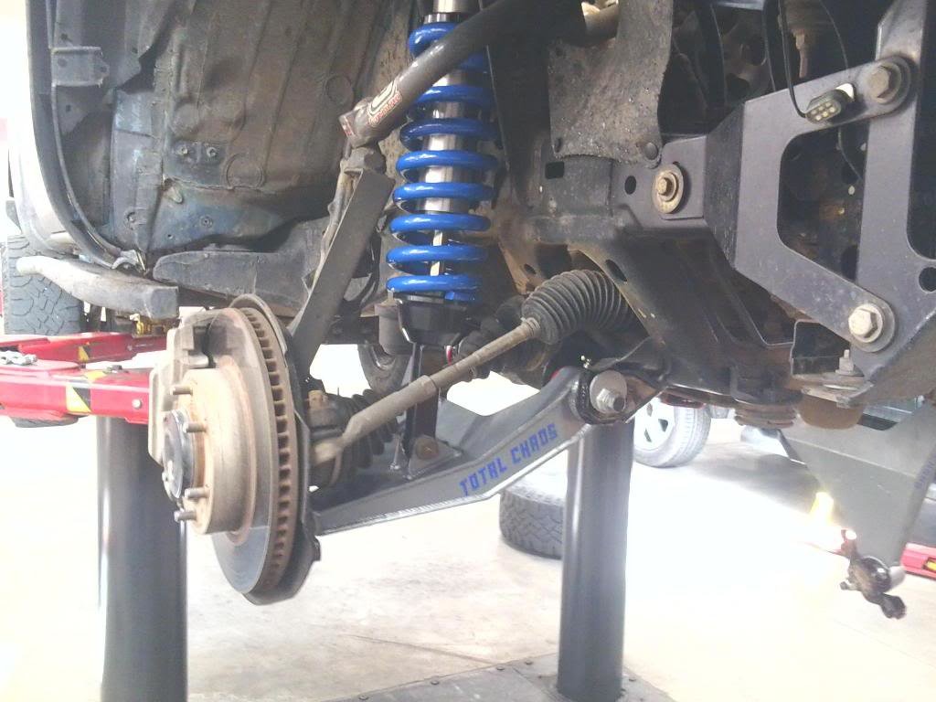

    droopy :D
    0B3C8C8A-1581-4DEA-BCB4-6A28EB7D477C_zps_55eafda00470a25dde115cd4c7333c32b7db4901.jpg

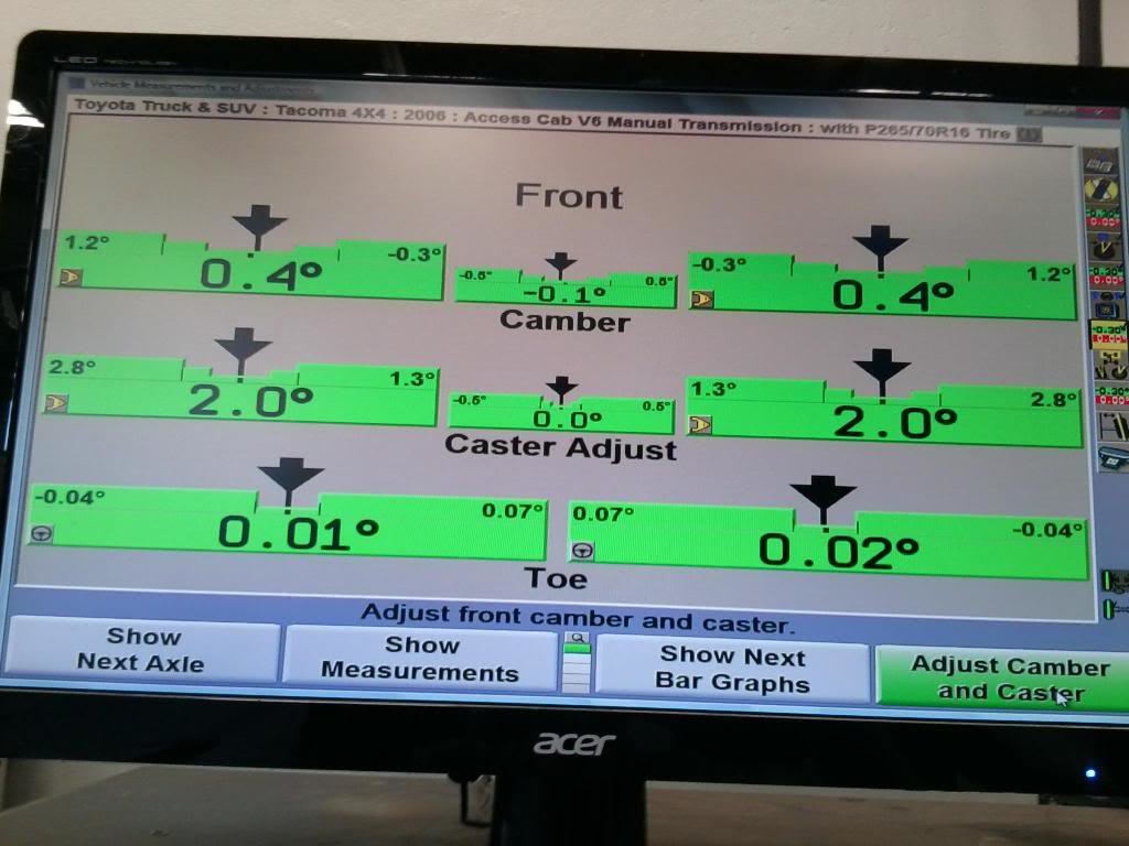

    best alignment this truck has seen in a loooong time :cheers:
    8AE47C0E-21E6-481B-B427-94D9A95B0620_zps_f731ea624c8e2b73cd8ef48c5b5542594376a875.jpg

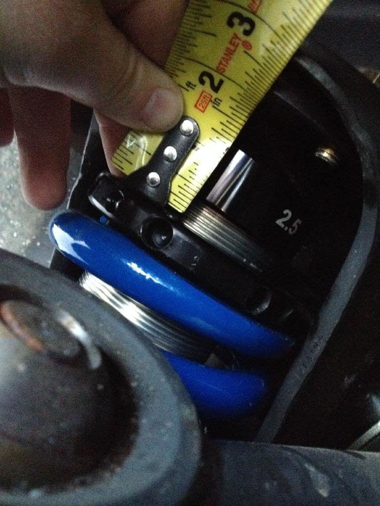

    current threads exposed
    FD10083D-91D8-458B-9021-96E520046591_zps_365a4cf47fffd6f390ce5d3cfde9360c45ef24e2.jpg

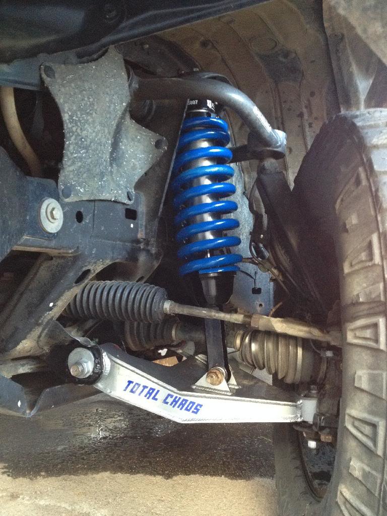

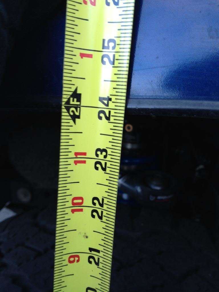

    hub center to fender
    7ECB9A85-7E5F-4080-8B99-30339884C251_zps_1327c5af33b966aea23eb5c9b2e525e67a6fd882.jpg
    :drool:
    4F05E948-32AC-42E7-B379-F8227ADCB339_zps_0ff61ec8205929afccb7747962d986b0c963aa51.jpg

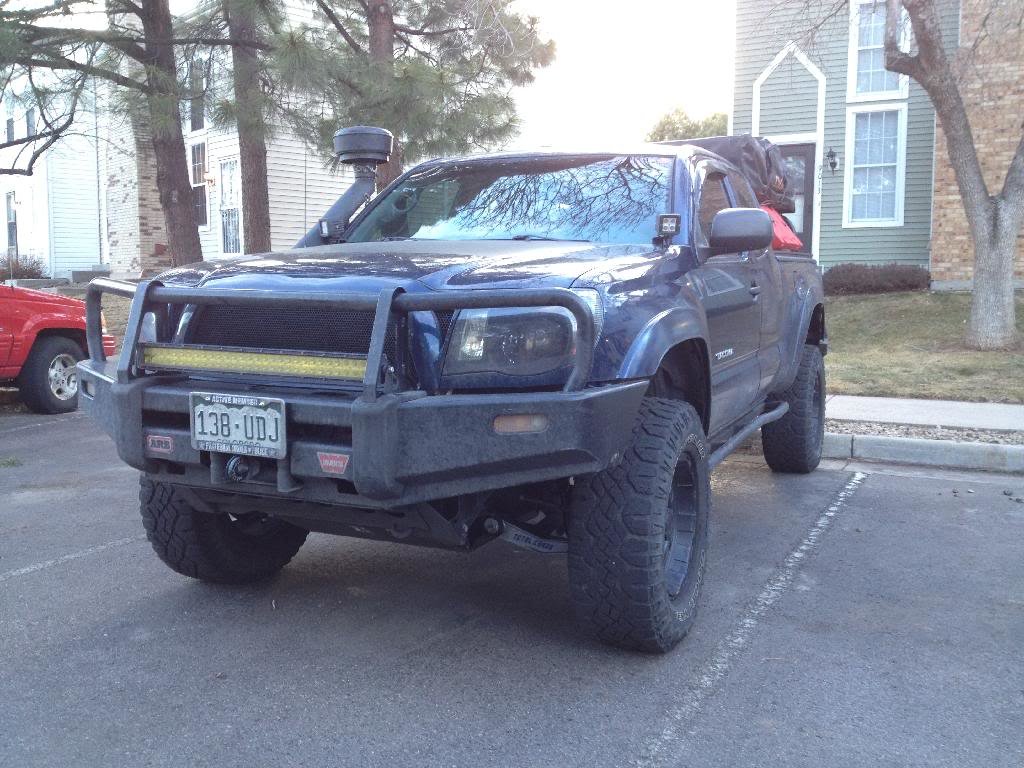

    current ride height
    3735AFD1-5FFF-4C4D-B758-6142BDA33D34_zps_c4f3f9ace60580e5fb6e7ee11174f0e601e55e2c.jpg
