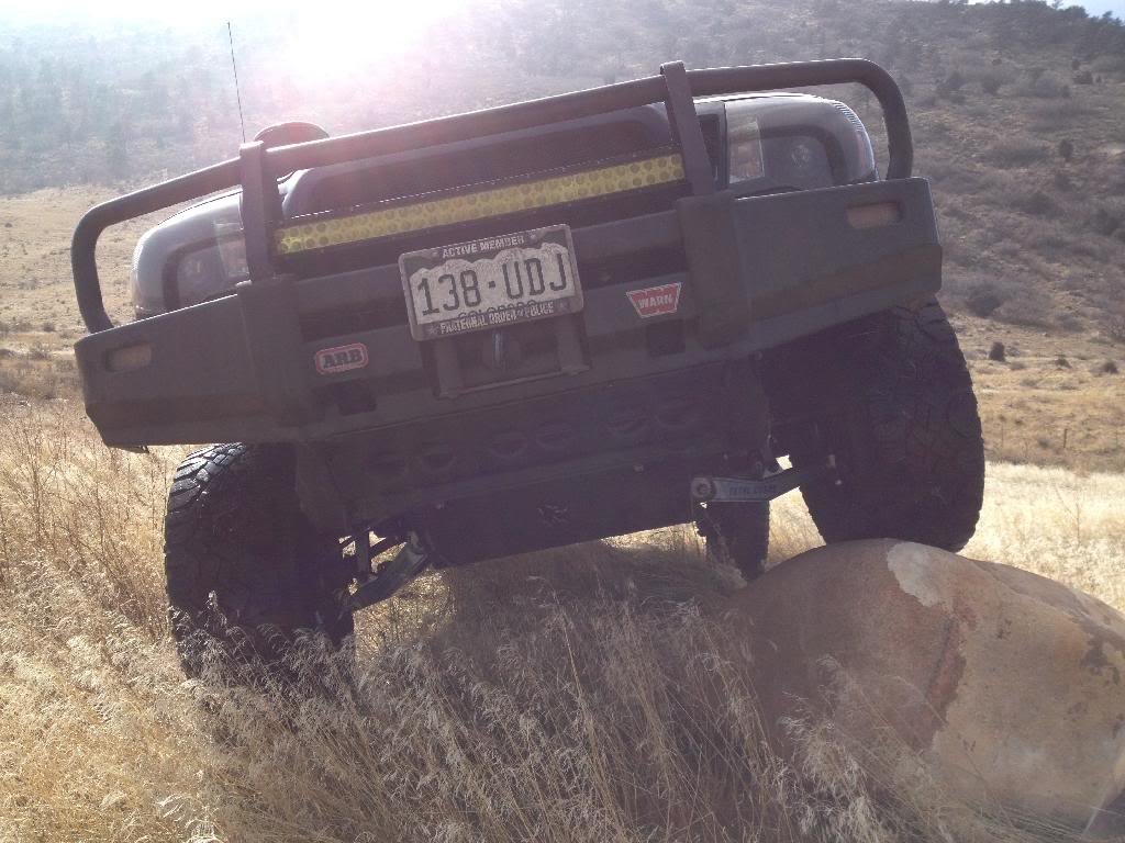

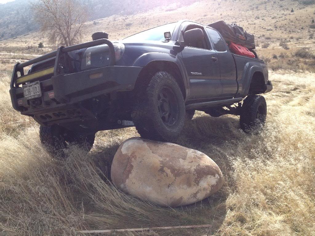

    stretched the new legs out yesterday...

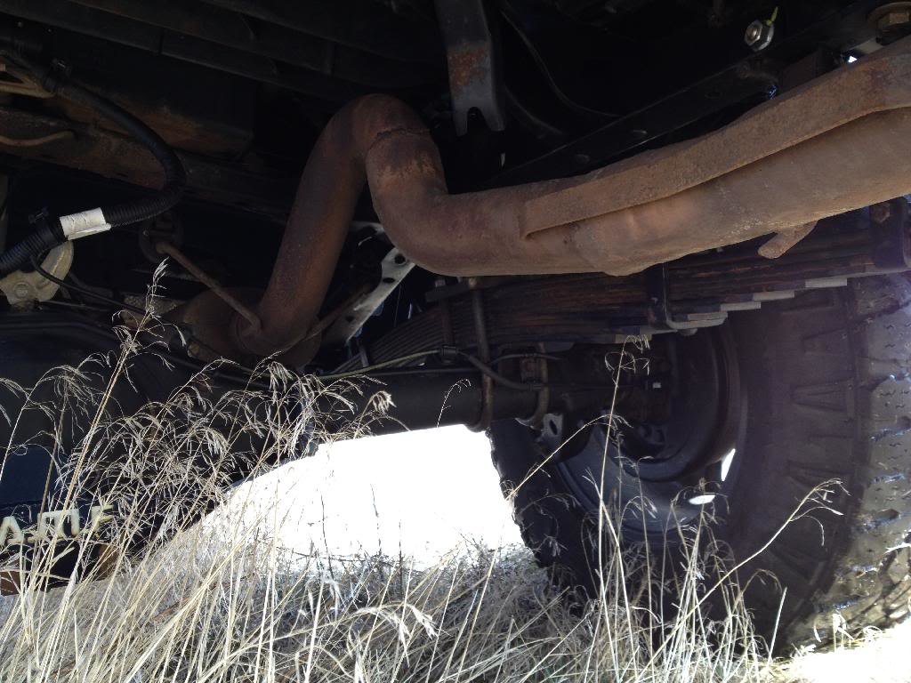

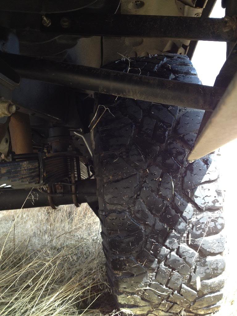

    unhappy rear leaf when compressed
    0D58882C-D4B8-471A-B8B1-16DF154CCD26_zps_08db32fc95e56b864f246f23454cfd5fdf81ce63.jpg
    592170D0-8FD7-41CB-A2FB-F6A0D4F5F62C_zps_cf2dc4ec34bb8ec2bcf827cb32a8d7f2ce8d0b20.jpg
    i think i'm going to have to look into swapping out the XJ shackle setup for the stock lengths...

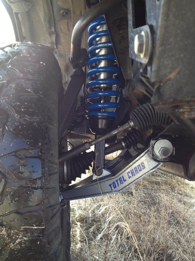

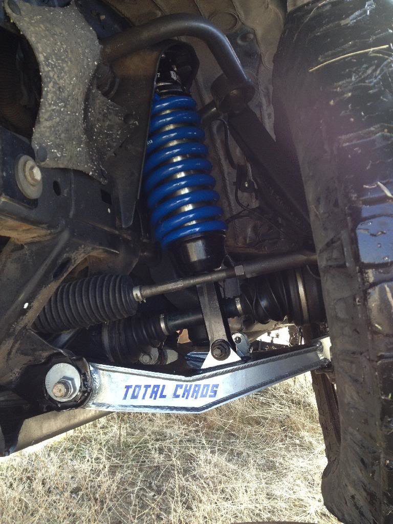

    holy mega neg arch batman! :eek: thats a lot..haha
    looks like your uniball hits the Coils too...but who cares...who did it feel in go fast mode :burnrubber:

    Way too late to ask now... But you should have had Jace cycle your suspension with the bumps and C/O's out. I am curious how much more articulation those lower uniballs have over the factory ball joints.
    My lower control arm are definitely my limiting factor on my travel both up and down. Though I couldn't gain anymore up travel if I wanted to with rebuilding my bump stop mounts. haha Also my CV's don't bind at full droop/full lock with the ORI out, but just looking at them they have to be getting close.
    Just looking at this pic the bushing aren't a limiting factor anymore. haha I know my factory ones won't do that at all:cool: Hell I had to have a pry bar to get them low enough to get my 5100's in.

    yup i've rotated the springs to where the uca falls in between the springs, but i still hit...i'll be looking into limiting straps

    you can definitely tell a difference with the poly bushings.. much more free flowing movement...climbing that rock above was very smooth going up...and even through turns you can notice a difference
