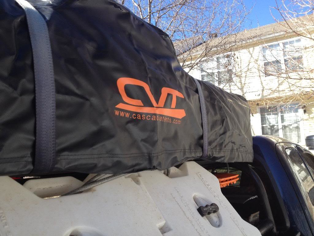

    small project for the weekend...
    Bobby at CVT sent me over a new cover for my Mt Hood
    these guys are amazing at customer service :thumbsup:
    old one has seen its better days...zipper is jacked up, hole in the cover that has been gorilla taped since the summer (that shit holds great :D )
    it'll be nice to be able to zipper the cover shut without pliers now :D

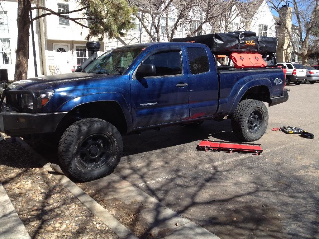

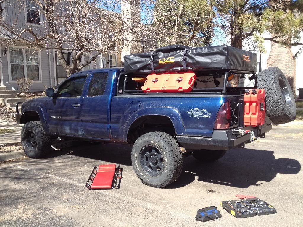

    got some progress done on the truck...still trying to figure out tires...had a snag and may have to work on plan B...
    but i had to keep things moving...now only 3 more sundays left to work on the truck til the first trip :goingcrazy:
    put my ATO tranny skid back up (finally found my bolts!)

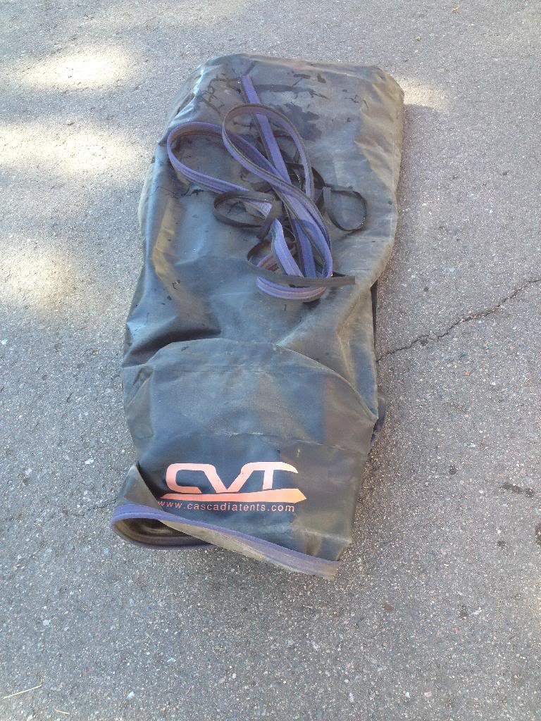

    Bobby at CVT had recently sent over a new cover for my Mt Hood. The cover had a busted and aging zipper that made closing up camp a HUGE pain in the ASS! there also was a hole in one of the corners that i had taped up with gorilla tape since November..
    so out with the old
    FB1B0087-8BE7-4CA9-90EF-7028278930F2_zps_c89586c347f666929b60165a2cbb6fe8b8338ca1.jpg
    in with the new
    C93C0E82-03E8-47C7-BE20-3589D8D86D2F_zps_1bc4e7fd19945704705b9d34bbf0a2edee20683d.jpg
    much better :D
    51CAF547-7093-4C32-B946-CCFEEC41ABFD_zps_6fbac9cec4b1819e7dfc117e8fd2144f837b915f.jpg

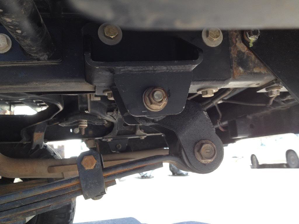

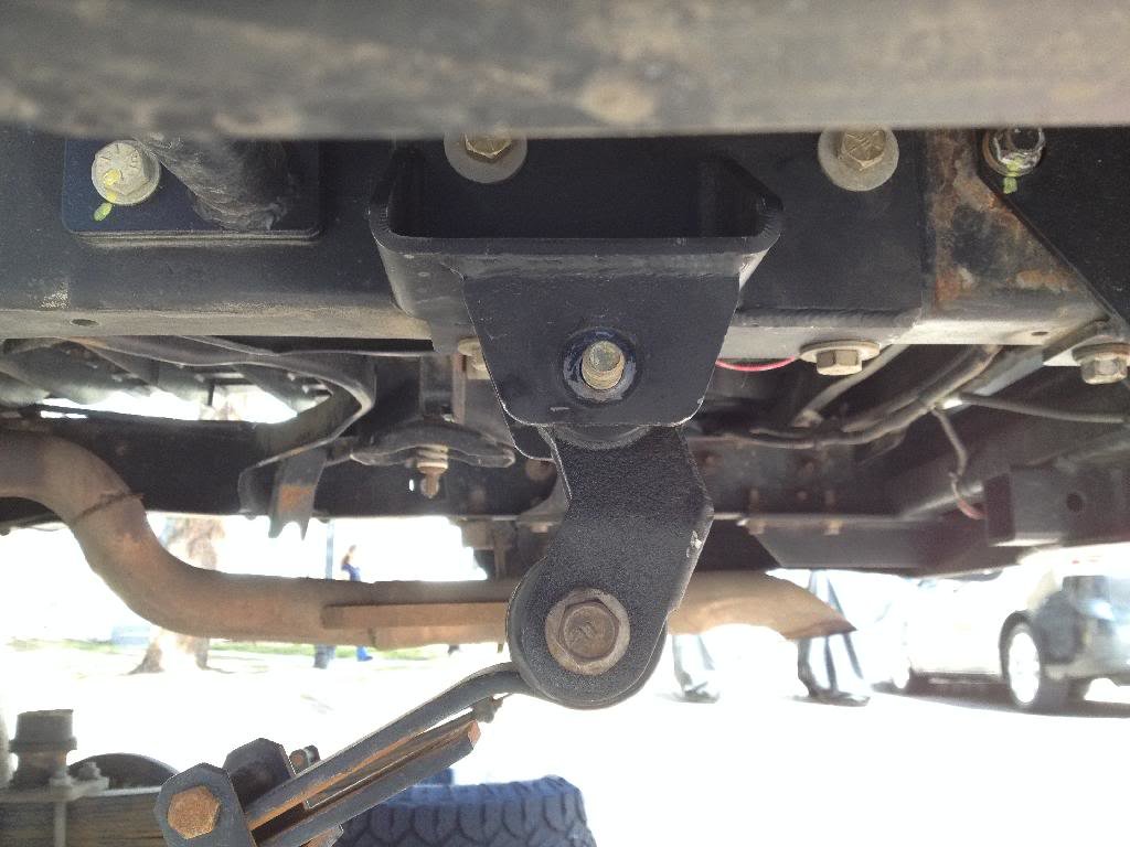

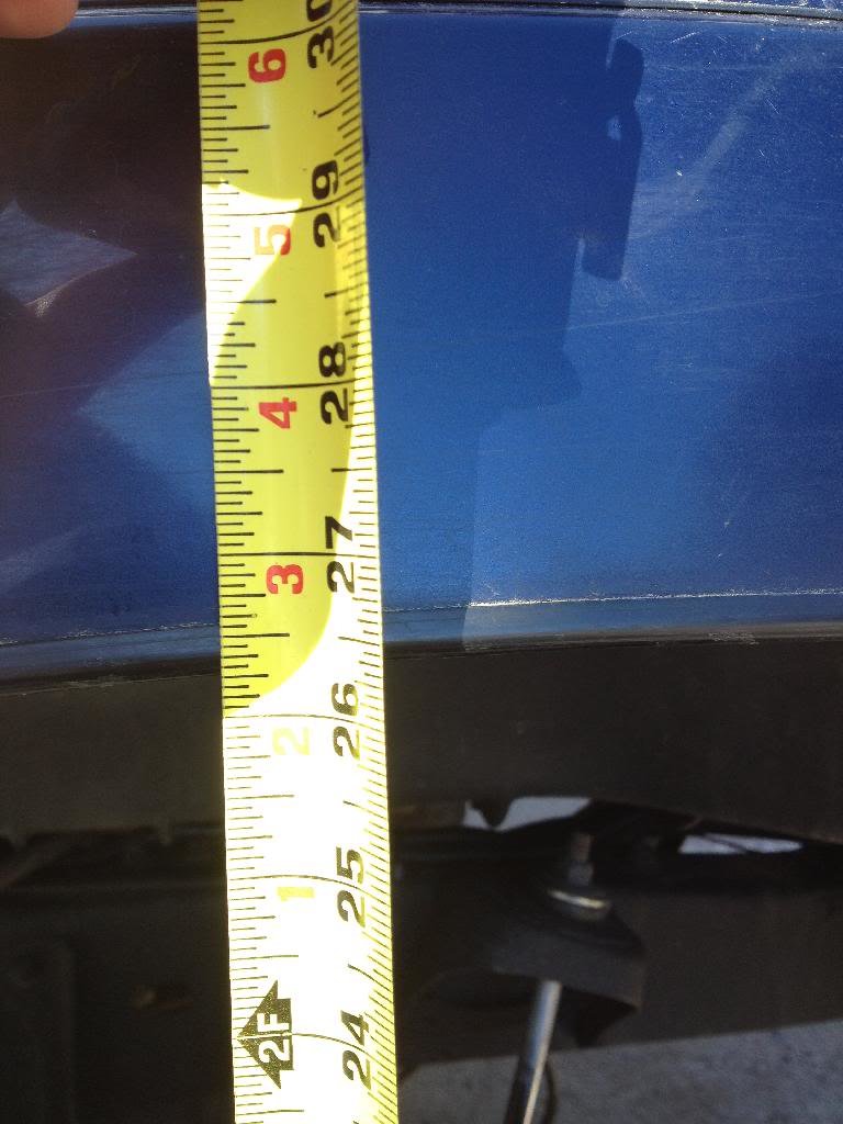

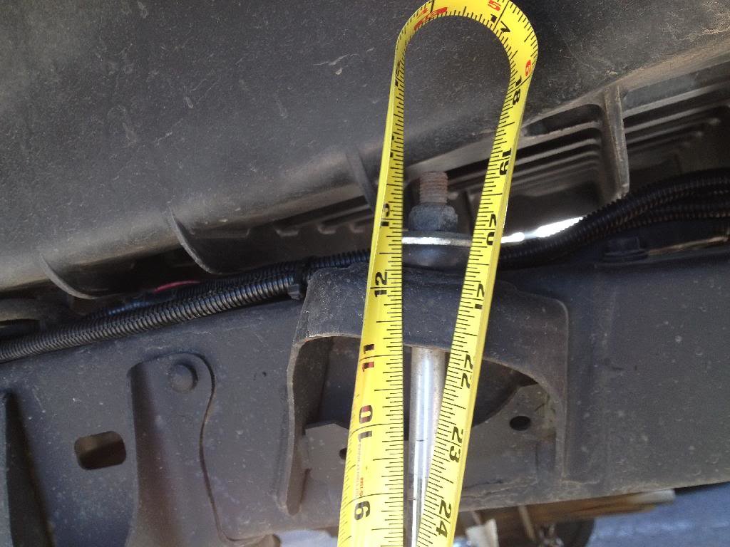

    last thing i did on the truck today was swap out the shackles and mounts.
    the xj shackles were good, but i couldn't get the full range of their pivot with the 11" shocks...
    EF25E84F-24F5-41C1-B72C-5CE513C344D9_zps_cf06ff40c5a5db33b45c13c3b252b2590566abd5.jpg
    so i swapped them out for the Defined shackles i had laying around...with the longer springs i also had to swap the ATO mount for the spare one i had that was made for longer springs...
    luckily my travel numbers were not effected...
    still getting full droop extension on the shocks
    35EFDFFE-3FE3-4180-B17B-6F1F03A08E08_zps_a86d7469a42d3432b97721a2634eb05e1e09b251.jpg

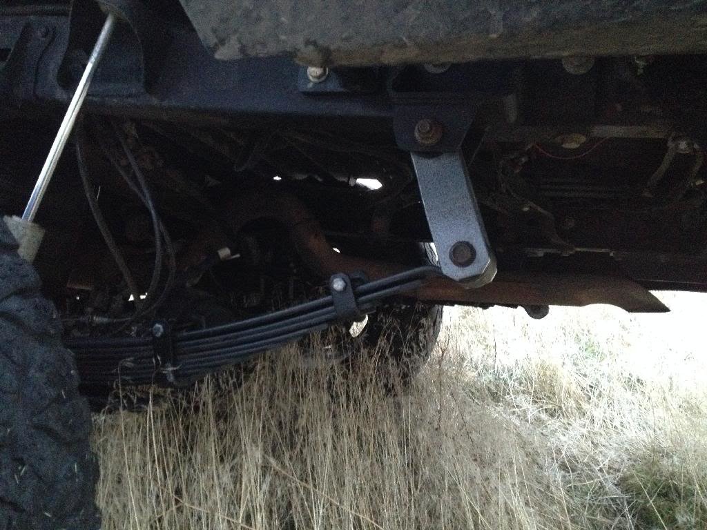

    getting full motion from the shackles on droop
    6FA4ABD0-9DD4-4FC1-BF8B-3A4FA26BA019_zps_5bcd0709decc78ebd16e0e944834cc3c289ef7cf.jpg
    ride angle
    4A3459E1-CB2B-49E0-9794-8EDFBD0EC830_zps_837163ee9f9e01adfb99dd3a1b9543412d718742.jpg
    new ride height
    86F90225-2E74-414A-9B44-B87A55F9912F_zps_e65aa7e813e26a0e71fb83af18f29058aec08adc.jpg
    DBC07004-A2E9-47D6-ACAD-75DF25844FAE_zps_62e1b0117d906bc95d9a363437c00af9f7c4f205.jpg
    60F8CC64-1FD3-4EF7-8853-19FD3B6FCDF3_zps_af8c411028cf67b725ffa6c75979e6f1d836b9af.jpg

    Are those defined shackles stock length? Greasable?
  11. Mar 16, 2014 at 2:50 PM
    #3231
    NYCO
    NYCO [OP] go explore...
    Jul 27, 2010
    #40842
    19,126
    bOb
    Colorado
    Blue Betty - '06 TRD OR
    dents & scratches
    yes and yes....stock length and greaseable
