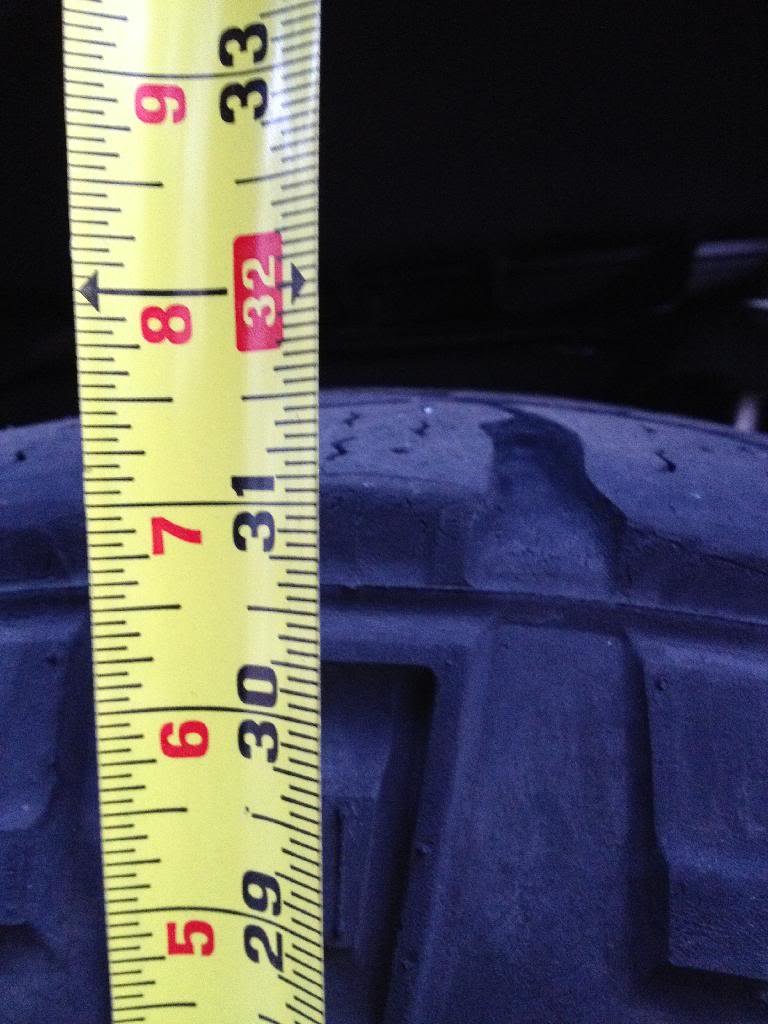

    measured this morning

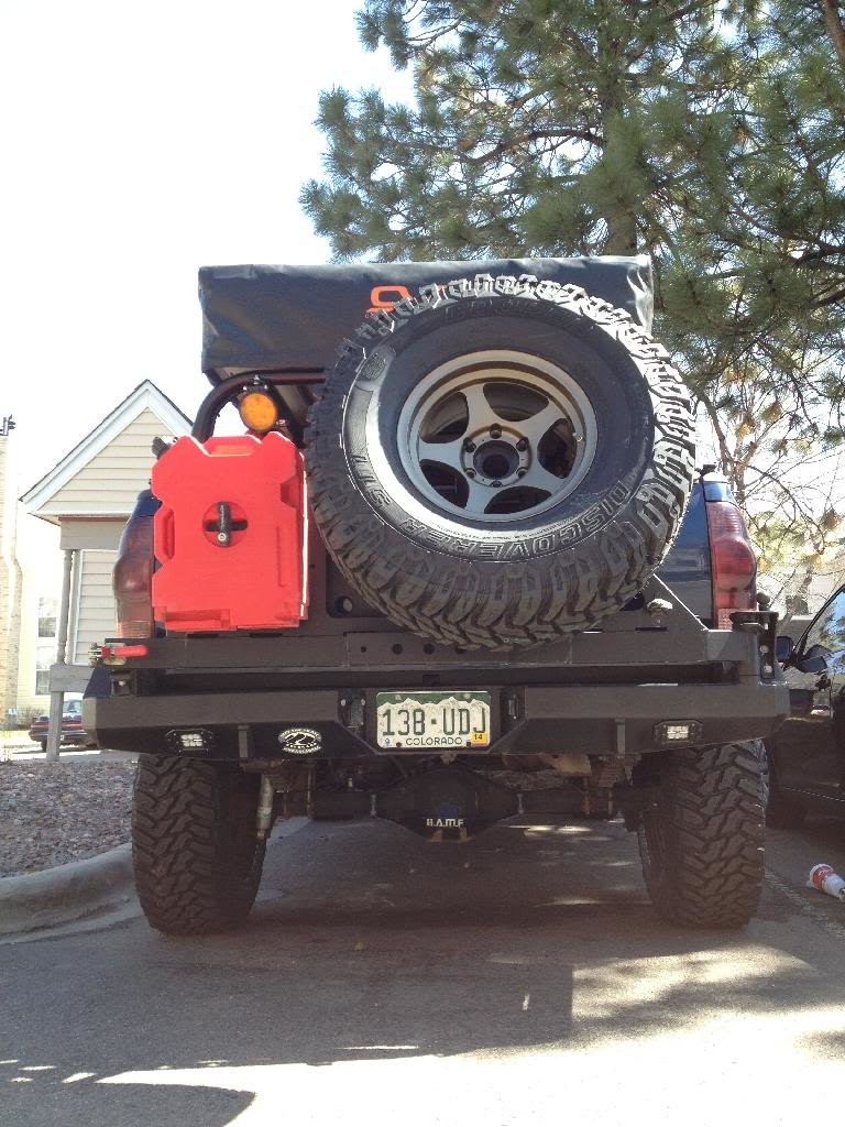

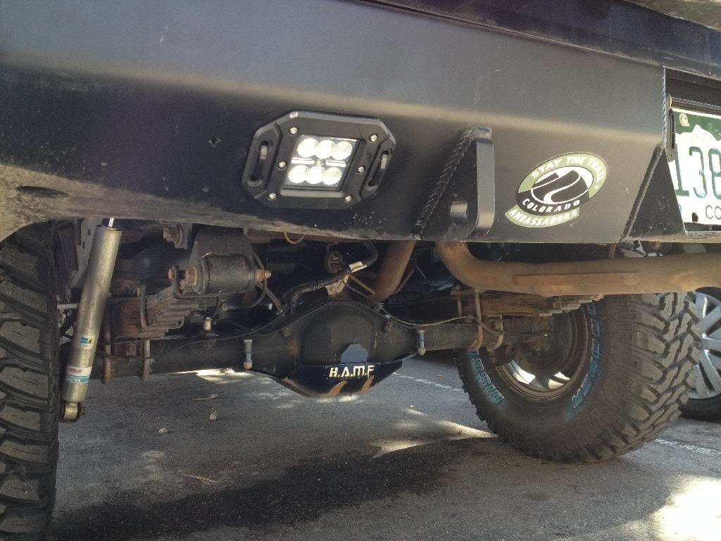

    Little more progress today.
    Had to trim a bit more.
    77F7B889-E514-4175-BAEC-D8A6A130AE2D_zps_c2825cc1ec3d907ec90a980b89cc4647a7e9810d.jpg
    And installed flush mount LEDs so I can see backing up. I should have gotten recessed light from cbi but I spaced on that when ordering. So this was my solution.
    137137E2-20D6-4C49-9B31-FAF51788BD92_zps_f62d8a0166f3e507ac315d0caea638899cb9a054.jpg
    F7B98301-0FFE-4E88-9CE9-7551AB7B9622_zps_6e7e1fdc206ccc236c920c4a1a3e9318fa8b094d.jpg

    Those should be close enough to the shackle mounts that they won't likely come into contact with many rocks

    Those LED's are pretty sweet. :cool: I need to replace the old incandescent back up lighst I have but I have the recessed holes in the plate so would need to find something that fits.

    I like the super-deluxe zip-tie mounting system too!

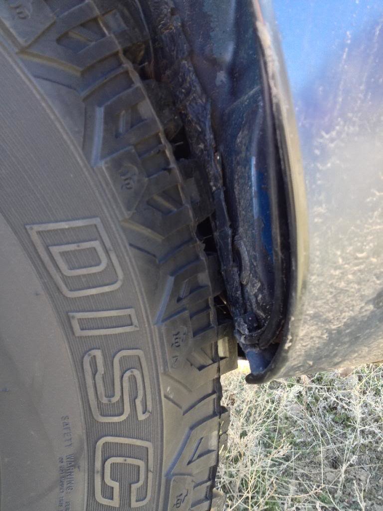

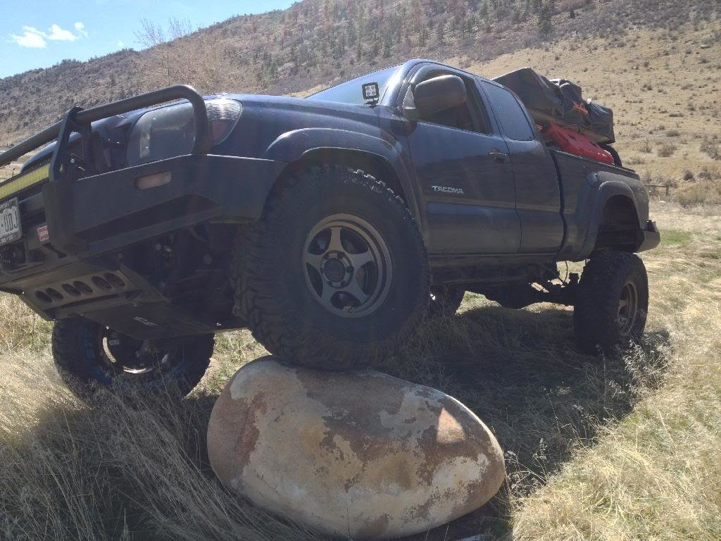

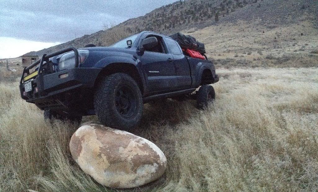

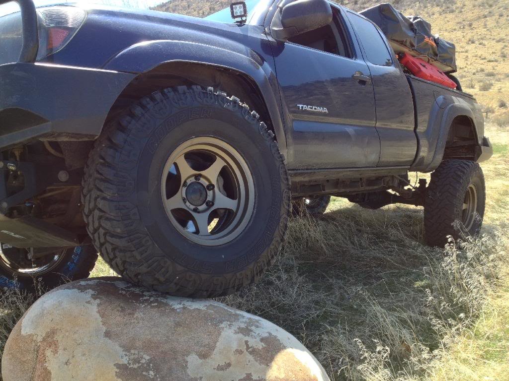

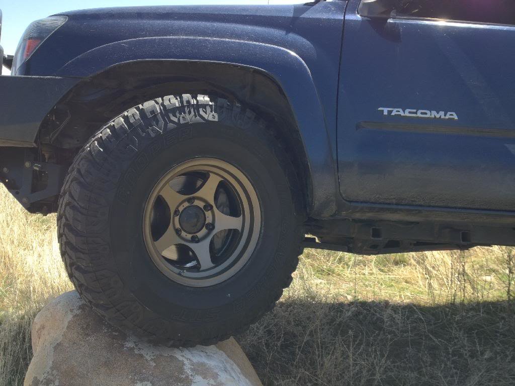

    So took it out to my rock to see how they fit.
    6251558E-56B7-463E-A864-036C9A222D89_zps_58a84ccff1f24bb8f262ea9a5f328631eb708768.jpg

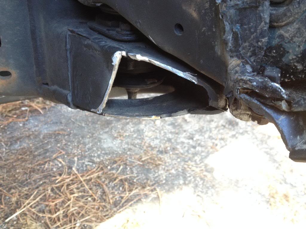

    And I need a date with the BFH :laugh:
    7A1989A5-C522-44E7-8684-90AF8BAEEF38_zps_b60cf9acf4df8b65afd8ae81840622fd721c7a16.jpg
    B28D52CE-97CD-4DA3-BB89-CC77A737BD4F_zps_4d299df8060aa0539129a0e5e6fef8e74ae9cb32.jpg

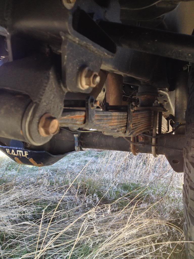

    But everything flexes and stuffs well. Just needs love to turn on stuff.
    1BA3970A-A2AF-450D-9E31-04EC5DB5FB40_zps_7718e660c32223c0015acb61dccac456d0b42541.jpg
    E037CB4C-196E-4F82-B32C-25D540A2C26B_zps_742e80ad2236629ddadaf7c3816e5c063d54c193.jpg

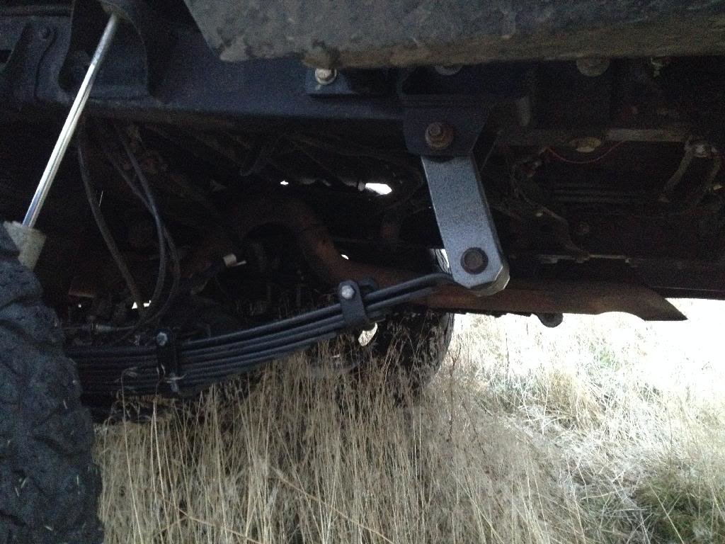

    With the new shackle setup
    E948C2AA-8875-4283-A7B3-89100B50A922_zps_f336d352c051a7a52341afc8f9267778e9e04996.jpg

    Bob that setup is working very well. Nicely done man!

    how bad do they rub? bfh will take care of it? i love using the bfh

    dents & scratches
    driving i'm good now... in reverse full lock i can still touch a small bit of the cab mount..but full lock forward so far seems fine.
    issue comes on compression..straight is fine and even slight turn...but any further turning, i hit the pinch weld area... so i'll need to beat that back a bit or see if a slight caster increase will help push it out a tad

    but i am loving how she flexes now with the new C/Os, LCAs, leafs and shackle setups..so smooth up front, and the rear is getting some great travel..

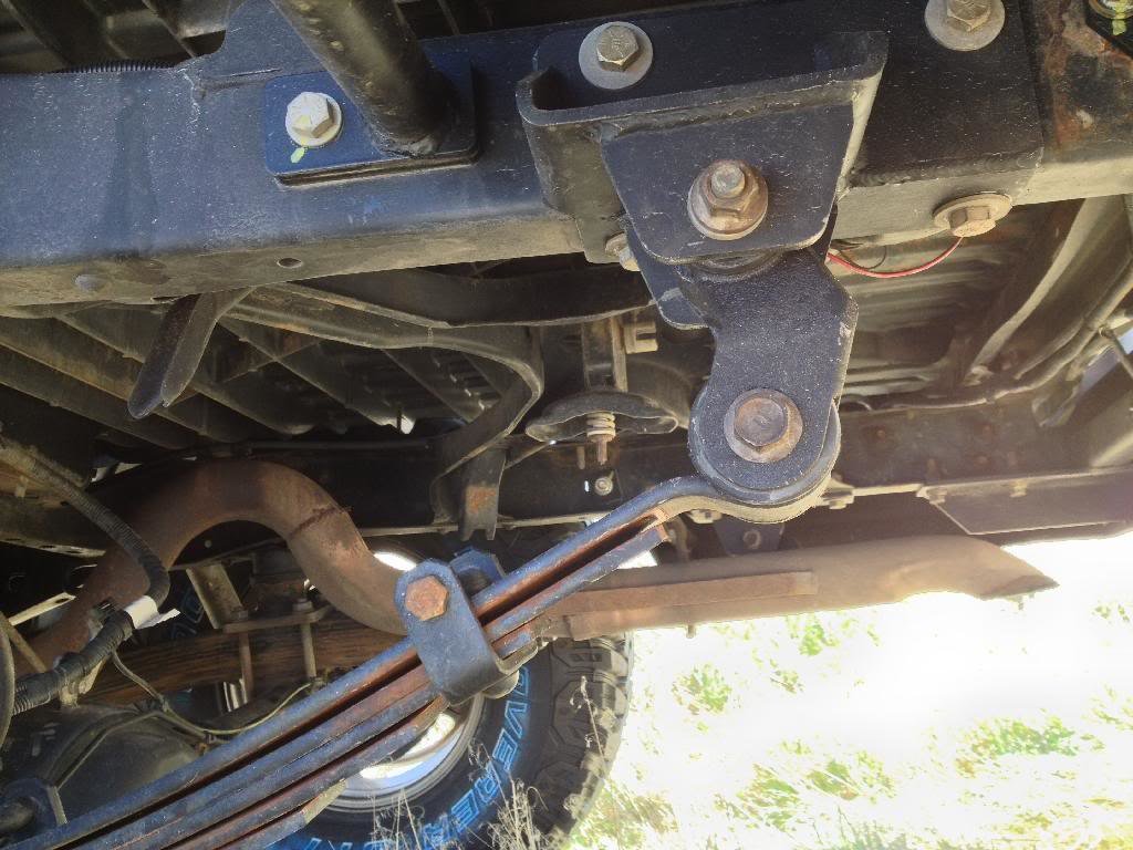

    what shackle did u go to in the rear?
  20. Mar 24, 2014 at 7:06 AM
    #3340
    NYCO
    NYCO [OP] go explore...
    Jul 27, 2010
    #40842
    19,126
    bOb
    Colorado
    Blue Betty - '06 TRD OR
    dents & scratches
    went to the defined stock length that i had hanging around and used the spare ATO mount i had which moved the upper mount back for longer leafs...the BOSS leafs, even though they're only a 2" lift, they are longer than the Dakars..
    the XJ shackles allowed for full extension of the shocks, which i didn't have with the Dakar pack and factory shackles...but they were not getting full motion...
    7608D45D-F65C-40A2-9F20-3F2FED79F5C8_zps_ce13935ff7cf4c471e250c3529f020a1a155e451.jpg
    EF25E84F-24F5-41C1-B72C-5CE513C344D9_zps_cf06ff40c5a5db33b45c13c3b252b2590566abd5.jpg
    so the switch was done to try and get full motion out of the shackle...and i'm still able to max out my shock extension...so i dropped slightly in the rear which puts my leafs in less neg. arch on compression, and i'm still able to drop the tire as far as i did with the XJ
    and i get full motion from the shackle ^
