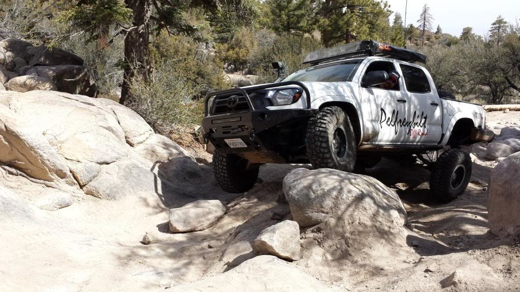

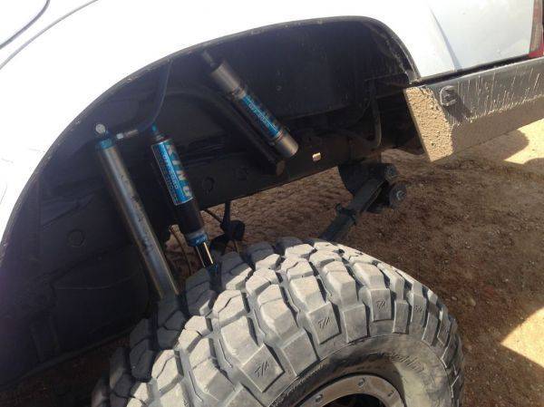

    I'll just leave this here........
    Stock configuration inverted shackle is not too bad on droop I suppose

    sure rub it in :D
    would love to run that setup...
    guess we can compare travel numbers while we're out in moab and you can convince me to change :D

    hahahahaha...
    oh i agreed with you..just hard converting back
    especially to run tyler's setup, i would need...
    new shackle mount bringing it back to inverted
    new leaf pack
    12" shocks
    hydro/air bumps
    convince kayla this is all necessary :D

    Keep in mind Bob, running a hydro bump in the rear on a SOA setup does add additional noises. Mine stroke at 2.5" and thats bascally half of the up travel so you hear them tapping a lot. They are nice for the harsh bumps, really as nice as youre gonna get while staying SOA. At the end of the day there is only so much a shock/bump can do with 5" to work with. Now if you are cycling the rear at speed and its dropping out then compressing its much more effective, the shock has more time to do its thing.
    At the end of the day the hydros certainly do help but you are still dealing with a very small amount of uptravel
