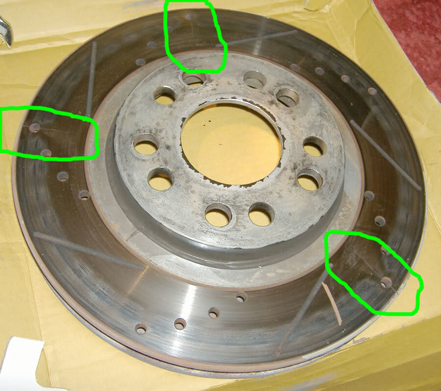

    The more material you remove the more likely they are to crack:
    Vented rotors are better designed to take heat away from the brake system:
    Solid rotors have more mass and take longer to heat up.
    Thats not to say they don't have their uses: dirt or sand stuck between the pad and rotor (say muddy, sandy or wet conditions) will get caught in the slots and removed within a quarter turn of your rotor (the spacing between the slots). But your calipers probably produce around 2000lbs of clamping force and will crush whatever is between the pad and rotor in short order anyway.
    Outgassing is not a problem with modern brake pad materials, at normal use temperatures. It is unlikely any tacoma driver, outside of pre-running, will heat pads up enough to outgas anyway (And if they do they should run pads designed for higher operating temps anyway).
    That said they look pretty sweet! Just get quality cryo-treated rotors if you go with drilled or slotted. I liked the Brembos back when I drove like an asshat.
