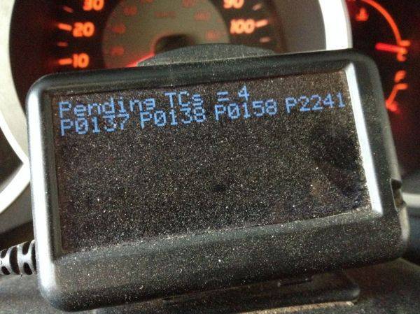

    P0137 - O2 Sensor Low Voltage Bank 1 Sensor 2
    - Faulty Rear Heated Oxygen Sensor Bank 1
    - Rear Heated Oxygen Sensor Bank 1 harness is open or shorted
    - Rear Heated Oxygen Sensor Bank 1 circuit poor electrical connection
    - Inappropriate fuel pressure
    - Faulty fuel injectors
    - Intake air leaks may be faulty
    - Exhaust gas leaks
    P0138 - O2 Sensor High Voltage Bank 1 Sensor 2
    - Intake air leaks
    - Exhaust gas leaks
    P0158 - O2 Sensor High Voltage Bank 2 Sensor 2
    - Faulty Rear Heated Oxygen Sensor Bank 2
    - Rear Heated Oxygen Sensor Bank 2 harness is open or shorted
    - Rear Heated Oxygen Sensor Bank 2 circuit poor electrical connection
    - Intake air leaks
    - Exhaust gas leaks
    P2241 - A/F Sensor Short Circuit Bank 2 Sensor 1
    - Faulty Air/Fuel Sensor Bank 2
    - Air/Fuel Sensor Bank 2 harness is open or shorted
    - Air/Fuel Sensor Bank 2 circuit poor electrical connection

    Rut-rorow

    It's probably from all that dust! :p

    problems you get when you actually go wheeling :cool:

    Or don't have a dust buster. :D

    welp, truck is DESTROYED. time to burn it down and start over

    It appears it's time for a new exhaust system. I say 5" pipe and dual chrome stacks in the bed.
