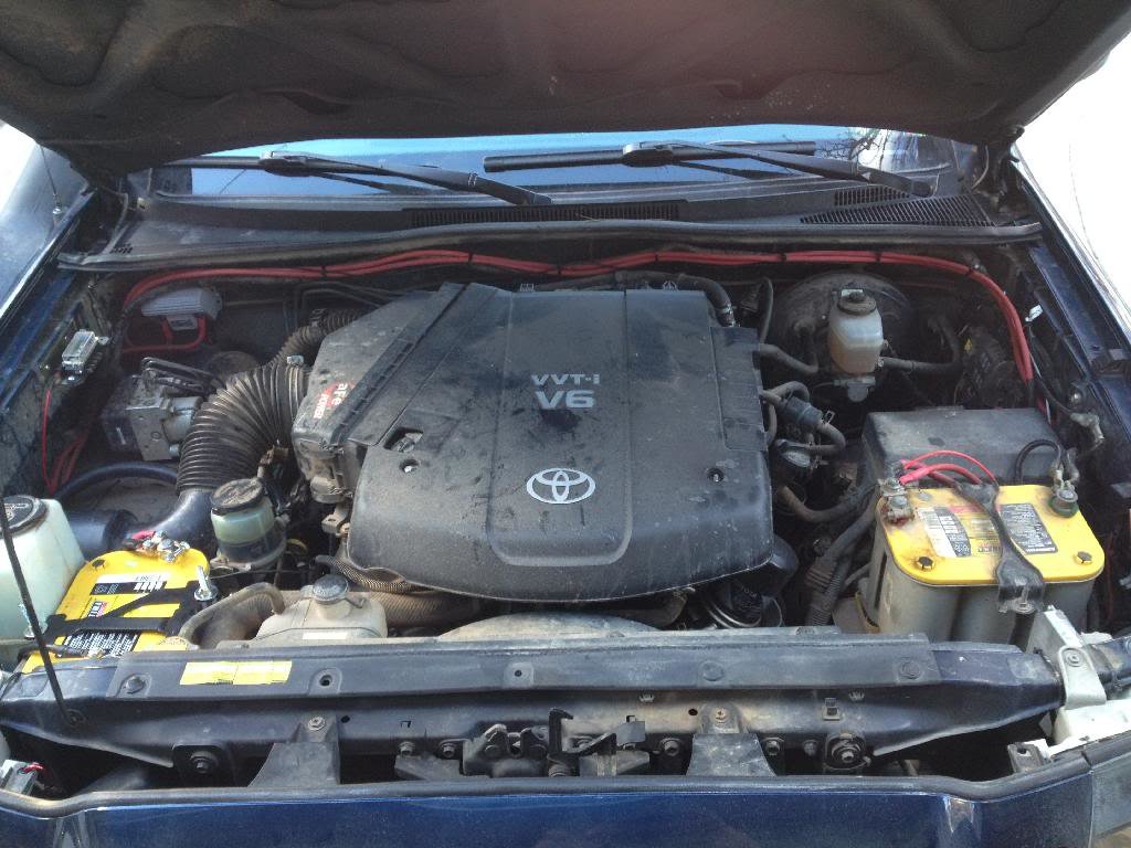

    Thought of using aluminum pipe for the routing of the snorkel fittings in the engine bay?

    I could see that on the safari snorkel. That rubber union is really soft and flexible. The Airflow snorkel that Bob has hooks up to the stock intake pipe differently with a more rigid but still flexible pipe. You woud need to change that rubber union on the Safari snorkel and then it MIGHT work.

    Already did. I still eat lots of dirt and sand. I'm beginning to think that the cowl isn't much safer than the fender... At least it doesn't suck in mud and water off the tire though. Aluminum soaks up lots and lots of heat though... The whole time Moab I routinely saw intake temps well over 130* since it soaks up all the heat from the engine bay. Basically defeating the purpose of a CAI...

    I consider running custom tubing in AL. Instead ended up creating at pipe from parts I got at the local auto parts store. Actually not a bad product. Each section has a rubber gasket to make it air tight. I have had it on for about 10 months now with no issues. Temps stay lower then the exhaust pipe I used to run on there.

    Now, I like that. Exactly what I was referring to. Just a cleaner setup. Any intel on the actual parts? Approximate cost?
