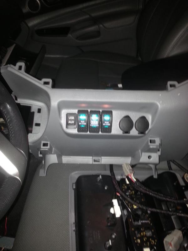

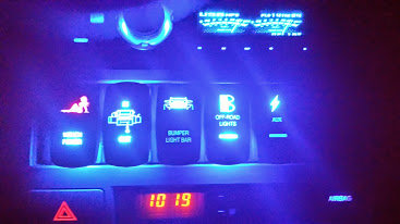

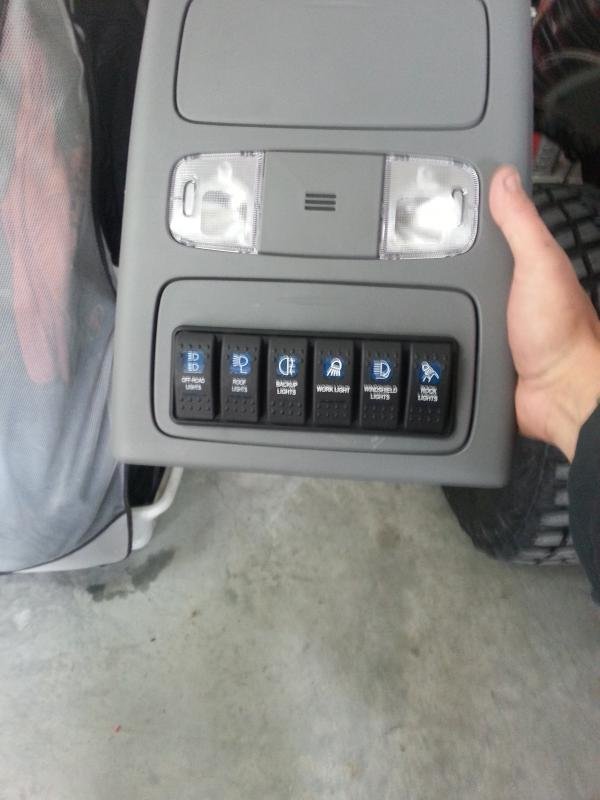

    That's my basic setup for switches too Bob with all the lights in a 6 switch panel but up in my sunglasses holder with my airlocker controls being down where you are planning to do those switches...Food for thought. If you pick up a 2012+ lower dash you can run 4 switches right in those OEM holders and it will look clean as it comes. If you look in my build I posted pictures of the 3 switch and 6 switch setups.

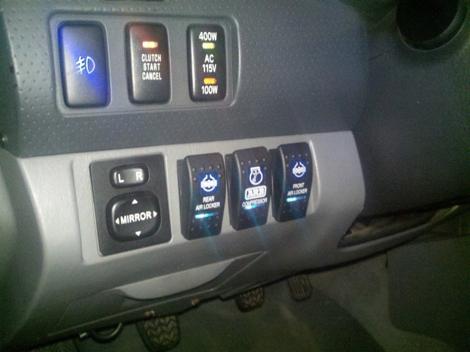

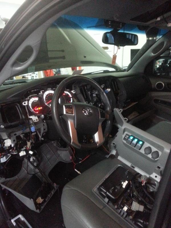

    Here what i did with switches :D
    e2hqHuLoly7LnvlnB1lSTZaZH9bhDFATYtscWmgo_4e26c69e80cbed145f93ecada475f46aa0ccfd17.jpg

    Here I brought the two posts over with Pictars.

    F&R ARB Lockers :drool:
    having a double din and manual limits some of the options....
    the 12+ lower dash has smaller switch locations which means i can't run cool OTRATTW switches :p

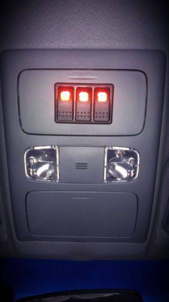

    This is how mine are currently set up and I really do not mind and have found a quick glance is easier than rattling my ocd the entire drive making sure they are "off" when my light are on :eek:.

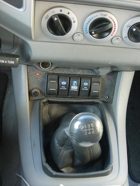

    I put mine in the sunglasses holder as well. I wired them straight to the battery so I can run my lights with the ignition off. The catch is that I have to make sure to turn them off every time I get out of they stay on, especially for the switch that doesn't run lights and you forget it's on. haha
    Can't find pics of the wires... but I used these elbow connector and ran all the wires into a single 12 ga wire that I ran from the sunglasses holder to the battery. Did the same for ground.

    i think i'm going to run the sunglass holder setup with a 6 switch panel
    i already have aux blocks setup and ready to receive new accessories, so i will be running separate wires up there for each...
