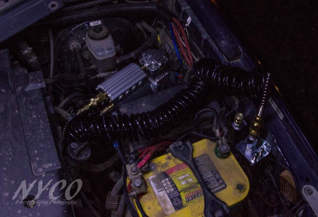

    main hose comes down from the large valve...there are two T connections a few inches down, one from each schrader. the blow off valve comes to a T within one of the schrader hoses...
    after those two Ts where the schrader valves join the main hose, the hose is routed down under the radiator where it comes to a T where it splits left and right... shortly after that the hoses split again to go front/rear.
    you can fill up using either schrader valves or the large valve
    the back schrader in my situation is hard to reach, but i will not really use this one...
    until i get my new hose, i will fill up and check pressure using the front schrader.
    when i get my new hose, i will fill up using the large valve...turn the compressor off and i can check pressure through the schrader...
    the front schrader will also be used in deflating to check pressure..

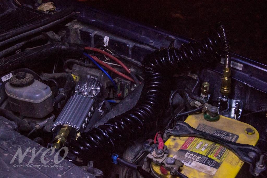

    so i was thinking the hose that comes with the VIAIR ADA system would have two female connectors...not so much..the ADA has a female output and the air gun has a male...versus the 300P that i have, has a male connection on the compressor...
    info on the ADA Heavy Duty, http://www.viaircorp.com/ada-heavy-universal.html
    so i said fuck it! might as well get this bad boy mounted up and ready to rock for this week :cool:
    the hose will remain disconnected until fill up...
    so to deflate...either use my stauns or connect the 4 whips, open the valve until desired pressure reached
    to inflate...connect 4 whips, connect to compressor, flip switch, open valve, enjoy beer :cheers:
