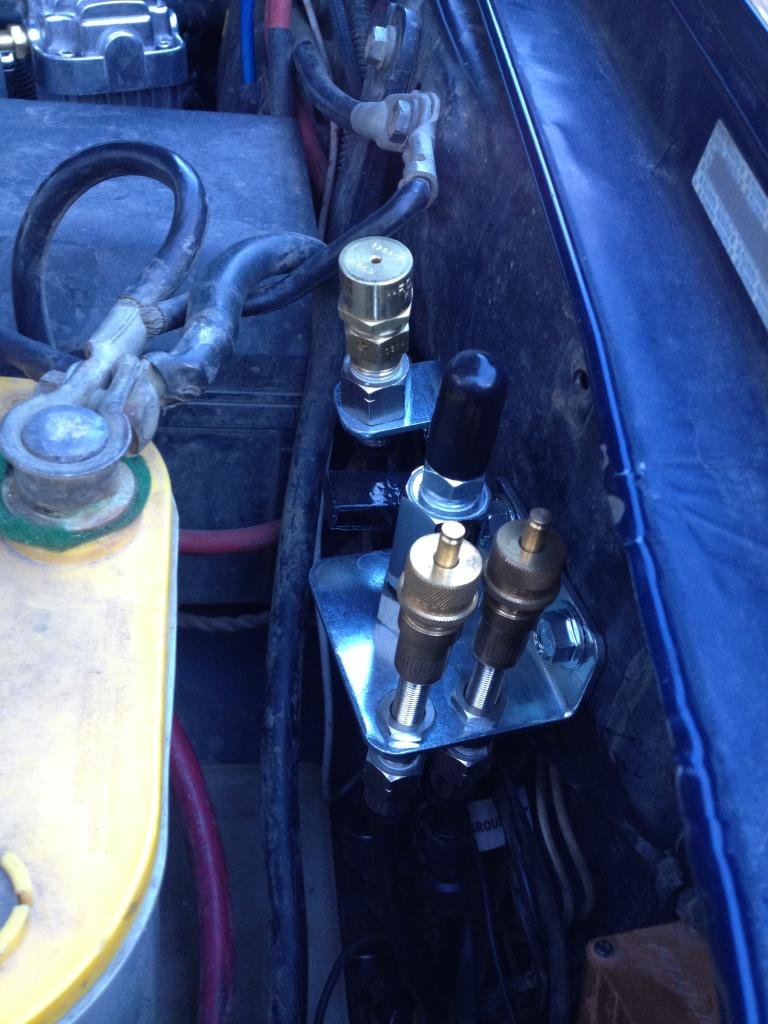

    tested the Stauns method of deflating and worked like a charm! :woot:
    28431237-4C1F-4BE4-9ADF-E00C136D0603_zps_fd320748c3a9fb58584aa5ce07c76fd63e80df23.jpg
    things just got a lot easier :D

    used two for more air flow and also allows me to take one off during the process to check the psi. then I can stop anytime by pressing down on the top of the deflator or wait till it reaches my set psi

    setting the blow off valve was a bit tricky...small movements translate to 3+ psi changes
    luckily the Viair ADA made quick work of it...
    keep the hose connected, close the valve on the 2way air, the Viair will keep building air in the mini tank until it reaches 80 or 95psi i believe, then it shuts off automatically...when ready open the 2way air valve back up and the tank releases and the pump starts back automatically when it needs more air...
    pretty slick setup in such a small compressor...
    stauns set at 15-16psi and the 2way inflation set around 35psi...shit got much easier with this move :D
