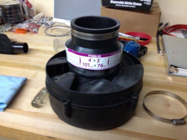

    Home Depot had a 4X3 reducer for $8. If it wasn't 9 degrees and blowing like hell I'd install it...

    so I noticed when reinstalling today, the slit where the debris is projected out...make sure it is in the back...I originally didn't notice it and accidentally had it facing forward...kinda defeats the purpose...

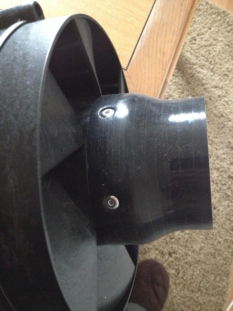

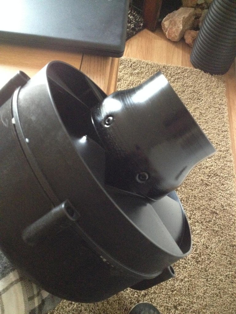

    so I went ahead with the rivet idea for the top joint...
    92601CD2-5950-4742-B4A6-72D01292D3C5_zps_f1d4a5a4c3dedfdb1e5c69f669de7738d50678ab.jpg
    then through some satin over the rivets and reducer
    4615E692-513B-4FF8-956D-6A74D468793B_zps_ae0740d3ef3421d2766ea06a9fc35203800ad8f2.jpg
    no more silver band
    5F606DBE-6D42-4D7E-85A3-B91B99A65968_zps_4490edd1cf249e42066c24f10fcbda91c50cc276.jpg
    570B7352-5C85-45E9-9C8F-E1FBECDF7629_zps_4f194d62235a5b72e87e542954b49257741694fb.jpg
    15899E4D-D902-44D3-AD75-4D1D83DDCCC0_zps_568df4f0bc48d09d321d724fb21a7efbca377836.jpg

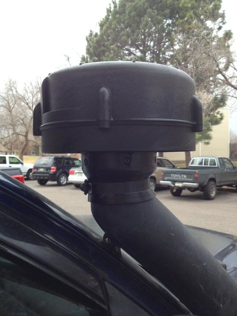

    and with a screw in the bottom along with the clamp...this one shouldn't go anywhere too easily
    147A0CF5-8AFD-4D4C-852F-967718CC2A40_zps_d85437f91ccd9bbee942ecfafdfd749d4c925b30.jpg

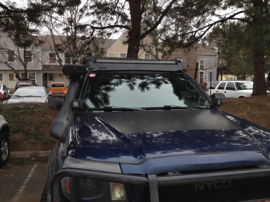

    I noticed a difference....my commute is directly east in the morning and west in the evening, so something had to be done...
    now it's grown on me and glad I did it for more than just the glare

    10 DCLB
    TRD Fleshlight
    Looks good Bob. Good call on the exhaust port. Once we get back above the freezing mark I'll go ahead and get mine installed. Thanks again for doing the research and finding this.

    What size hose clamp did you end up going with for the coupler-to-airflow connection?
  20. Feb 16, 2015 at 3:11 PM
    #4580
    NYCO
    NYCO [OP] go explore...
    Jul 27, 2010
    #40842
    19,126
    bOb
    Colorado
    Blue Betty - '06 TRD OR
    dents & scratches
    4" for the airflow connection...rivets for the top
