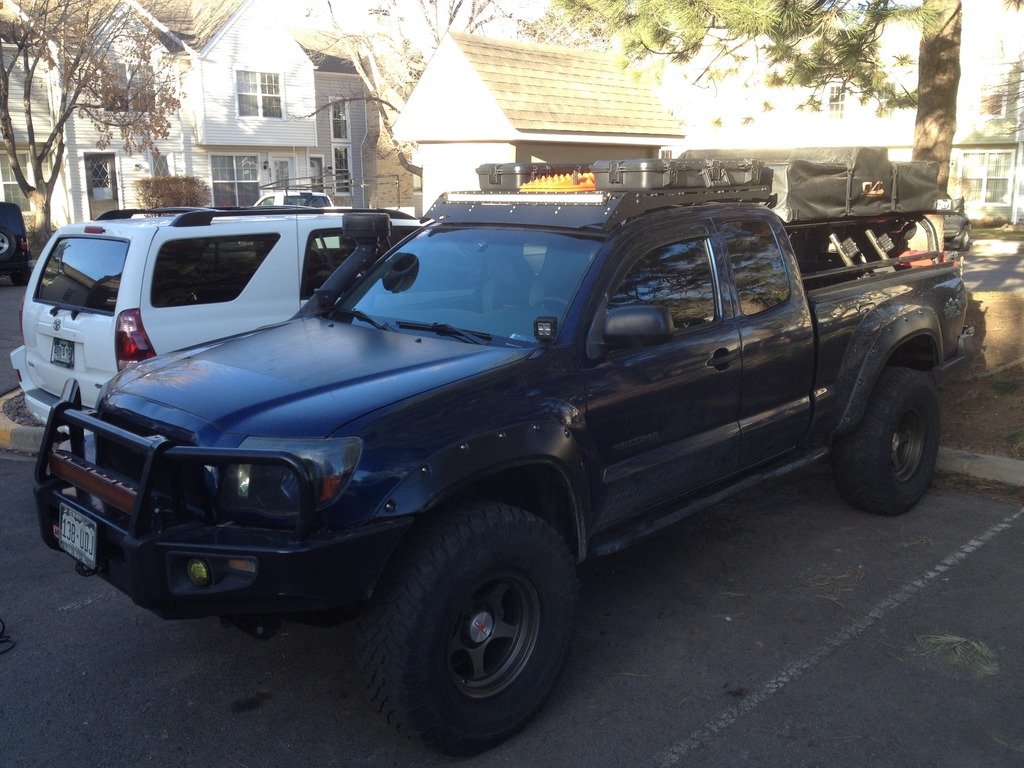

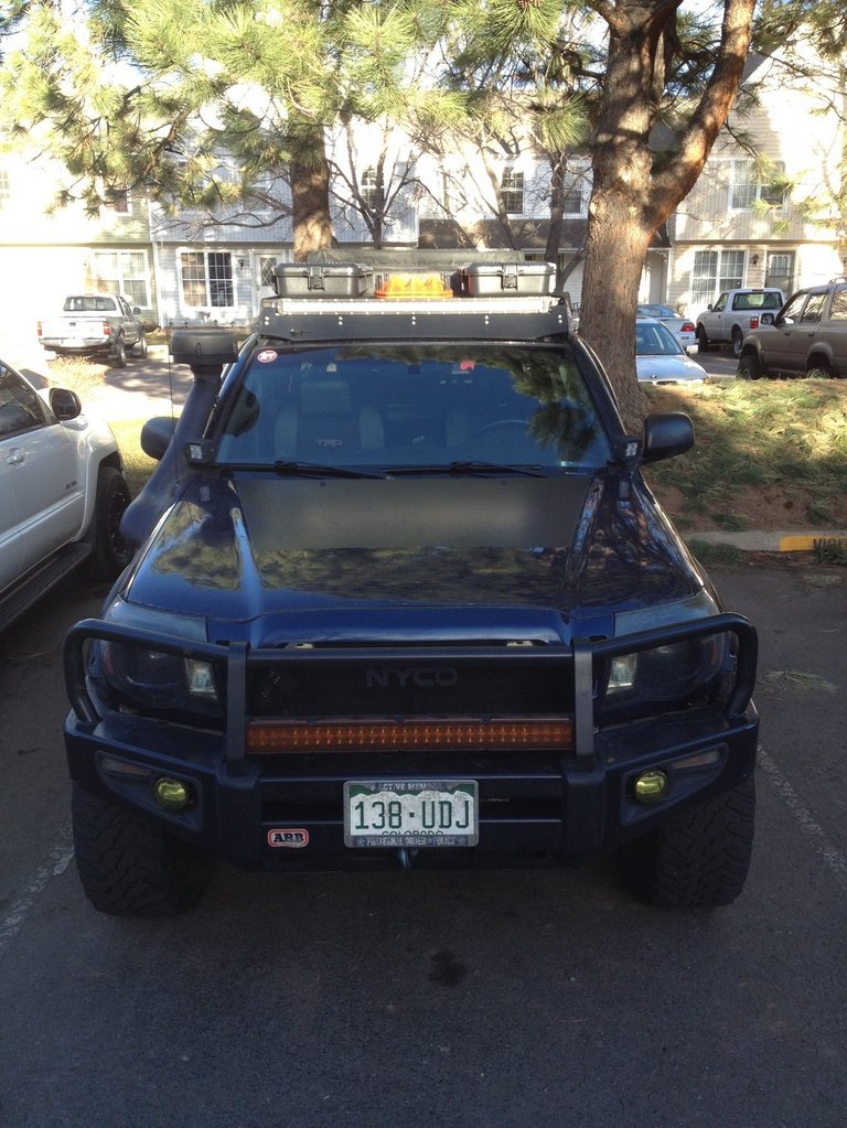

    little accessrac update. plano cases mounted and maxtrax relocated.

    yea, i have some work to do to make it fit, but thats the plan

    I love it. I was planning the same thing for my prinsu rack.
    The handles on your plano cases look black. I've only seen them with yellow handles; did you do something to yours or did they come that way?

    came that way actually. maybe an older version they had on Amazon.
    edit: Plano 108364
