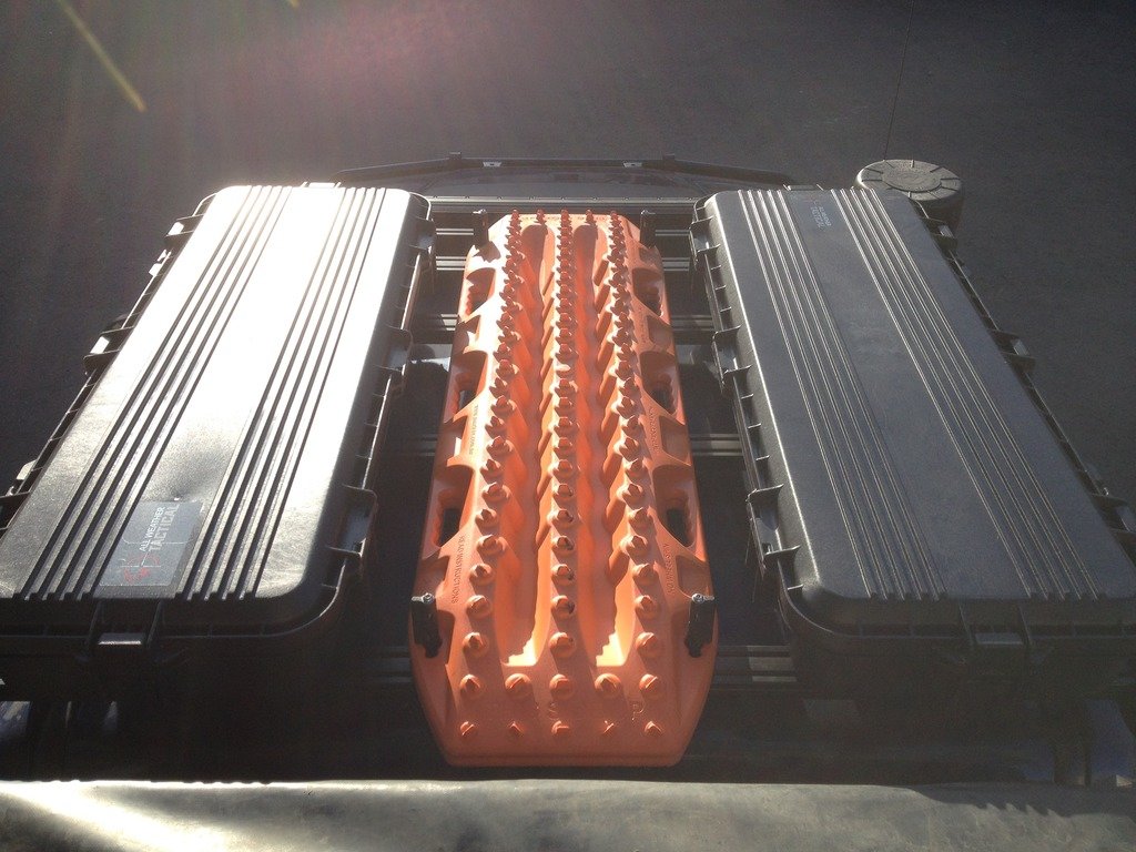

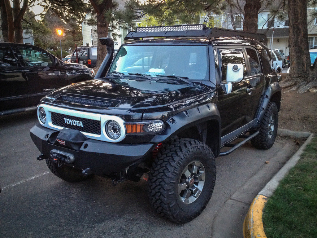

    yup..put it back as much as i could to allow the air to flow over easier...hopefully

    thanks. works out good so far. gets some shit out of the cab, better mounting for the maxtrax and looks sweet along with the 40" :cool:

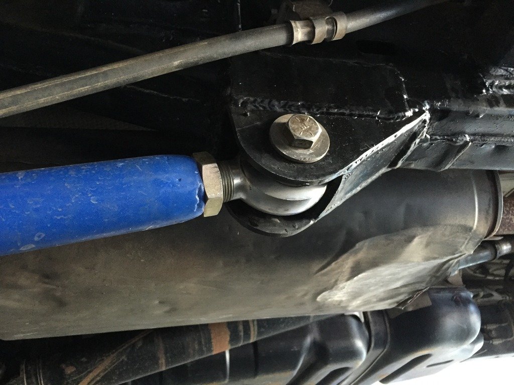

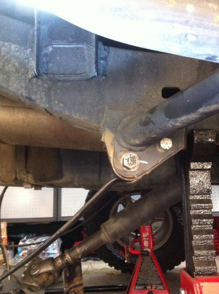

    axle and frame -upper link mounts only
    custom cut washers welded in for reinforcement
    upper link mounts before
  13. Apr 22, 2015 at 8:53 AM

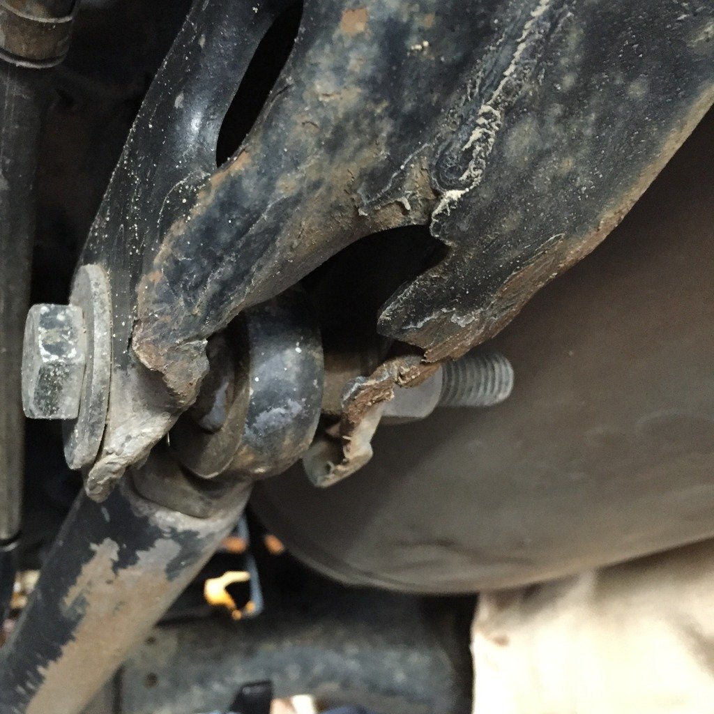

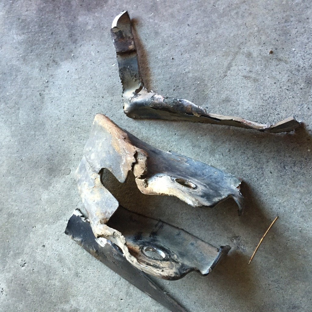

    Very cool. I just made a set of upper links for my truck, and that metal is pretty thin there, just like the lowers. Looks like those were kinda jacked up already though, so a repair as well?
  14. Apr 22, 2015 at 8:57 AM
    #4814
    NYCO
    NYCO [OP] go explore...
    Jul 27, 2010
    #40842
    19,126
    bOb
    Colorado
    Blue Betty - '06 TRD OR
    dents & scratches
    yea between poor design and lack of maintenance, the holes began to oblong creating a nasty lunk and axle shifting...
