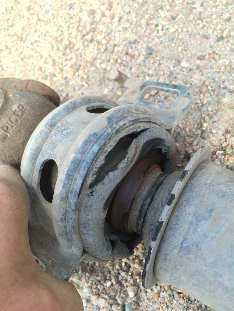

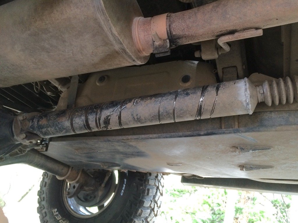

    this
    8A765358-681A-42E1-B439-9B57800E0A61_zps_dd1348d6efeac1c0b07e79a250fe2e5201951a85.jpg
    led to this
    21CF2F4D-5EAE-45A2-951E-C38ABAAE6F36_zps_4cddbe8ad3fbf7d9fbc7dddb2f536bc5de318fd7.jpg
    which led to mess associated with this
    th_90B13070-F365-4C57-96FB-9EDB4CFC3672__e23a0775df528939af67b7b26ffc5efc24f54c6e.jpg
    leaning toward a blown up wheel bearing...when the tire first lifted, it was loose with a lot of play...before shit went downhill, i had a rotational brake squeak which is common with a bad bearing as the rotor was out of alignment...
    tried to take things apart while in the mountains to replace the hub when the lower caliper bolt broke off inside the spindle...which led to the above post :(

    that's an understatement :laugh:
    got my one piece driveshaft in there now...going to swap in a spare spindle that i'm picking up this week from a buddy and throw in my assembled hub this weekend...hopefully that'll solve my issues...and hopefully i don't notice anything worse when i tear it apart :pray:
