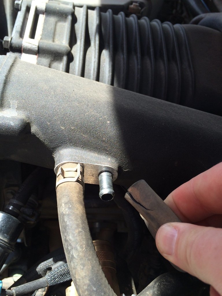

    so this was fun..... :bananadead:

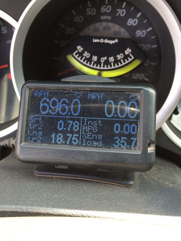

    cruising down the highway coming back from a client's when i hear an odd hissing sound that fluctuates depending on my throttle....hmmm weird
    so i cut off 36 to 25 south when i get a pending code p0441 pop up...hmmm that's not a normal pending code i'm used to seeing....
    WTF IS MY FUEL TRIM DOING AT 30+?!?!?!?!?!!?!?!!!!!
    alright, calm down, let's get off the highway and check this shit out....
    well that's not good
    77F29DCE-C51A-413F-BE80-C5177D54159E_zps_84ea90a7d455c5f27098cbd93d5b89e9b8ef30ea.jpg

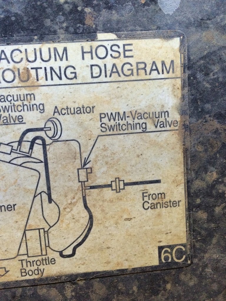

    for reference, it's the vacuum hose coming from the vacuum switching valve
    F1853EA3-5263-4E24-BC53-AF1215836FA6_zps_e4267e7321f5c564537faf6f45121bce823d1bf4.jpg

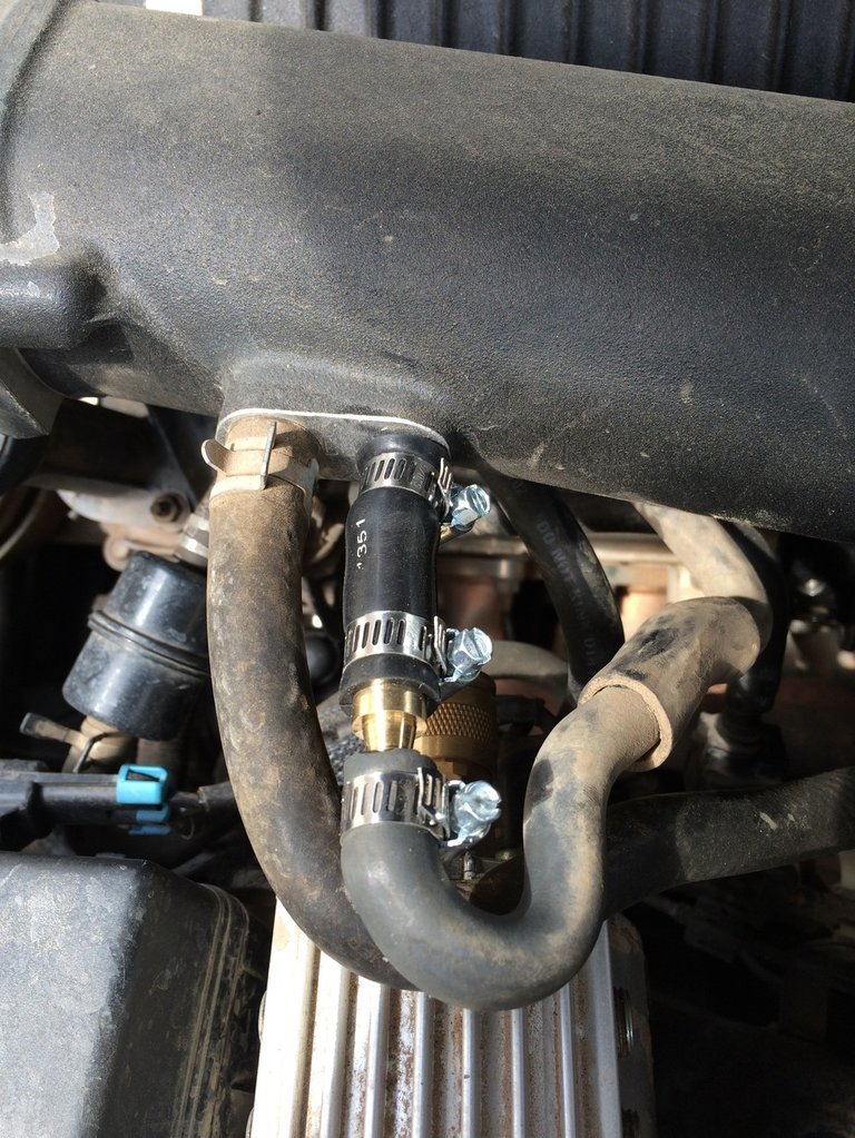

    so for a temporary fix, i cut the hose back past the split and zip tied it onto the nipple....didn't quite solve the issue, still had high trim
    EB03F111-8F24-4FFE-9587-4DAEFE732997_zps_ec0f223a31f089e95be4978d77975de9de64150d.jpg
    so i limped over to the closest o'reilly's to grab some repair items...
    9369BB4F-8597-4827-9257-BBE8F56EB814_zps_b8a16a166aa648aba4f84fab233b1072d2a6dae2.jpg
    did a little fix
    C734716E-31FB-4F97-B243-57B6A30019DE_zps_20be06e7f9a4ba5da53bf40e6e164649090f3ae9.jpg

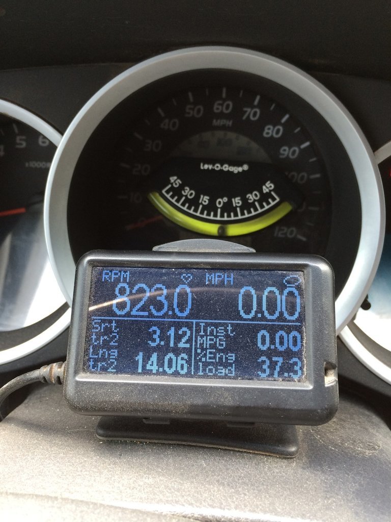

    and back to "normal"
    0984E1AD-3A17-4FE3-942F-D522ACF3C879_zps_40f460a97598536670e8d988c6a6f05471498f2f.jpg
    got a new hose coming to get that connection back to spec, but trims are back to "normal"

    and on that note...if you don't have an ultra gauge or similar device or app yet...GET ONE NOW!
    having one in this instance was a life saver
