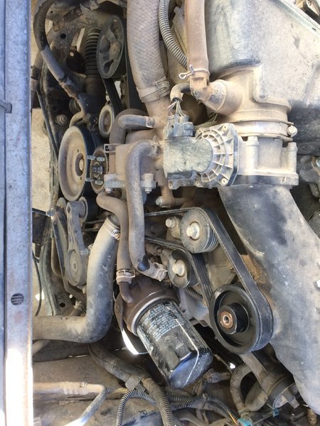

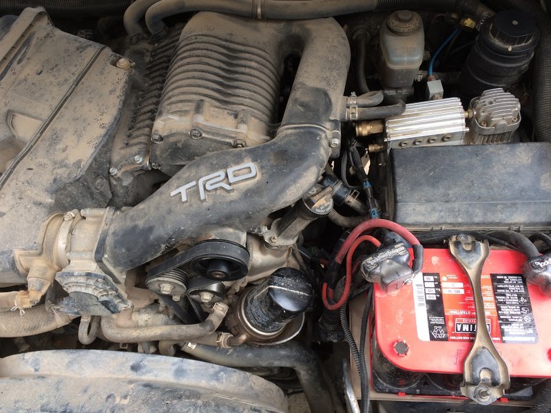

    well with the truck down for another week, i took advantage of the nice weather to finish up some projects on it while its sitting around.

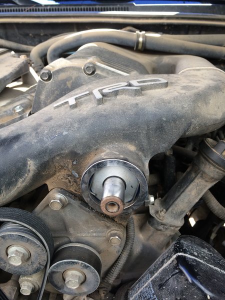

    been feeling like the OEM alternator has been having troubles keeping up with my loads, so i previously swapped my power and ground cables to and from the two batteries...finally got around to finishing up the upgrade with a 250A HO alternator and new cables alt-battery and battery-fuse box.

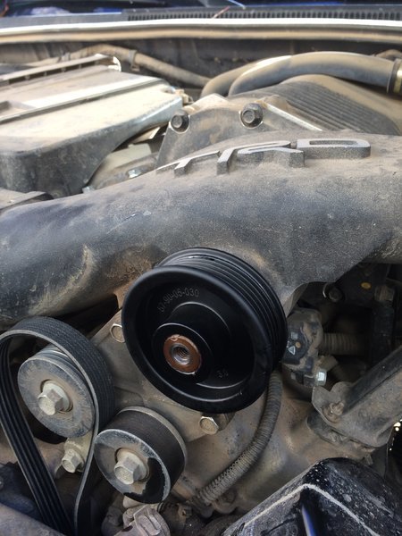

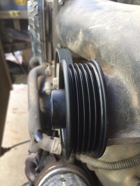

    another project i had laying around was a URD 2.85" stealth pulley. been putting it off for a while to see how the OEM performed. well the alternator job finally kicked my butt into action on that job since the SC belt had to come off anyway.

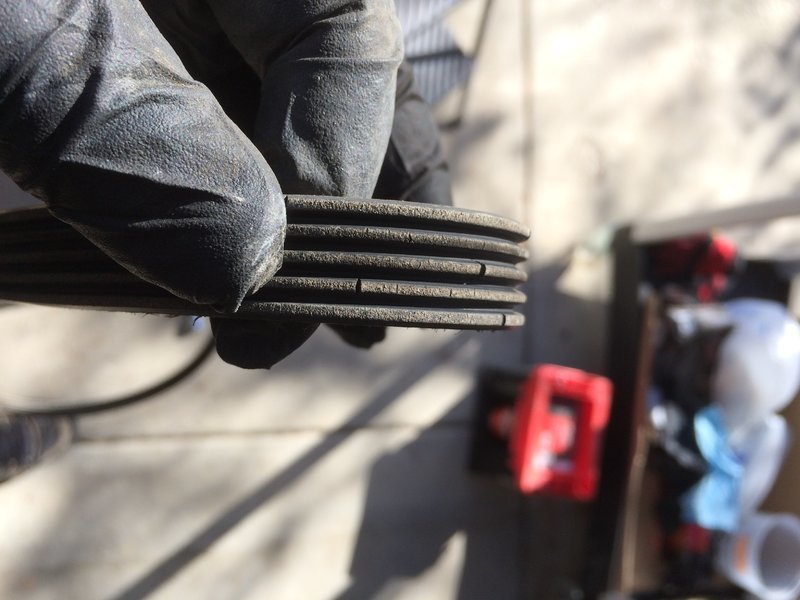

    while the SC belt and tensioner was off, i also swapped my SC belt as it was showing signs of wear.
    the hardest part of the pulley install was getting the OEM off. lots of torque to break it loose. glad the puller held up...heard bad stories on cheap ones breaking so i grabbed a 5 ton craftsman from sears for the job.
    the install had me worried. used some motor oil on the shaft, greased up the install tool, and heated up the pulley with boiling water. the new pulley actually went on without a hitch.
    flush.

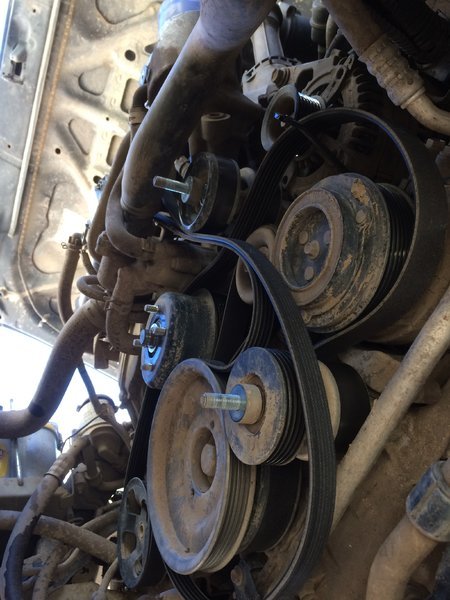

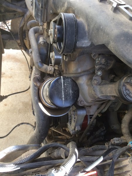

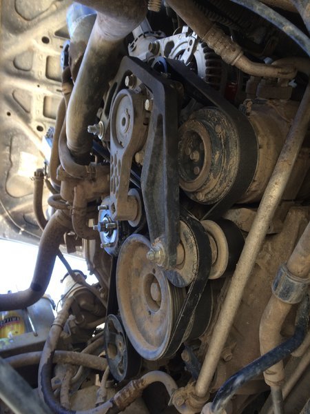

    to make the jobs easier, i did remove the fan and shroud. also to access the alternator lower bolt and to change the SC belt, the tensioner had to come off
    cracked belt
    with that job done it was onto the alternator. worst part was rewiring for the alt-battery and battery-fuse box. the alternator went on easy after the belts were off and SC tensioner out of the way.
    then reinstall belts and tensioner.
    finished the wiring and buttoned things back up.
