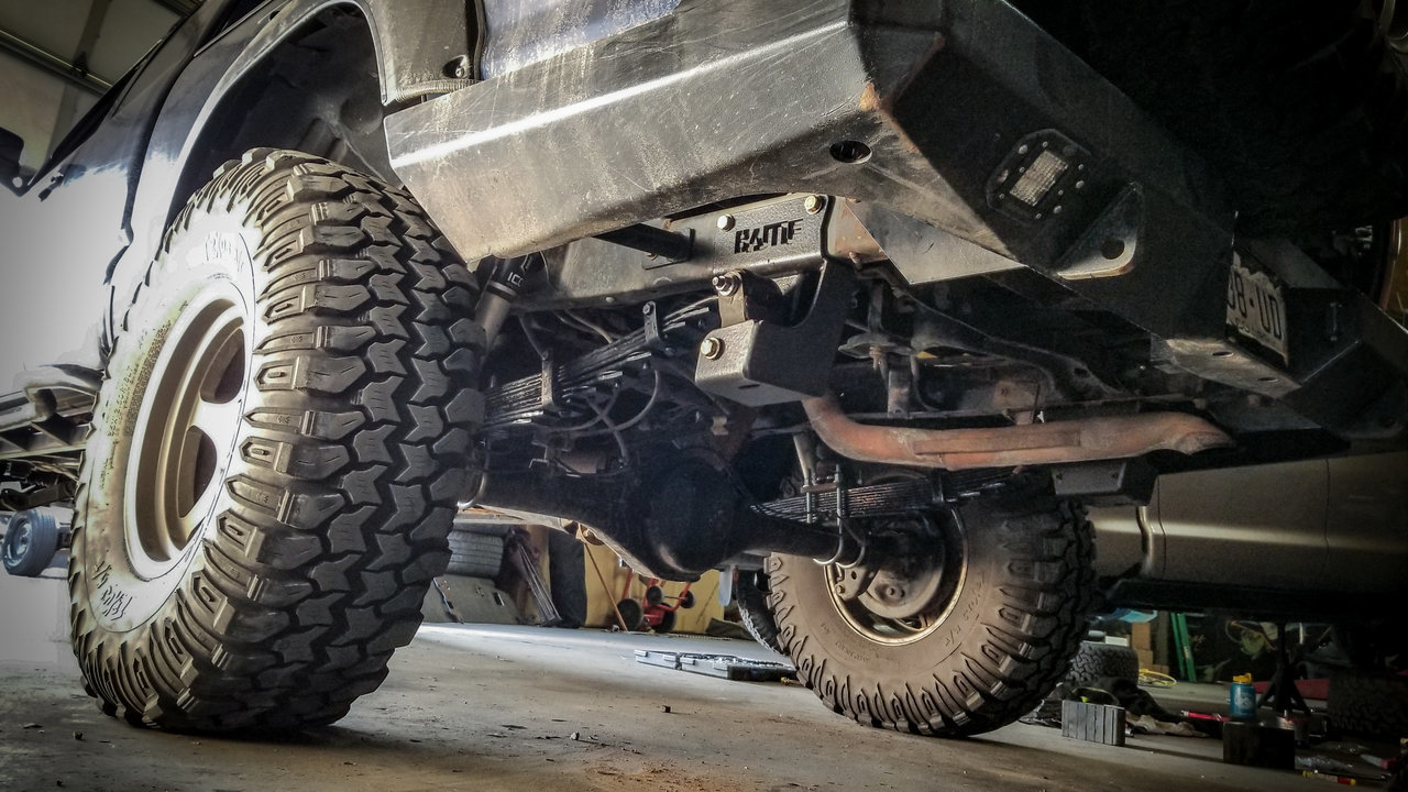

    Did a thing today
    BAMF hangers and Deaver u402 stage II
    Will be swapping to BAMF shackles when available and have a new set of shocks conning soon too...
    Happy with the stance... didn't gain much height and the ride was much better.
  13. Dec 17, 2017 at 5:01 PM
    #6473
    teamhypoxia
    teamhypoxia MichelinMan
    Aug 21, 2012
    #85247
    9,707
    Colorado
    '12 DCSB TRD OR
    Nice!
    What did you have before? Is there a geometrical advantage to the BAMF hangers?
  14. Dec 17, 2017 at 5:09 PM
    #6474
    NYCO
    NYCO [OP] go explore...
    Jul 27, 2010
    #40842
    19,126
    bOb
    Colorado
    Blue Betty - '06 TRD OR
    dents & scratches
    Had the ATO flip and Toytec leafs.
    The new hangers bring the shackles back to the OEM style with much needed strengthening
  15. Dec 17, 2017 at 7:02 PM
    #6475
    HBMurphy
    HBMurphy Ban Pending
    Jun 27, 2009
    #18993
    6,582
    Paul
    So California Coast
    09 Off Road Delete Model
    None
    Some sweetness right there. OE configuration. Much less of an opportunity for the perches to splay open. Nice. :)
  16. Dec 17, 2017 at 7:36 PM
    #6476
    SconnieHailer
    SconnieHailer PutterClutch
    Aug 26, 2012
    #85590
    9,765
    Marc
    West Central Wisconsin
    2012 TRD Off Road Double Cab V6 6Speed
    Those hangers look nice! Betty just keeps getting refined :cool:
  17. Dec 17, 2017 at 8:21 PM
    #6477
    blackradon
    blackradon Well-Known Member
    Jun 21, 2014
    #132401
    173
    james
    YEG, Canada
    2014 sky silver metallic
    You could just get a steel mid and the rest aluminum! Just an idea
  18. Dec 18, 2017 at 1:01 PM
    #6478
    Adventurous
    Adventurous Well-Known Member
    Apr 22, 2014
    #128214
    820
    Colorado
    15 DCLB SR5
    :thumbsup:
    Looking forward to having mine on, but not looking forward to the rivet removal process.
  19. Dec 18, 2017 at 1:05 PM
    #6479
    NYCO
    Jul 27, 2010
    #40842
    19,126
    bOb
    Colorado
    dents & scratches
    yup, not a fun process... luckily i already had that done so my headaches were limited to stubborn bolts and a defined shackle that is too small to fit on the leaf spring...
    having access to an air hammer will help the process when removing those rivets
  20. Dec 18, 2017 at 1:49 PM
    #6480
    zscott
    zscott Well-Known Member Vendor
    Jul 16, 2013
    #108365
    3,742
    Zach
    Utah
    13 DCSB Off-Road 4x4
    Plasma cutter helps too. I haven't done the hangers yet, but when I did the rear cross member and the stock bump stock mounts I just burned the rivets out with a torch and pounded the part off.
