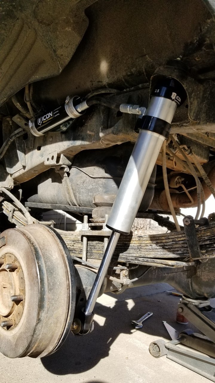

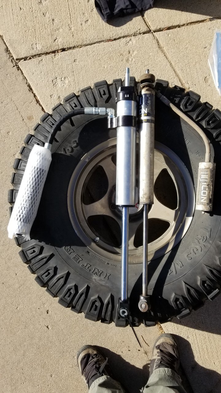

    Added some girth
    And now CDC front and rear....
    Going to convert the 2.0 to an FJ mount and transfer them over after a rebuild.

    What are the specs on those? Collapse and extended lengths?

    ordered 16.85 comp / 28.16 ext which was the last build i had done by icon...
    the body is slightly longer in the 2.5, so add .25"-.5". the exposed shaft is the same 11.25"

    Where’d you order from? Probably should have asked that before

    i got these through Toytec... 2.0 was directly from Icon
    they can get you custom builds if you request them...
