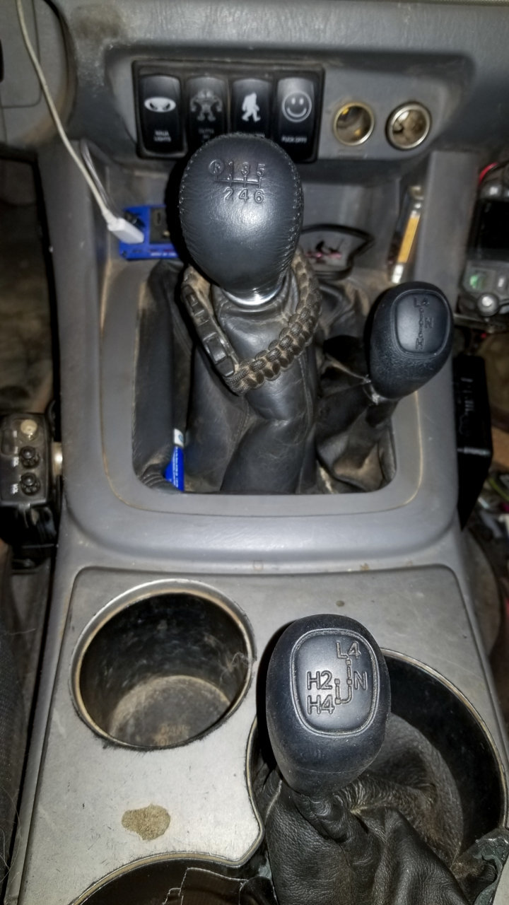

    OEM knob swap...
    Original 6speed. FJC J Pattern TCase (Auto). 01-04 Sequoia TCase.

    Oh man! I think I totally missed (or maybe forgot) about the dual sticks! What's your drive ratio in double low?

    1st gear 4.171 x FJ TCase 2.566 x Marlin 4.7 x Diffs 4.56
    229:1 compound low

    Knobs are too shiny and clean. Does not go with the rustic interior you have going there. :D

    did my best to blend the styles last week...should have a better mix now :cool:

    Where'd you get your knobs? :anonymous:

    searched ebay until i found the shift patterns i wanted... M12 x 1.25 is the thread pattern on the toyota shafts

    Thanks! I want the L N H one :D

    01-04 sequoia

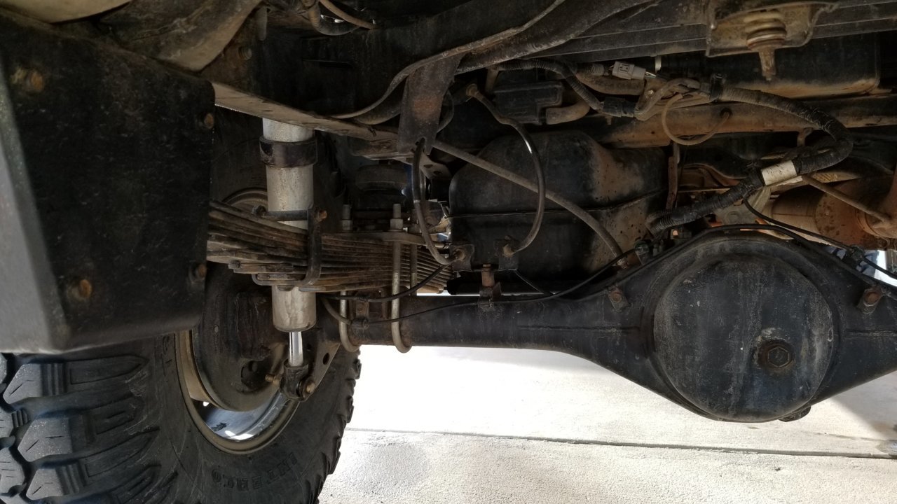

    RXT mod...
    discovered an issue with my rear shock length while driving on rocks in @jberry813 's yard...when rear tires were tucking, the shocks were fully compressing causing my shock to be the final bump. no bueno..
    with the help of @TMFF (303 Shock Services), we retrofitted some RXT lower shock mounts on to the Icons to give me some more uptravel.
    before
    after
    testing compression
    previously had zero shaft showing...much better now
    this now got the shock cycling where it should be and the shock is no longer my final bump :woot:

    @TMFF @NYCO any idea if the same eyelet could be used on a King Shock and if so how can I get my hands on a set? I have a similar issue since modifying my leaf springs to where I only have about 1/8" from where my shock bottoms out when it is at full bump. I am not using all my droop travel so If I could swap one of these in and put the extra 1" or so on the bump travel it would give me a better buffer on both ends.
    I am not sure if the shaft sizes or thread pitch varies greatly between king and icon though

    Can't use Icon rod ends but king has a few different sized rod ends. Yours standard king bolt ins? what the OAL of the rod end?
