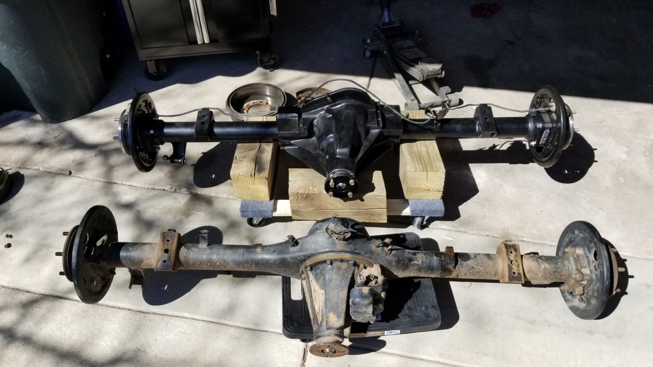

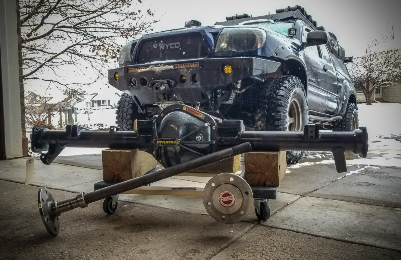

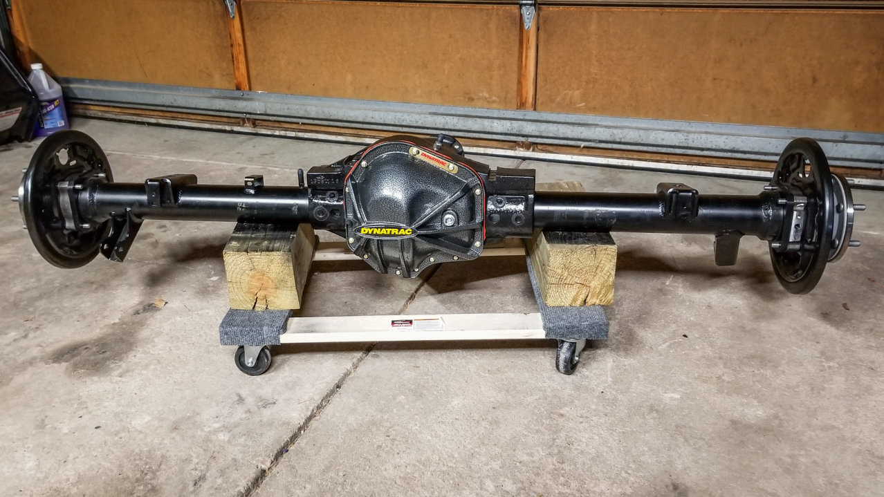

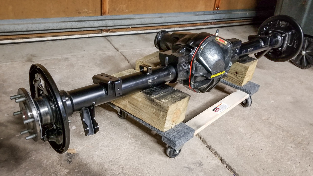

    finally making some progress on the ProRock 60...
    took a day away from boarding to get some work done on some projects. i finally got moving forward on getting the axle put together getting it ready for install. the axle comes now with only the housing and shafts. i had Dynatrac do the install of gears and ARB locker as well as their toyota flange on the pinion. there's a list of OEM parts that need to be put on the shafts before going on the axle... studs pressed in, bearing mated with the backing plate, and bearing/backing plate pressed onto the shafts...
    she's now looking like a proper axle!

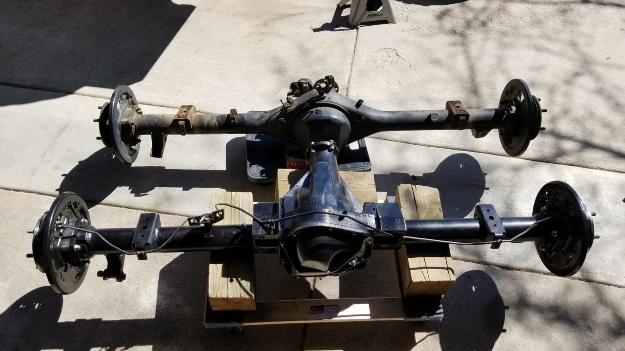

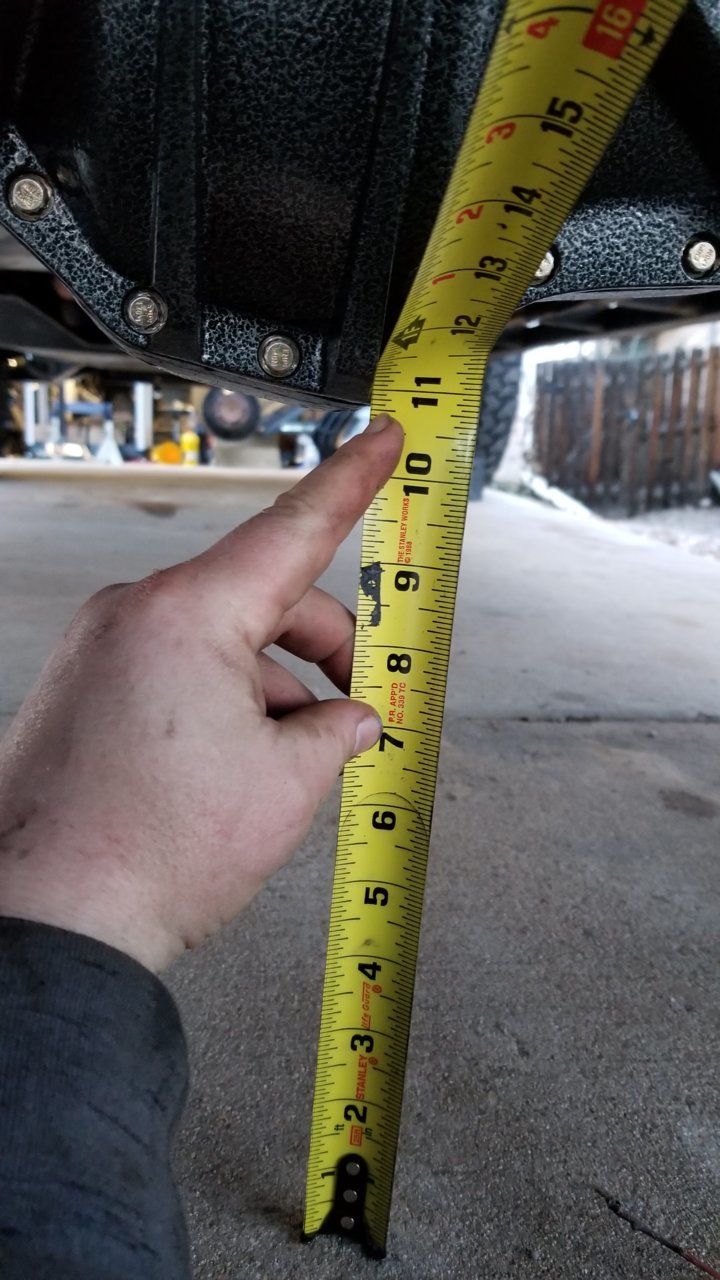

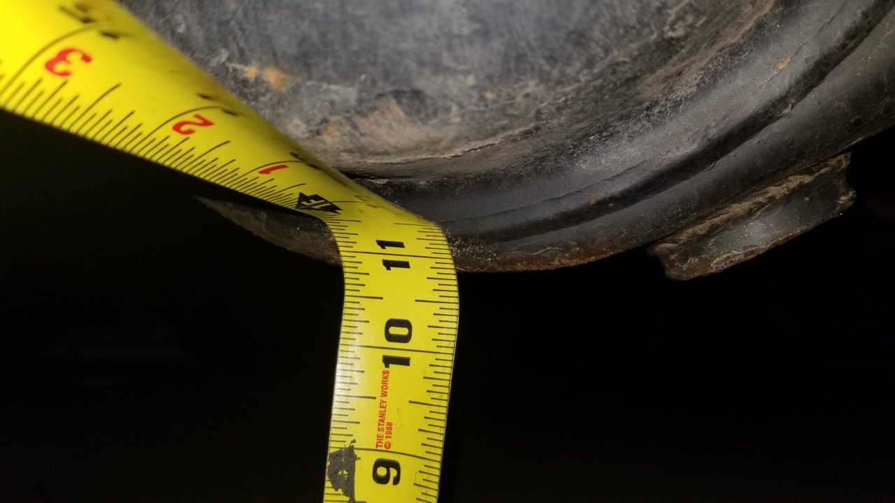

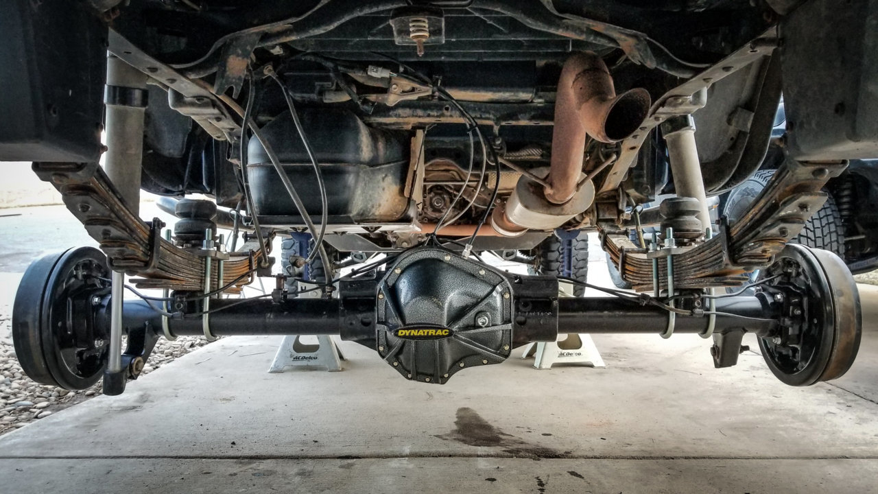

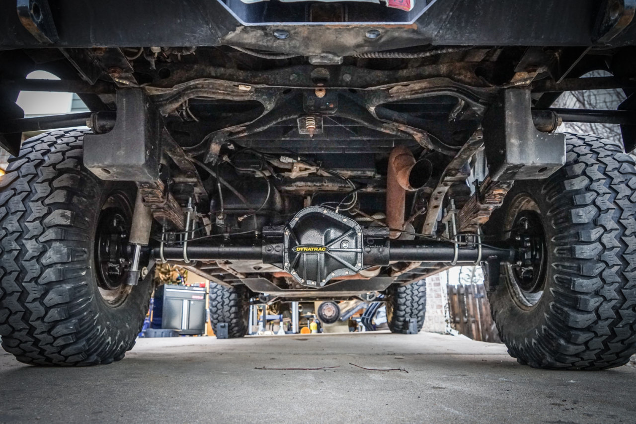

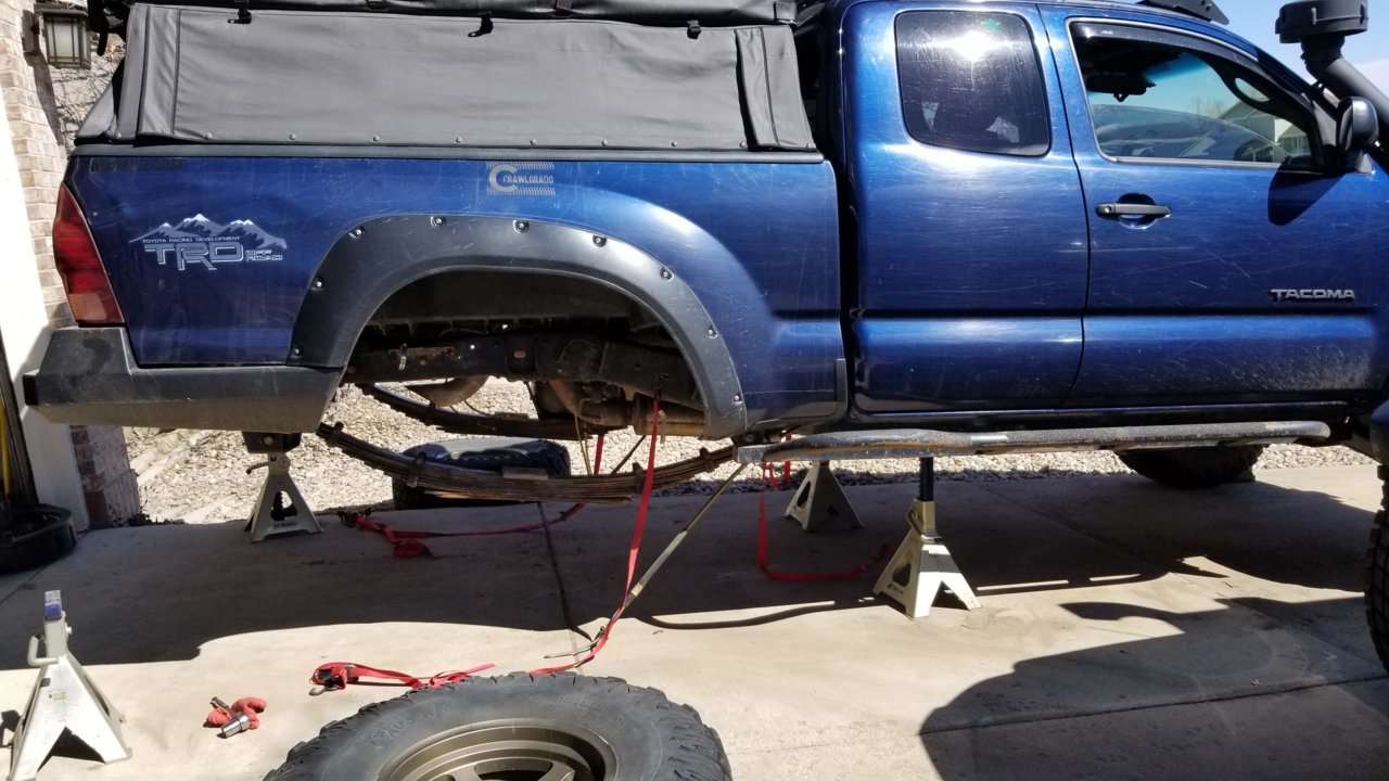

    Dynatrac ProRock60 install day! went smoothly until the end when i saw my driveshaft was 1.75" too long... getting that dropped off this week to have shortened and freshened up...
    for now, she's in and everything else is connected... brakes, sensors and air line.
    obligatory no legs shot...
    Toyota 8" vs Dynatrac ProRock60
    and surprise of the day... no clearance loss...
    ProRock
    8"
