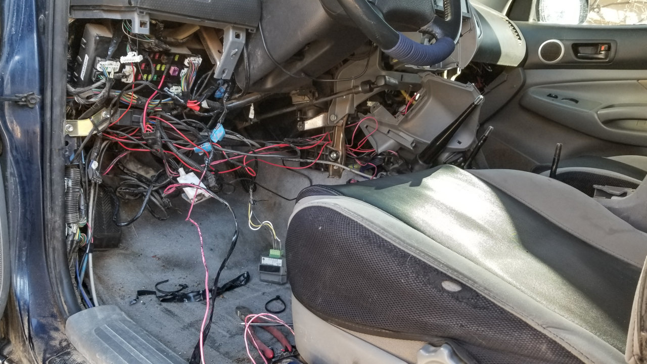

    another productive weekend on the trucks.. got my driveshaft back from Bill's Driveshaft (ended up shortening it 2") and got that installed on Saturday.. finished wiring up the rear locker and started to relocate my front locker and compressor switches...
    back in business!
    got to sort through a giant mess of wires... relocated my compressor switch from the engine bay into the truck and moved the front locker from left of the steering wheel to in front of my shifter... while in there, gutted all other wires since i'm going to a switch pro..
    new layout of awesomeness... L>R compressor, front ARB, rear ARB, ADD switch

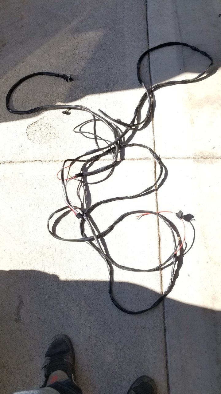

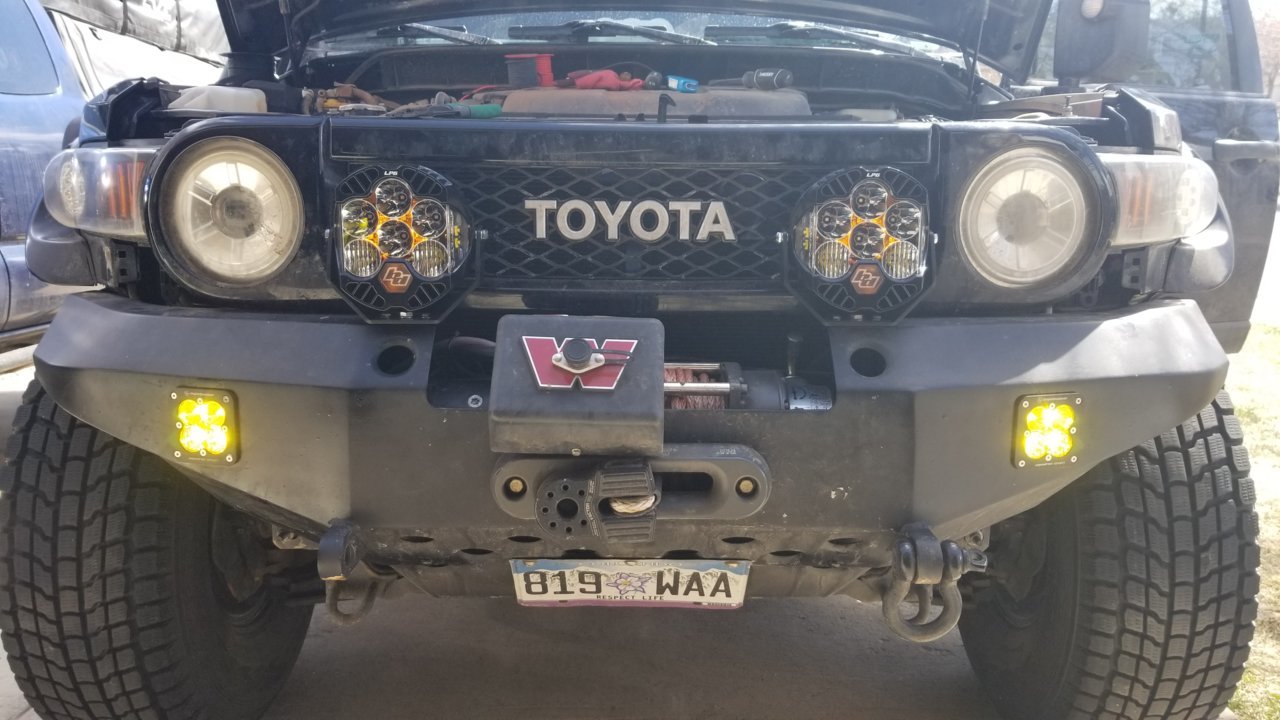

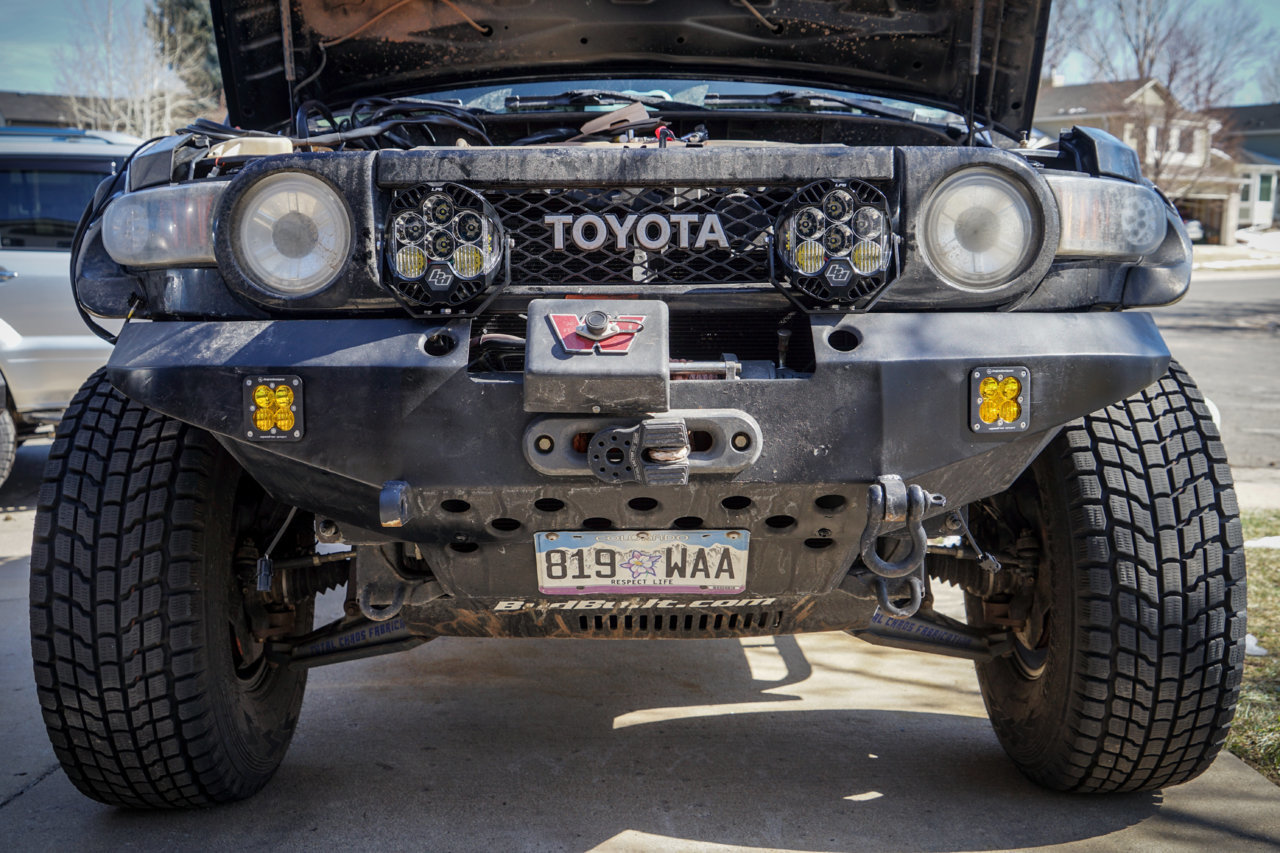

    3 weekends left to wrap up all projects... got damn close to getting both the S-Tech in the FJ and Switch Pro in the Taco hooked up this weekend... one great thing about making these changes is purging all of the old wires that have been cluttering up the trucks..

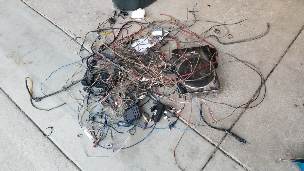

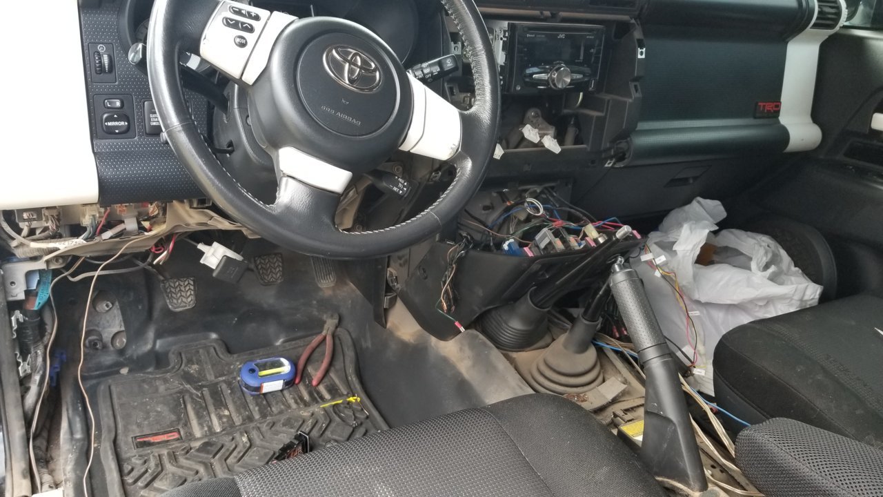

    spent my saturday afternoon cleaning out unneeded items from the FJ prepping for the S-Tech install... i have an Insane Audio headunit going in as well, so the dash remains apart for another weekend..
    crazy the amount of crap i pulled out of the FJ from the prior owner that was never being used..

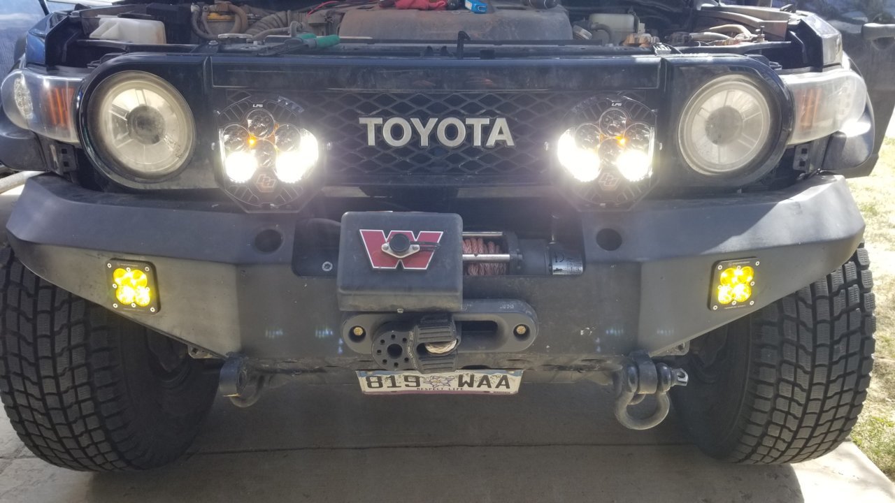

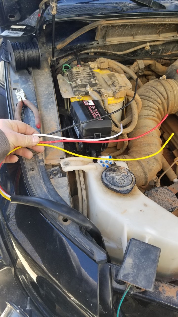

    after cleaning out old wires and removing the old rock light distribution block, i found a spot by the secondary battery to mount the S-Tech. Overall pretty straight forward install. not as fancy as the Switch Pro, but pretty simple. run a wire inside for the switch panel, wire to a add-a-fuse to an ignition source, ground and power... there are six butt ends ready to go that you put your desired output in and clamp down. i have a blue seas fuse block still there which i use to run all the accessory grounds too...
    next up was getting some shit wired up.. first up LP6.. .step one, cut off 80% of the harness
    step two, figure out which wire does what... black = ground, yellow = connect to marker lights to control amber backlighting, red = low output, white = high output

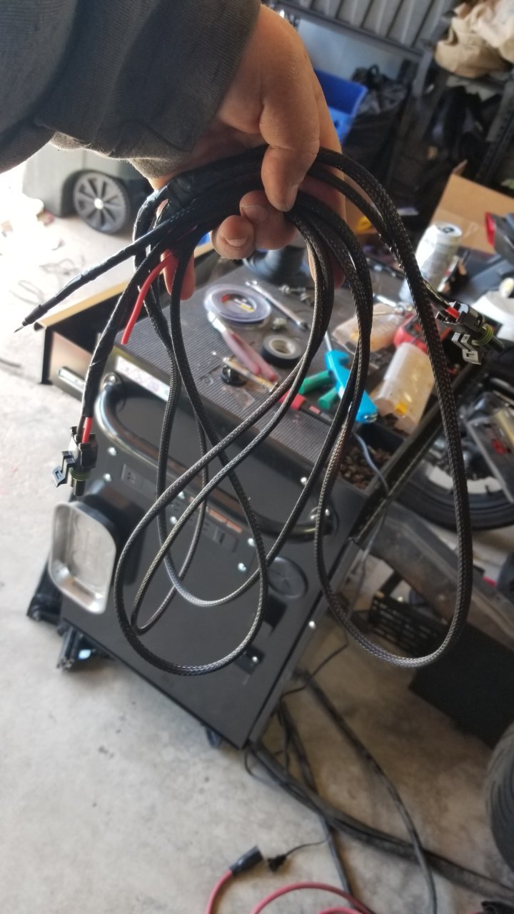

    the baja designs squadrons took a little extra effort since there was no harness made. they include plugs to connect to the lights, so i made my own harness...
    and the results....
    squadrons with LP6 ambers
    squadrons with LP6 lows
    squadrons with LP6 highs
    can't wait to get this in the desert and see what they can really do!!!

    it comes with a double throw switch...one for high and one for low.
    i cut that all off since we're running the S-Tech in the FJ... so we'll have one button for high and one for low. the key is DO NOT HAVE BOTH ON AT THE SAME TIME! so if you do a switch pro or similar setup, you need to get that in your head to turn one off before turning the other on.. the switch pro has a double throw option built in where you can have two outputs function where the both can't be on which would be great for those lights.
    yellow wire for the ambers is tapped into the marker light/running lights.
    it was a great feeling getting rid of all the wires between the two trucks...i really wish they had this when i first started.. it's a big reason why i waited to get any additional lights on the FJ for so long... waiting to pick a route like this and do it clean. all of the old wiring was from the prior owner...

    when you use the high setting, the low goes on... but if you have power going to both wires, you can mess up the internal circuit..
    look at the pics above, you can see the high has all lights on.
    @Gramps knows a bit more about what happens when you do that.. since he did it

    I don't know why they don't put something on the board to not let it overload by mistake. Cool thing is they warranted it. Sent my LP9s back and they put new boards in them and sent th back to me.
