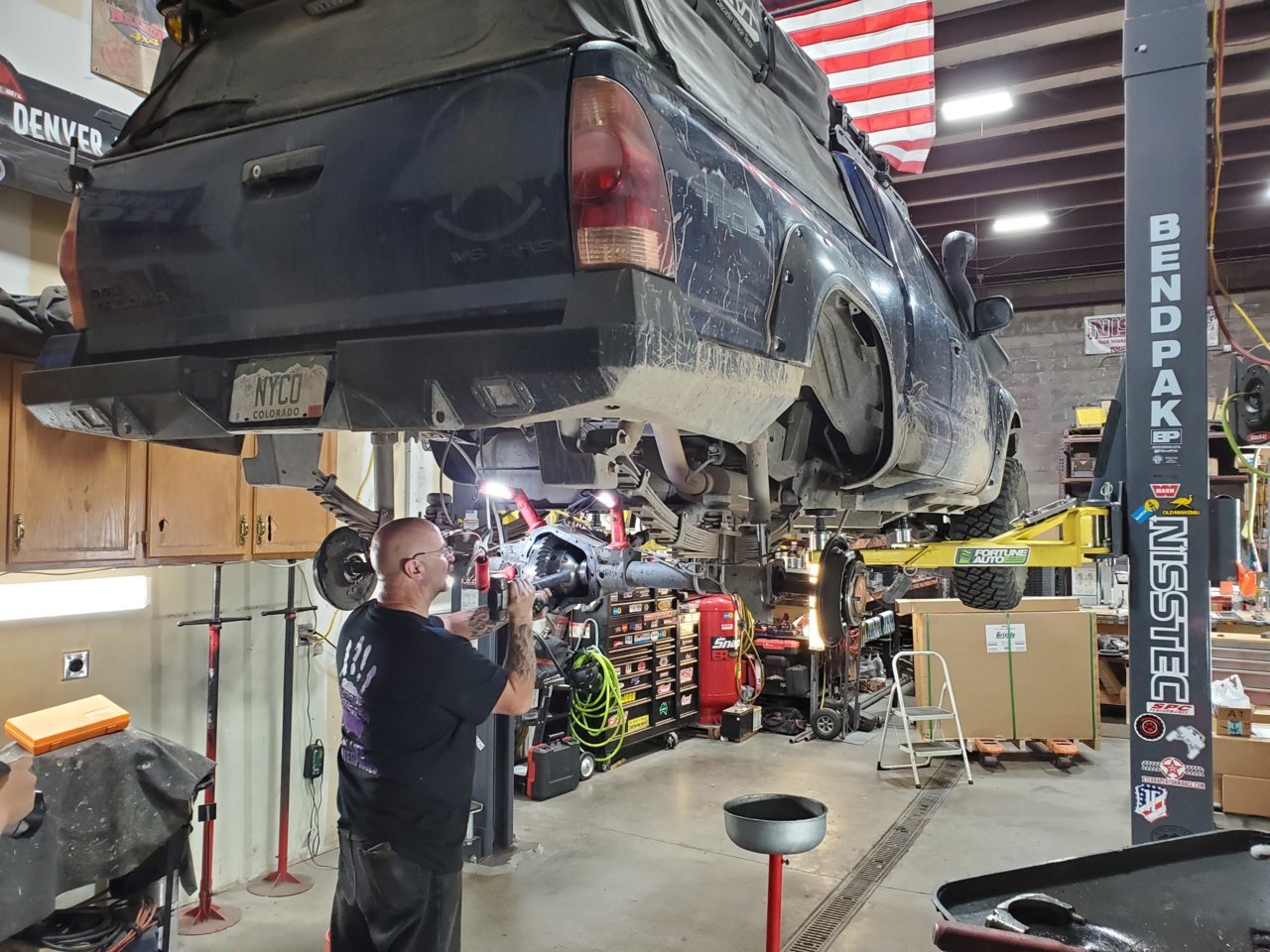

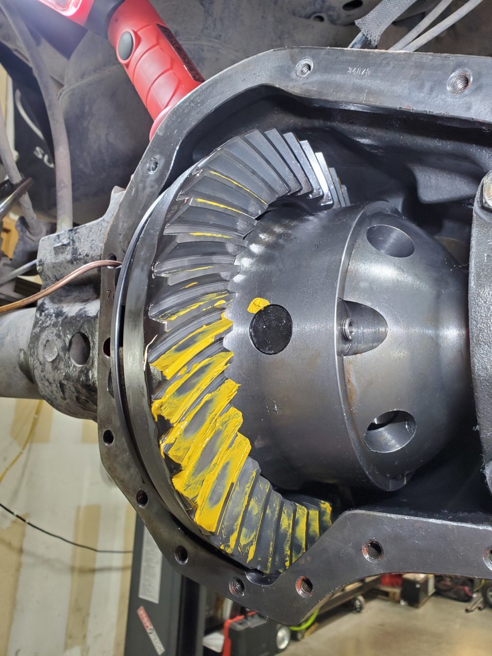

    after waiting too long to get my arb locker fixed.. finally got a little help from our friends at Nisstec and their gear guy Brian. Brian has lots of knowledge in dana axles and was willing to help me get my bonded seal replaced and ensure my gears were still setup right... while in there, we saw the seal housing spun and was pinched against the carrier bearing caps. we also noticed that the seal housing did not sit down far enough with the shims in place where they should be, so we had to do some crafty assembly to put the shims on the outside to allow the housing to sit better creating a better seal for the seal housing o-rings.. fun..
    with the bonded seal dumping shit ton of air into the housing, it of course blew out my axle seals as well.. so we had to swap out the brand new seals for some new ones while we had the axle apart...
    lots of headaches caused by a failed seal from ARB, but everything is back together and going to test it out this weekend to make sure she's ready to go again...

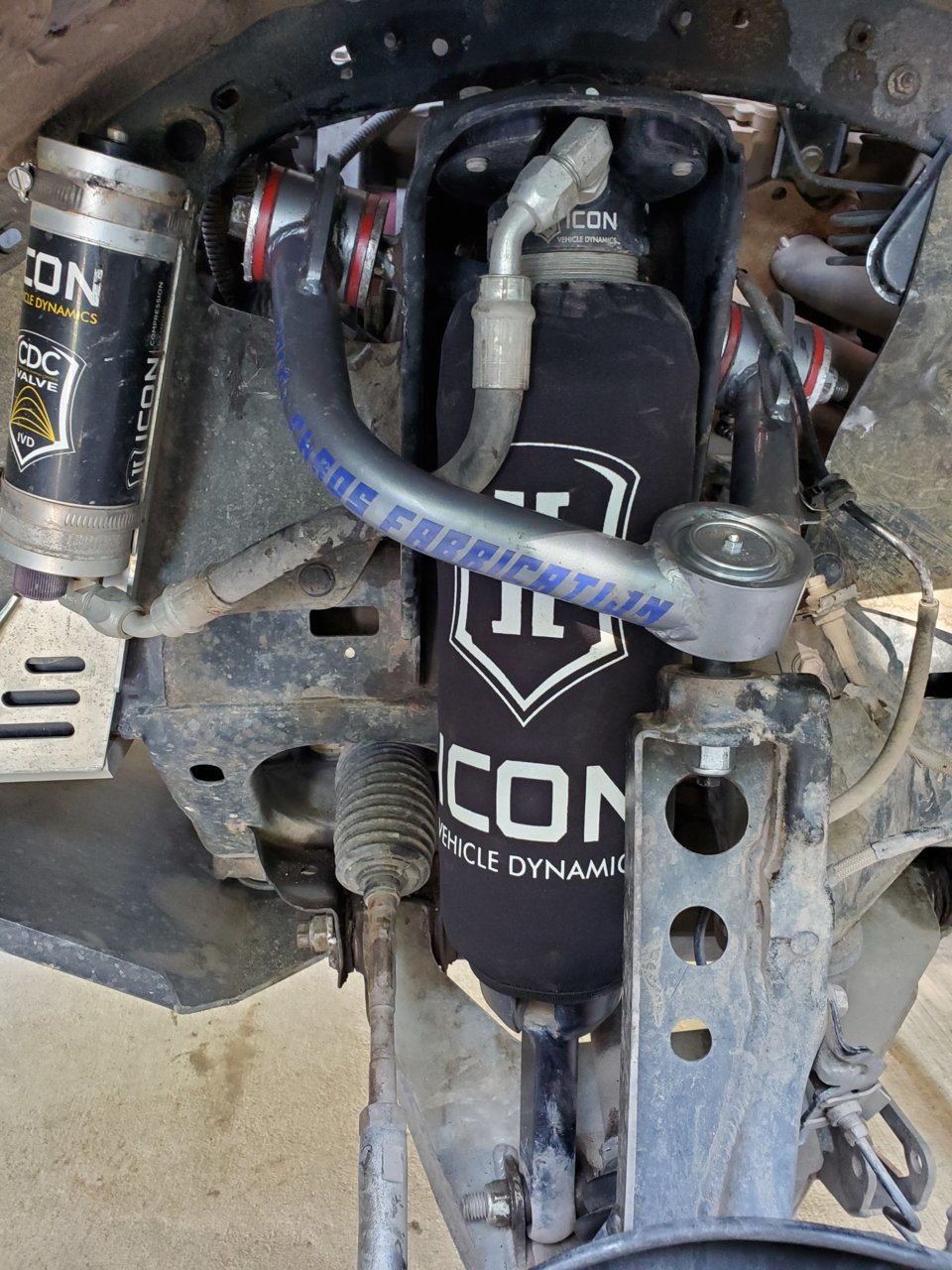

    Retrofit Delta Joints installed the the TC uppers... also added some coilover covers before winter shows up.
    Process wasn't bad. Need to get creative for a press tool since the taper bolt gets in way. Saved some money not buying the Icon tool and using a technique from Jace using a ball joint kit press tool and a washer as a spacer.
    Looking forward to no more squeaks from the uca. Greasing suggested every 3,000 miles.

    Granted it’s after the fact, but there “tool” is 1.75” dom tube with a cap...
    and I use 1.75” tube for sliders

    exactly... why spend money on that when you can look around for something you have and make it work. i don't have 1.75" dom laying around the garage, but the ball joint kit i have has something that works. what i didn't have was a nice spacer so it can clear the taper bolt. spacer worked like a charm.
