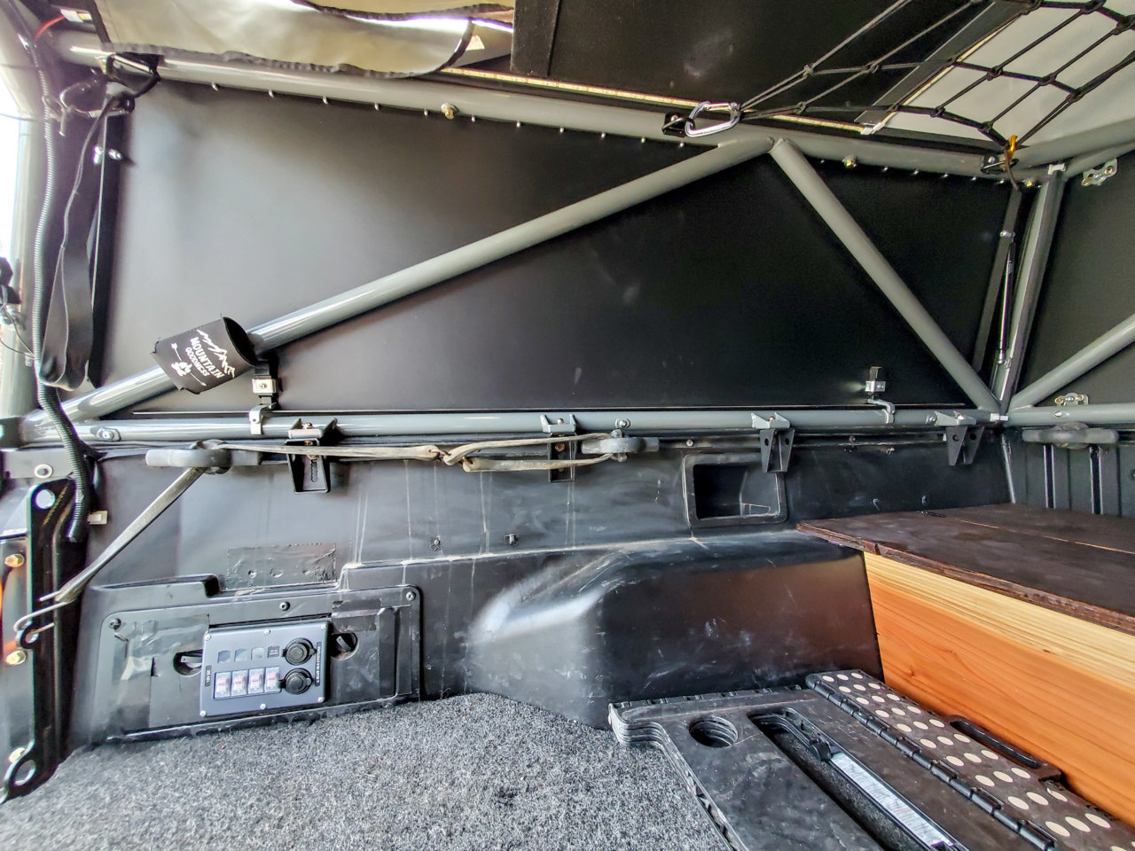

    got some work done in the camper this weekend... wanted a storage option for my jack, spare parts, recovery gear and other small items. the storage will also double as a dog bed at night for one of the doggos. big dog will most likely be on the floor where there should be more space.
    redwood baseboard and stained pine top.
    split the front lids to allow easier access in case i have items on top. added a couple magnets to help keep the lids closed while bouncing around.
    baseboard is easily removable with a couple of pins. allows for more space if needed as well as easy access for larger items i wanted to store like our propane firepit and toilet that might be tougher to get in the main opening. the magnets also help to keep the baseboard lined up since the pins do allow for rotational movement.
    next up is to figure out how i want to have power in the bed then wire up the camper lights and fan. also need to mount the fridge.

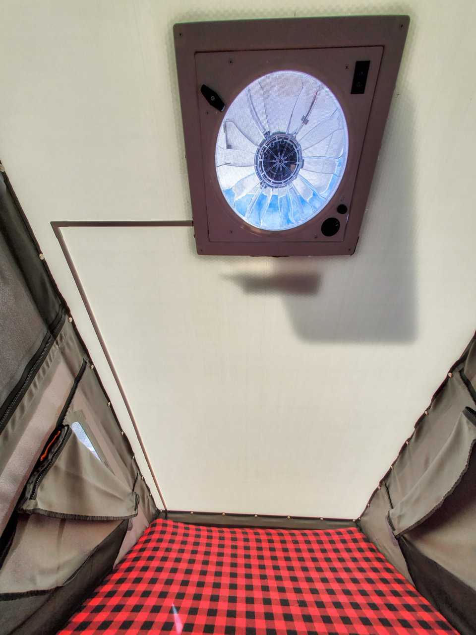

    another small update from the weekend too... swapped out the fan cover to a flat lid to save a couple inches of clearance. talked with dometic and they were able to warranty me a different lid since there was not an option to get the flat lid at purchase. it comes with the flat lid (i chose to go with white vs the smoked) and a new lever that needs to be installed since the slide track is different between the flat lid and the domed lid.

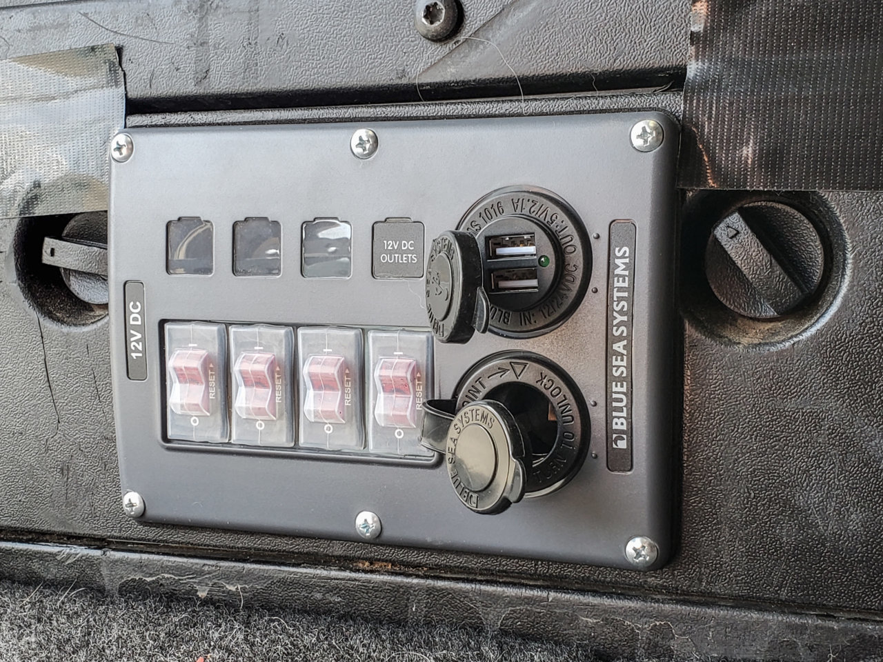

    guess there is some benefit to the stay at home orders... finished up wiring up the Dometic fantastic fan during lunch break..
    i have the fan going into my blue seas power bank which also is used to turn power to the bed lights and my hatch light. there's 2 usb ports as well as a cig lighter port. i still have some sealing to do behind the panel so i haven't final mounted it yet, so it's being held in with gorilla tape now :D
