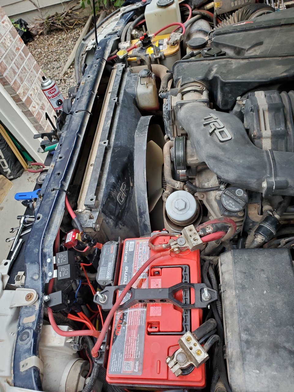

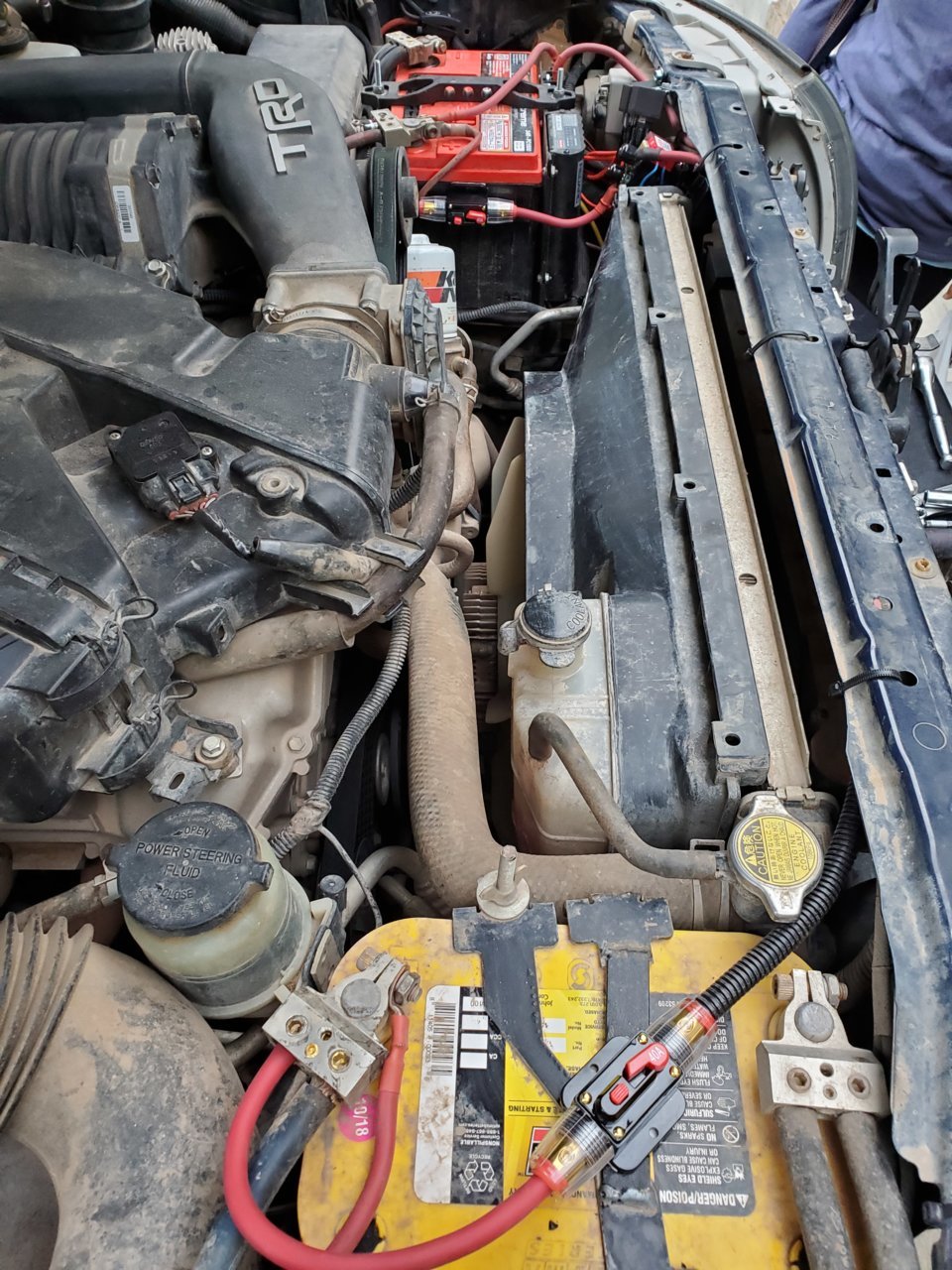

    Interesting. I had seen that before, but that seems to be a lot of relays for the setup. I did see this from Redarc https://www.redarc.com.au/bcdc-dual-with-jump-start-feature-the-ultimate-battery-setup which foregoes the relays.
    I'm looking at getting the Cascadia hood mount solar setup and doing something similar. I really wanted to charge the primary battery with it but seems like it would do more harm than good. Using it direct to the Redarc would keep my aux in good shape and allow a bypass jump if really needed. I'd just love a simpler way to maintain my primary AGM as opposed to unhooking it every time to trickle charge it. How do you maintain your primary AGM?

    I wonder if that allows a back charge to the start battery when the truck is off...
    It looks like the SB is setup normal where it overflows from the start to the house when full... that won't allow for any flow from the house to the start when it's full..
    Look at the orientation of the SB in that diagram vs the one I used... and note, the one I attached was provided by Redarc as well.
    That's the main reason why I did that setup.

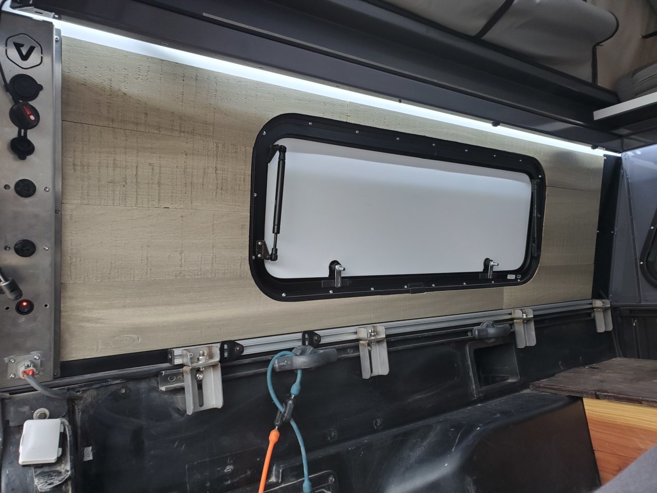

    Finally getting a little time to start back up with some camper projects... adding some peal and stick wood planks inside..

    Did you come up with that clamping system?

    did not... new design vagabond was working on. this is iggy's old camper where he was testing it out... now i get to continue to test.

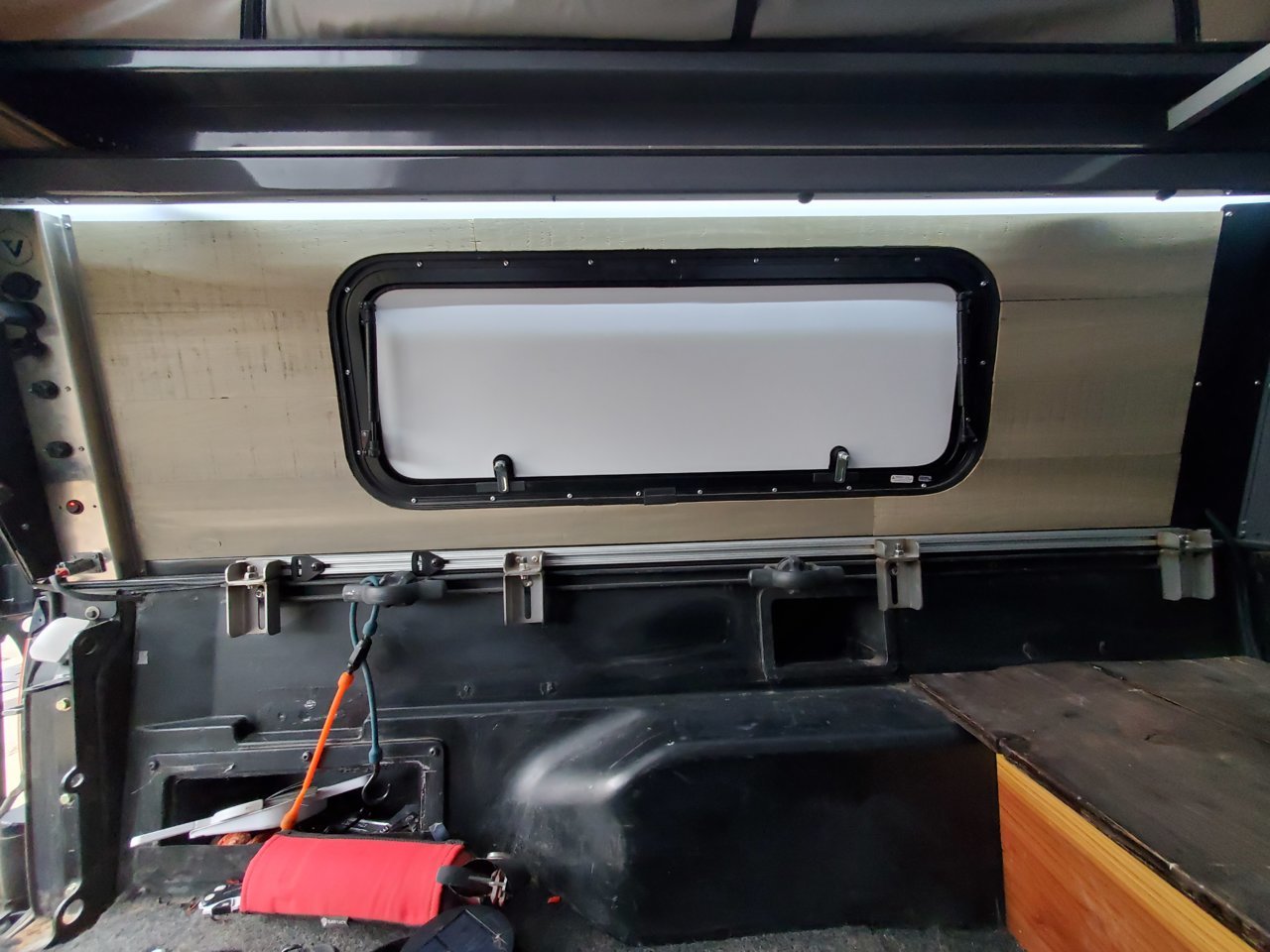

    Walls complete... learned some good tricks on the first side.. second side much easier.
    I was going to fill the top with some excess I have but I kinda like that white strip... adds some glow to the light

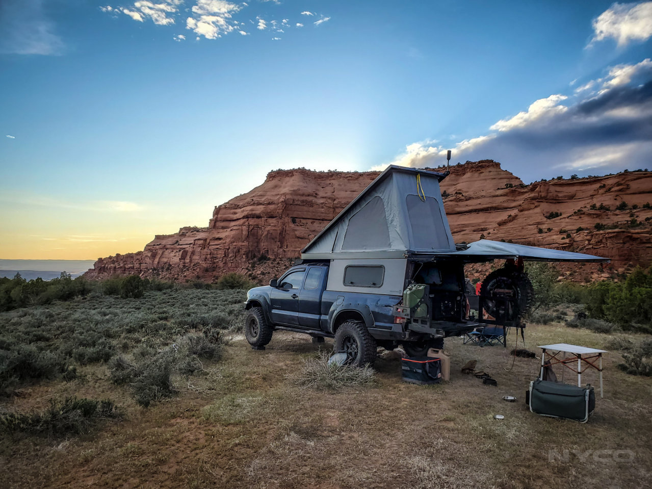

  15. May 3, 2021 at 12:09 PM
    #6855
    NYCO
    NYCO [OP] go explore...
    Jul 27, 2010
    #40842
    19,126
    bOb
    Colorado
    Blue Betty - '06 TRD OR
    dents & scratches
    Went exploring. Got the FJC out too. Great times. Much needed..
