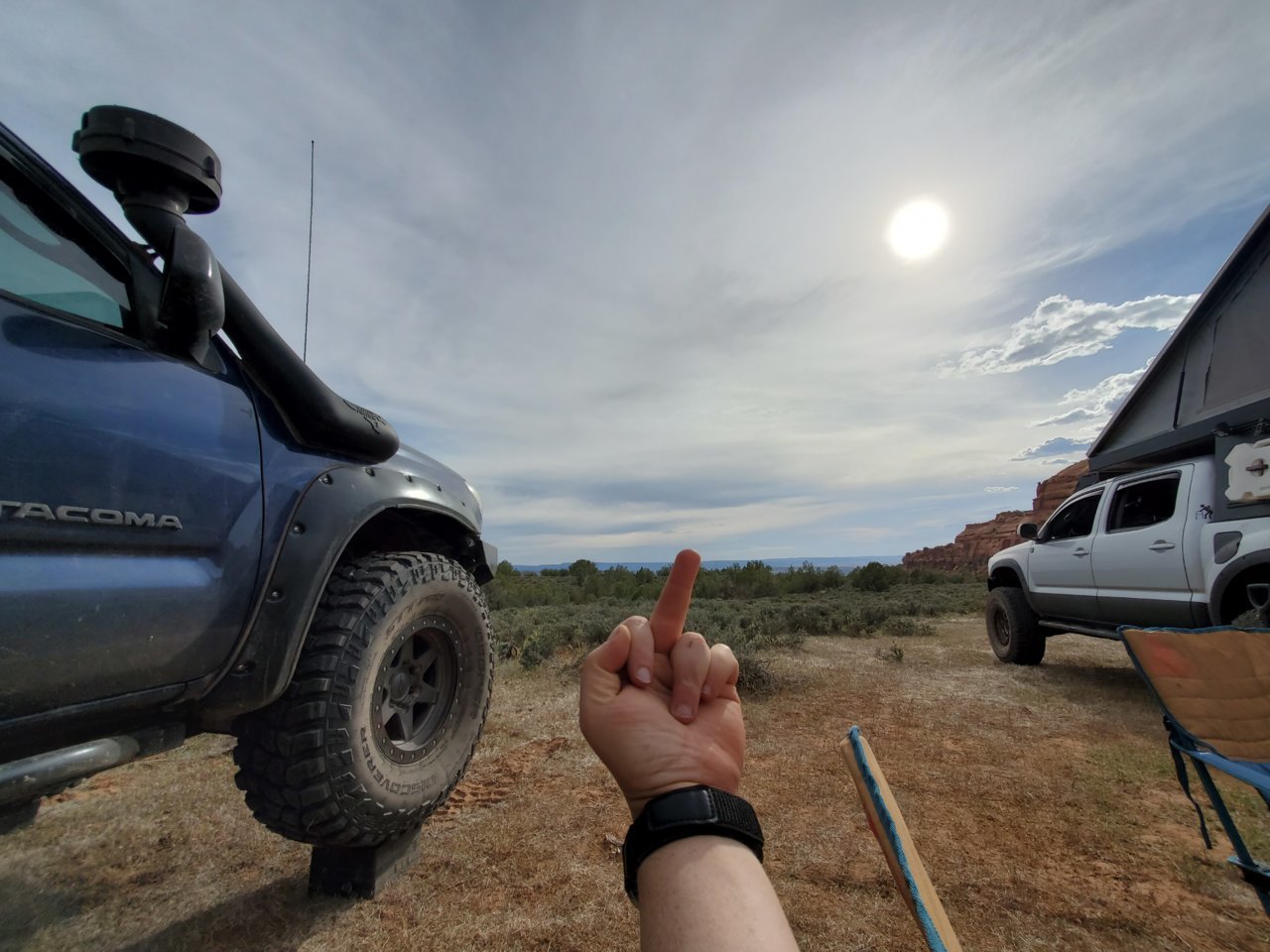

    I see you flexing on that rock. I am about to dive back into the world of Toyotas again :eek: I am on a wait list for a '22 Pro T4R...

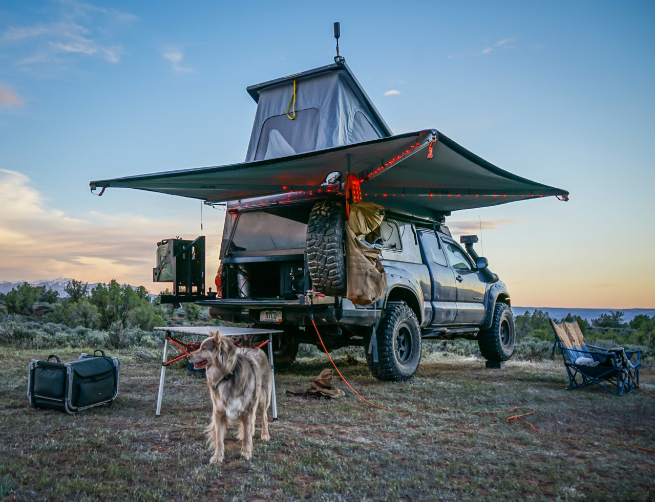

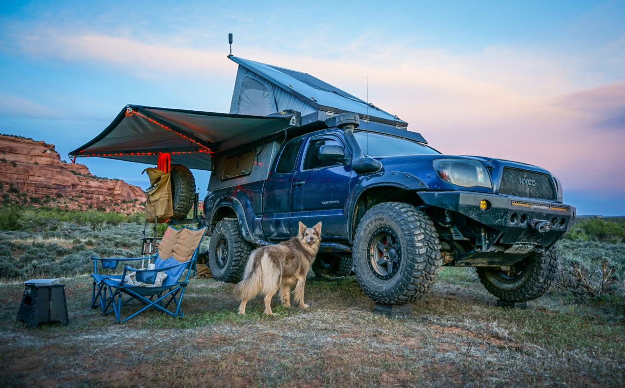

    How you liking the Alu-Cab awning? I'm considering the same one! did you get it local?

    great awning. got it with the camper. it's easy to setup and put away. well built and holds up to winds very well.
