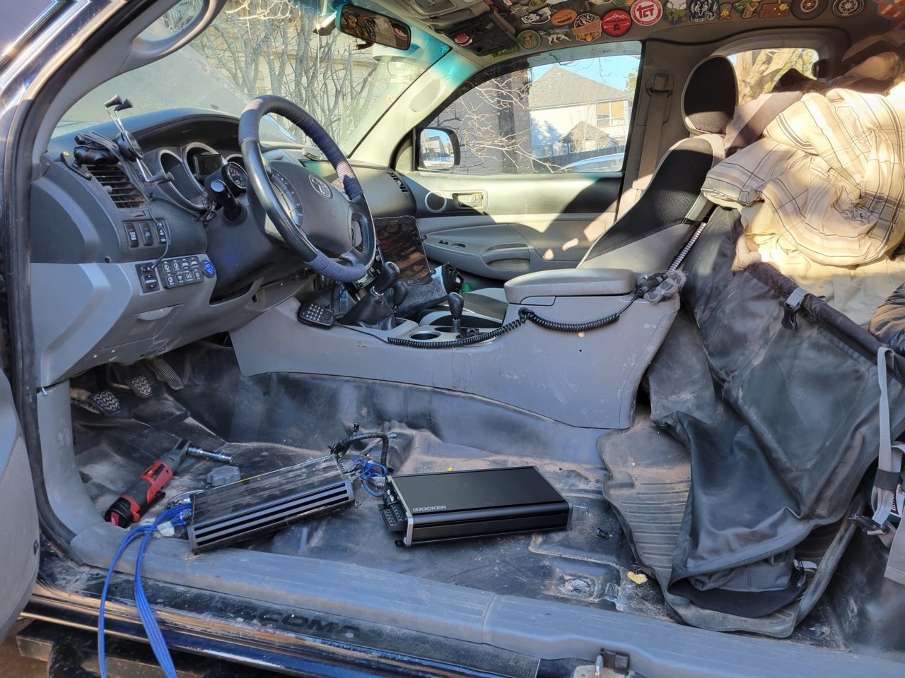

    Thanks. Just finished up with a new sound setup. New polk speakers F&R, 5 channel kicker amp and added a couple 8" subs.
    Next projects revolve around the camper. Water tank and pump setup, new storage and platform setup, then going to work on getting a diesel heater setup in there... never ends lol!

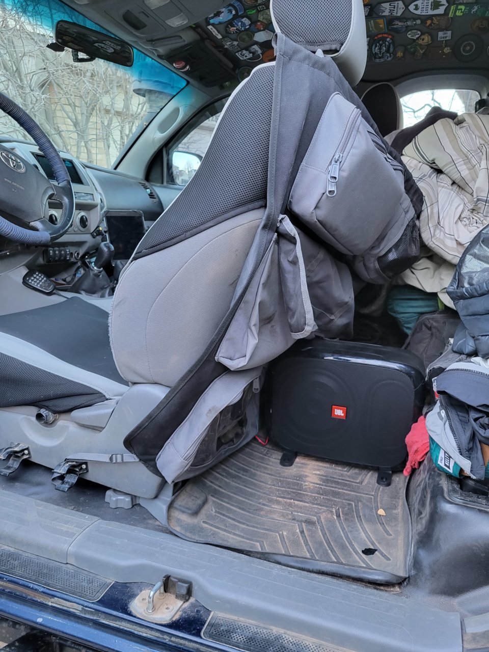

    where did you mount the subs? would like to see those

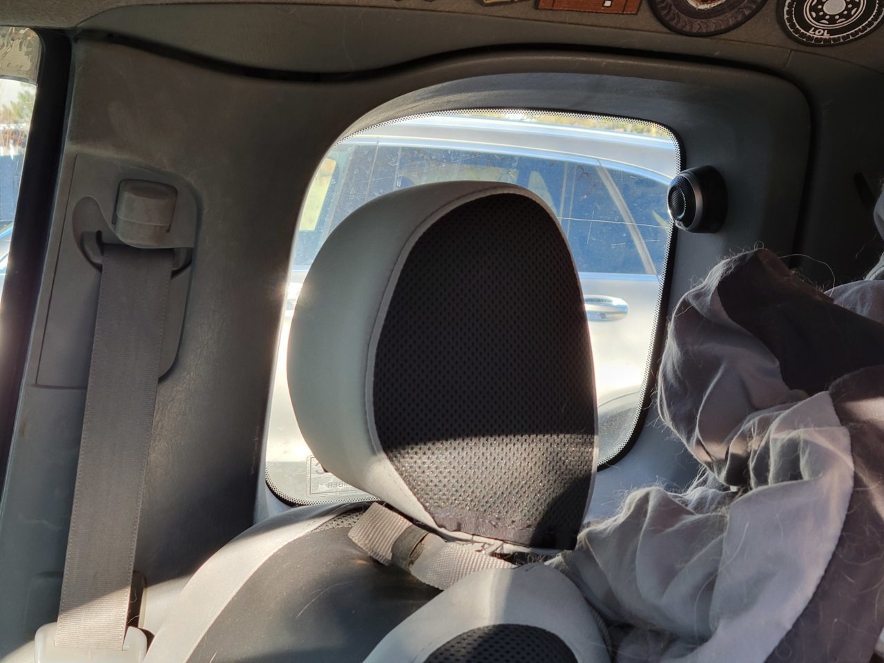

    Nothing fancy but it helps add a little bump. JBL Fuse
    Then start packing shit around them
    They're fully buried now under my normal stuff behind the seats. They're wired in parallel off one sub channel.
    You can also put them together and use vertically.. took up too much space tho so i ran separate and flat.
    Amp is under the driver seat

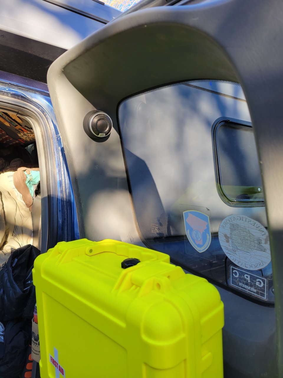

    Added compnent speakers to the rears so i put the tweets in the window area facing toward the humans heads vs by the doggos

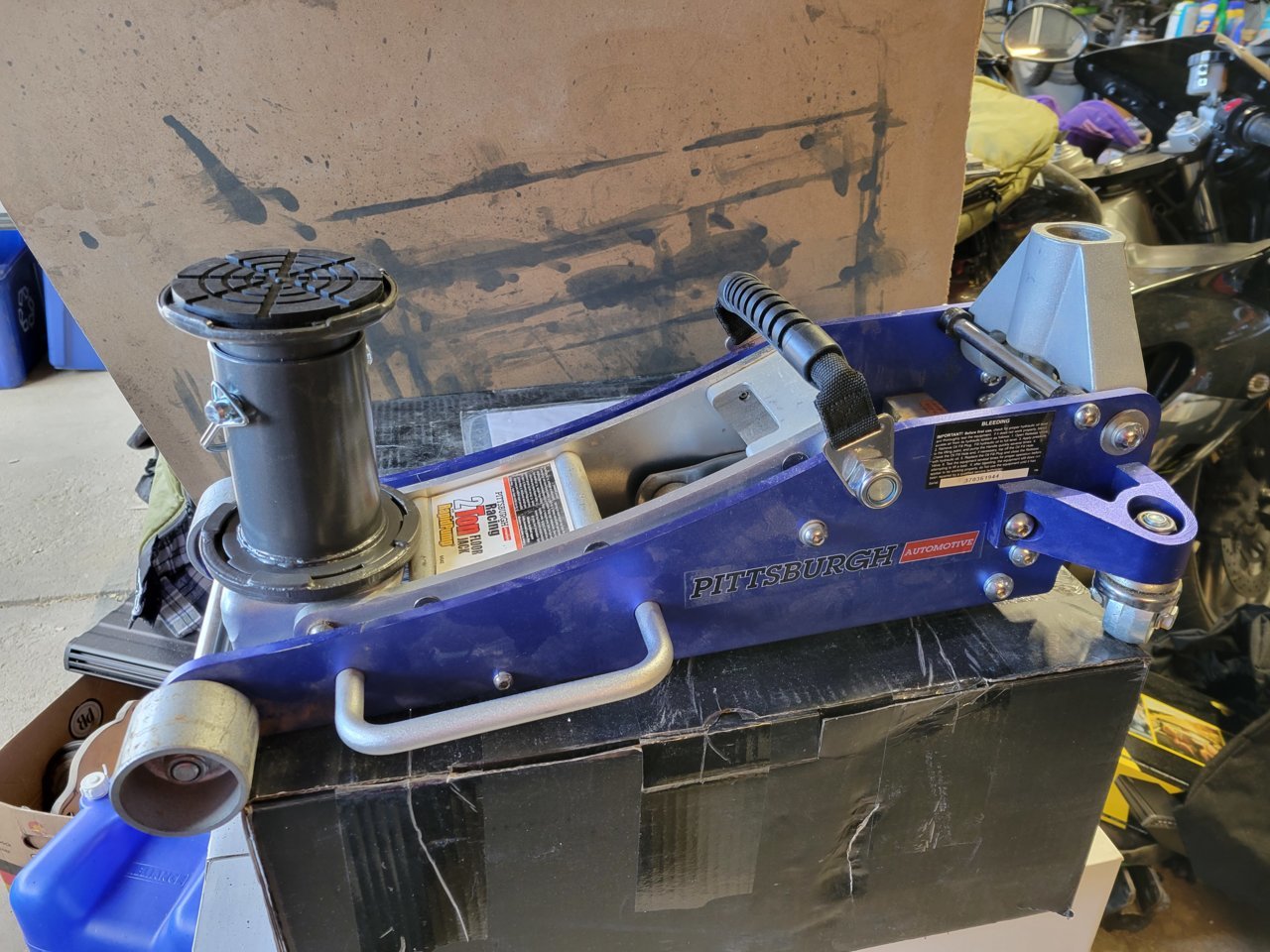

    Some projects in progress but i did get this knocked out today.. took some modifications, but my HF jack has some Pro Eagle flare..
    Lift pad hole needs to be enlarged along with the holes on the handle to fit.. extension is the 8" version.

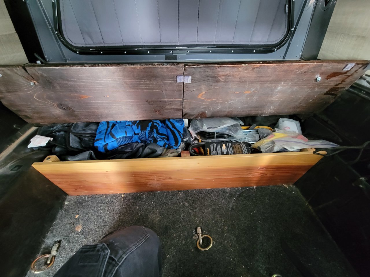

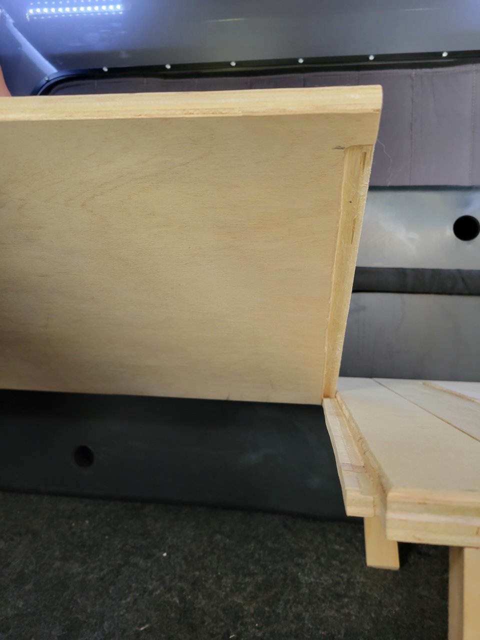

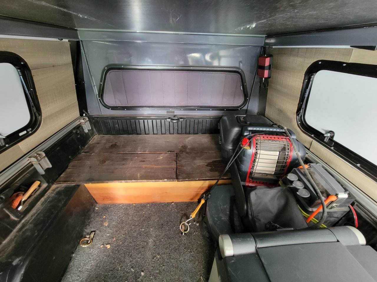

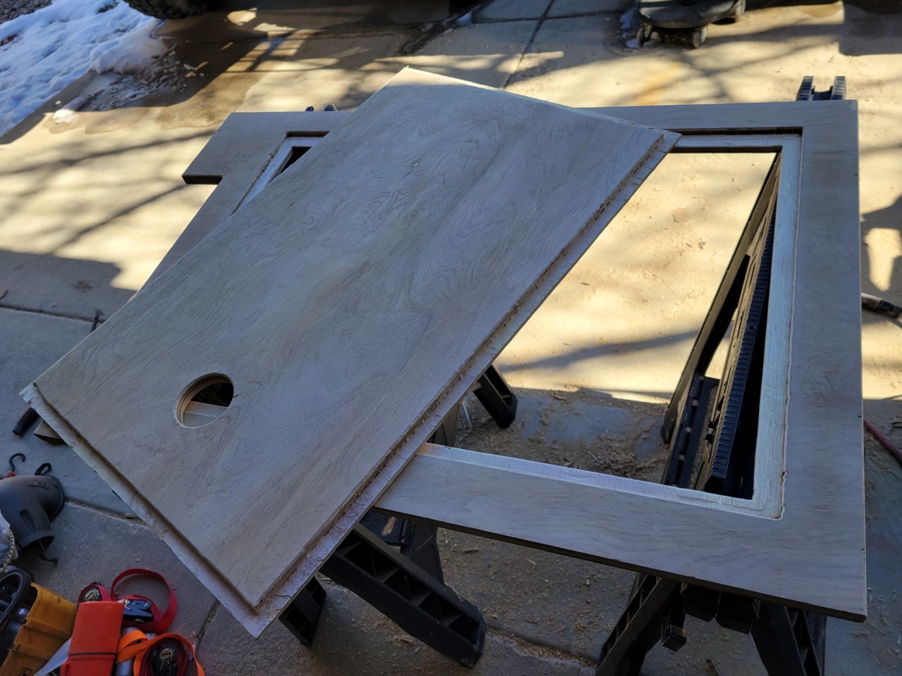

    nearly wrapped up new storage/platform and water system in the camper...
    Before:
    gutted:
    Progress:
    Water pump and hoses ran and insulated:
    how it sits with the fridge in place:
    still have a few tweaks to make on the water system, then start organizing to see if this will work as planned.

    Killer. What's the blue cylinder inline after the pump, heater?

    RV Filter, Used to fill RV's and get the chlorine taste out of the water.

    this\/ inline filter..going to change the location of a bit now that i'm seeing how everything is going to lay out in there..

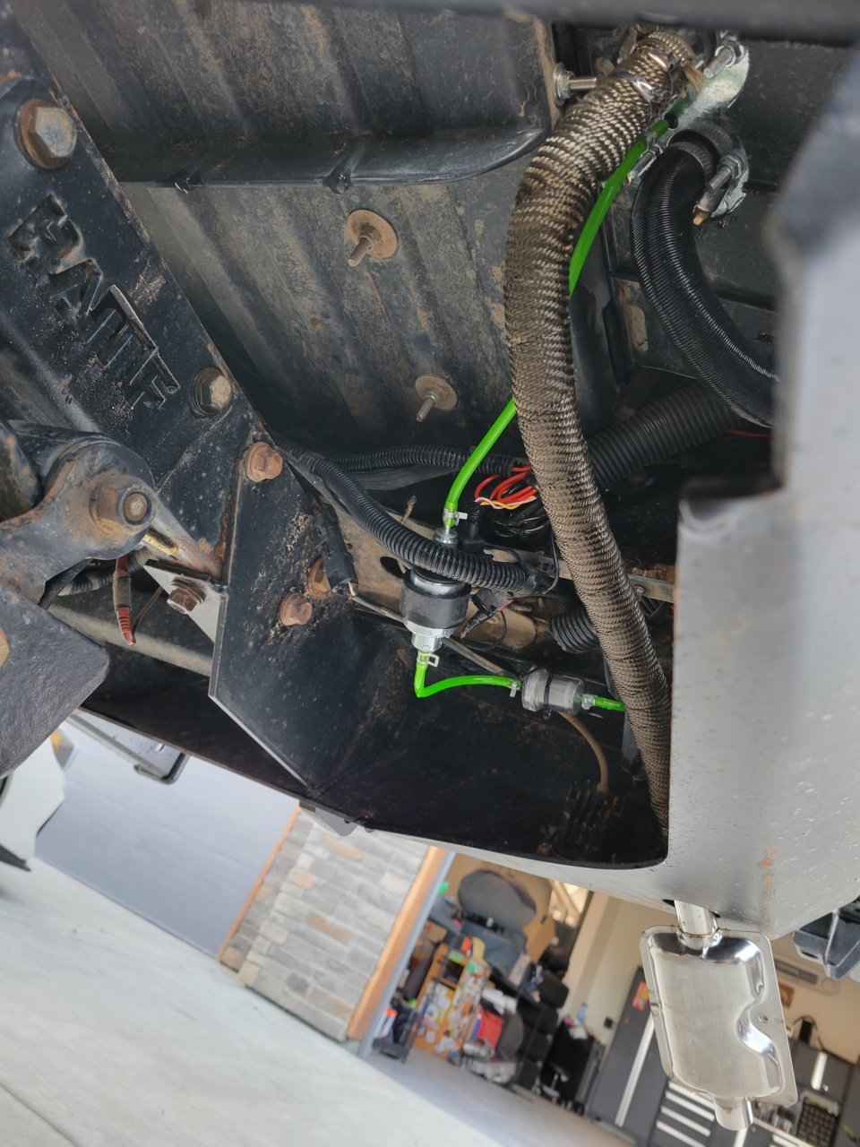

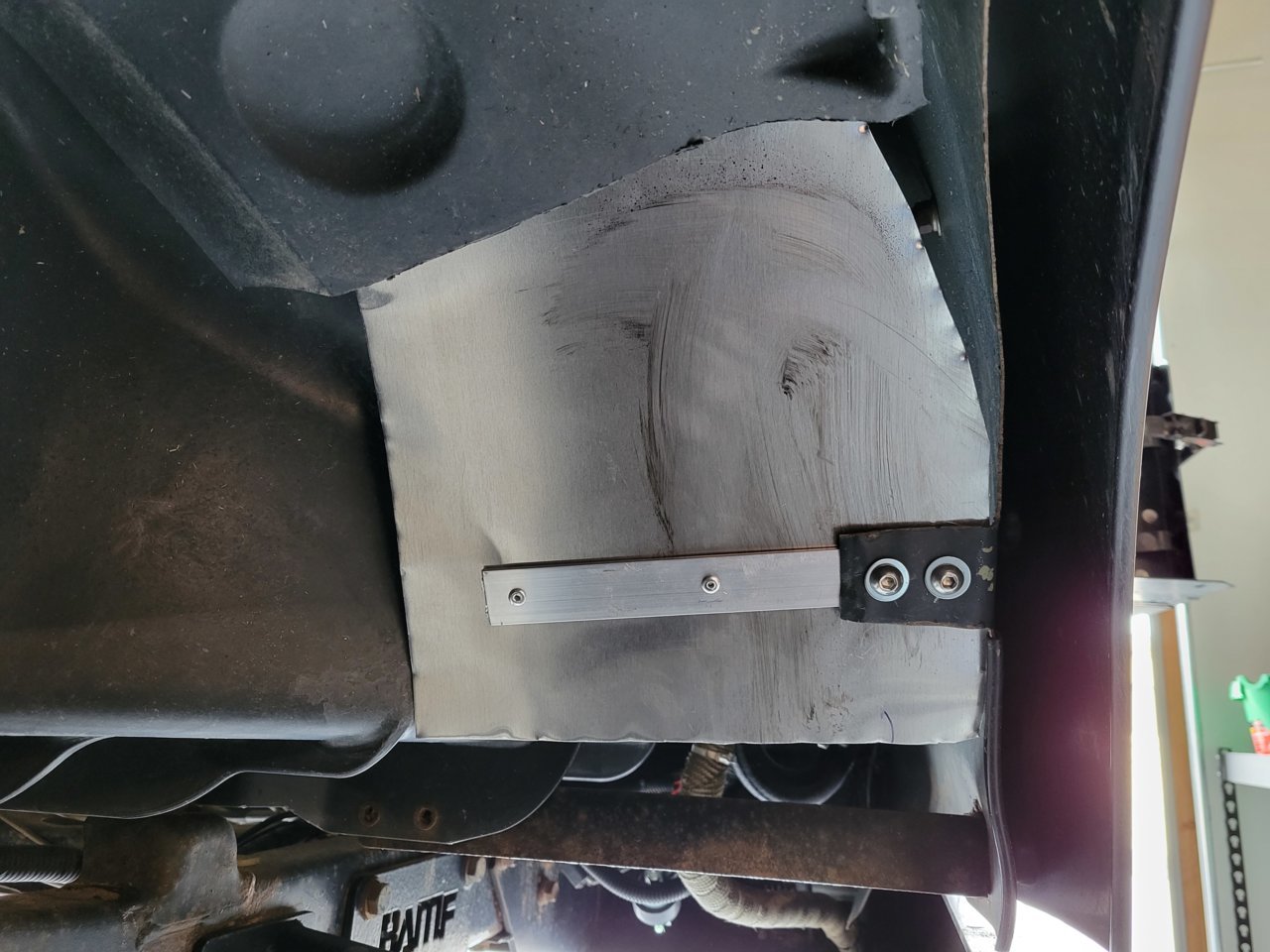

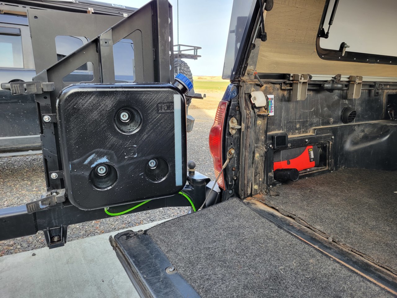

    Wrapped up the initial install of a 2kw diesel heater on the truck. Gave it a shakedown this weekend and worked great. Some tweaking still to do, but overall project worked out as planned.
    muffler comes off when not in use...
    little bit of protection over the hose coming into the camper.. i'll be adding some more to cover the fuel pump as well.

    so far biggest issue with the setup is the fuel tank... the nipple at the bottom is not the best at sealing and the tank venting when wheeling still gets some leakage.
    problems to fix:
    1. Find a better tank solution that won't leak while offroading
    2. Configure for easy removal for non-cold weather camping, or ways to cap off fuel system and cover system
    finishing setup for V1:
    1. Cover heater/cubby partially to hide system better
    2. Finish up "skid plate"
