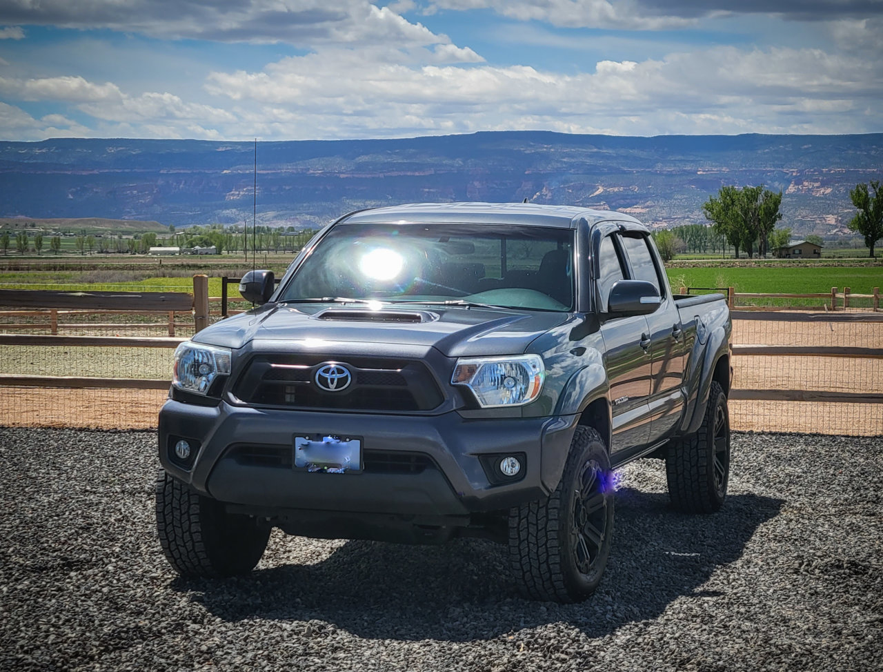

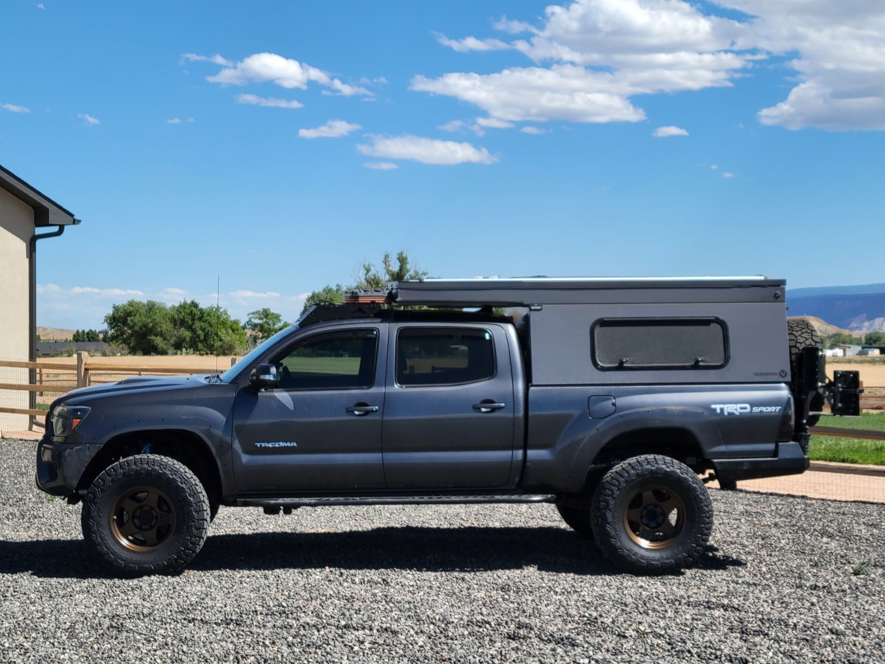

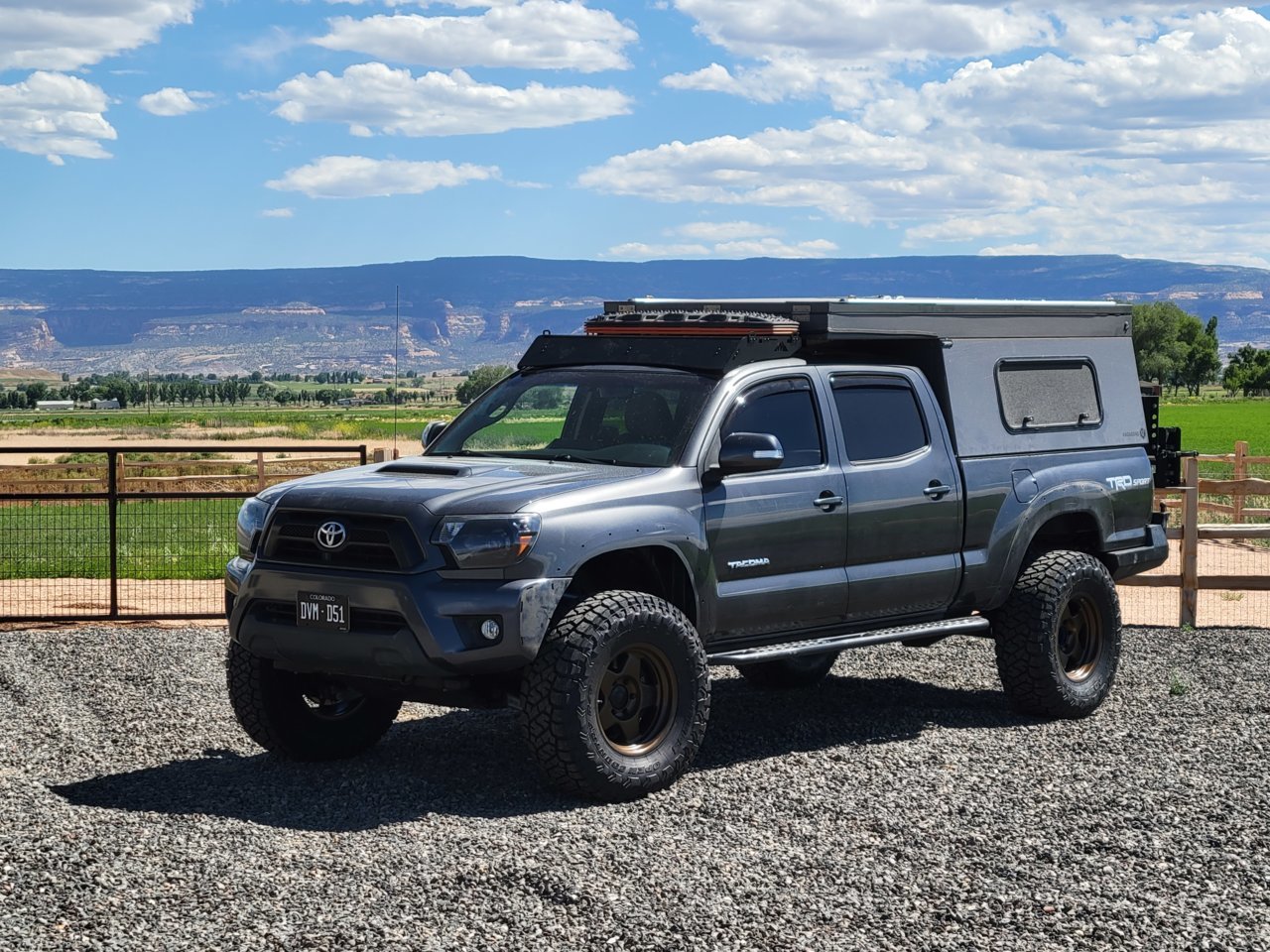

    Updates... Betty is still going strong..
    But with frame issues and approaching 300k on the clock, I've started the process of building V2 racecamper.... meet Maggie
    2015 TRD Sport, only 56k on the clock and a clean frame!
    Adventure rig will transition over this year and Betty will transition back to being a wheeler.

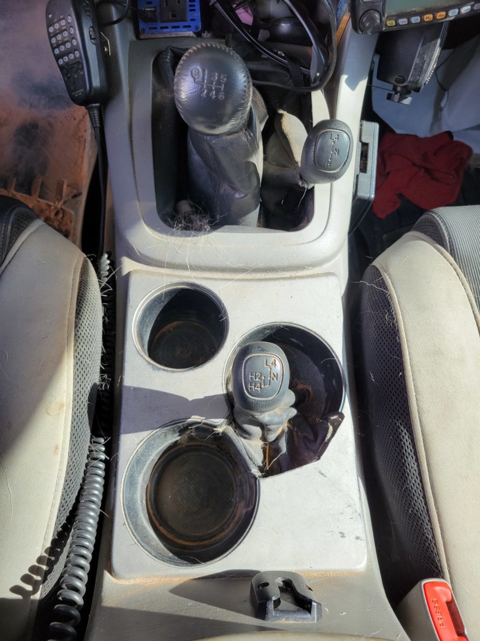

    Yea that's much cleaner

    my god the dog hair lol

    You should have seen the clumps of hair i pulled out before the photo

    I still had Cooper hair in the Taco before I sold it haha

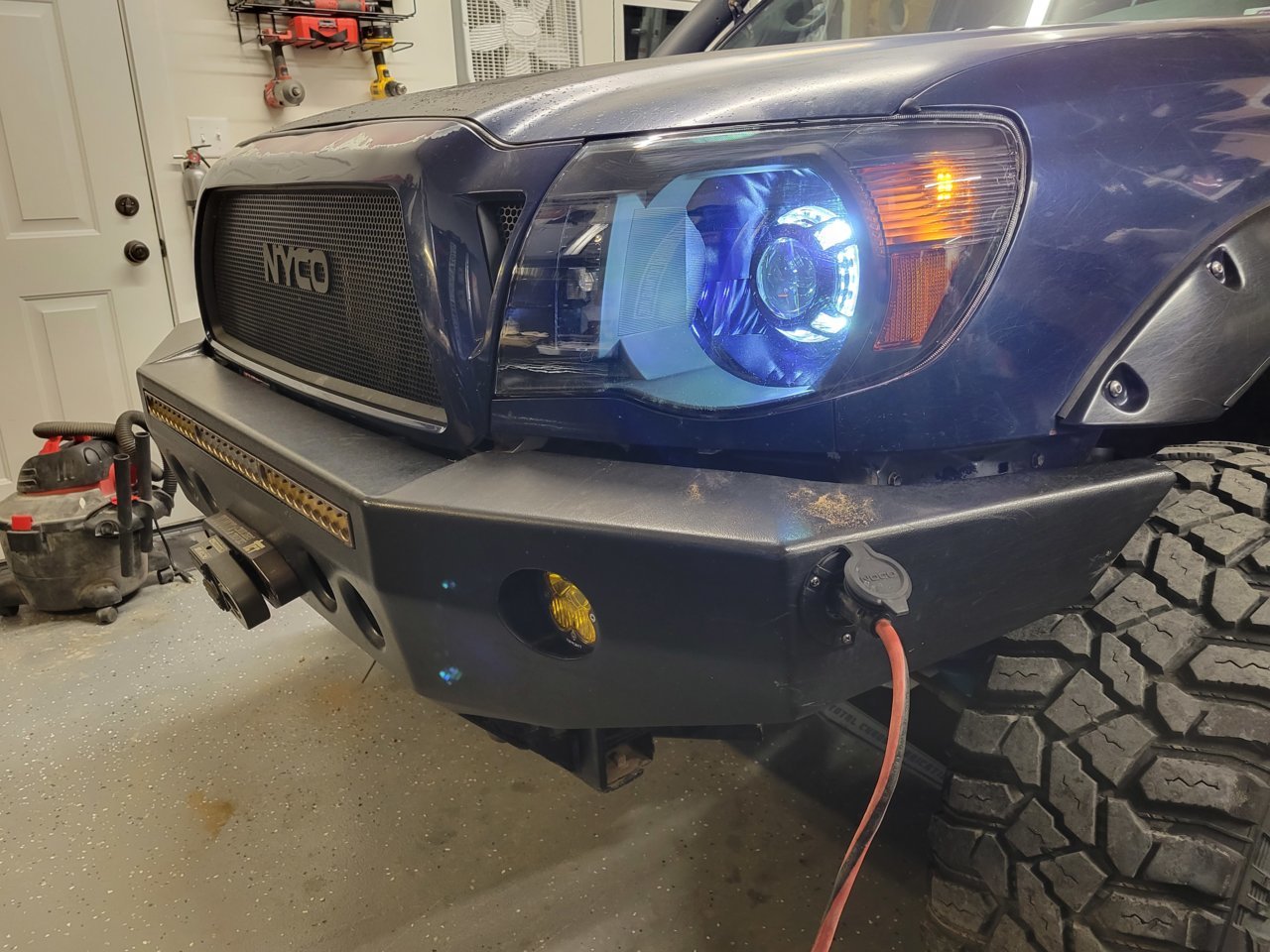

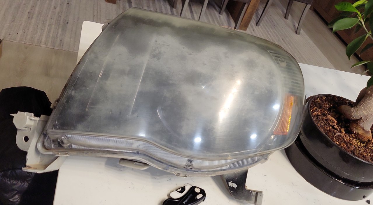

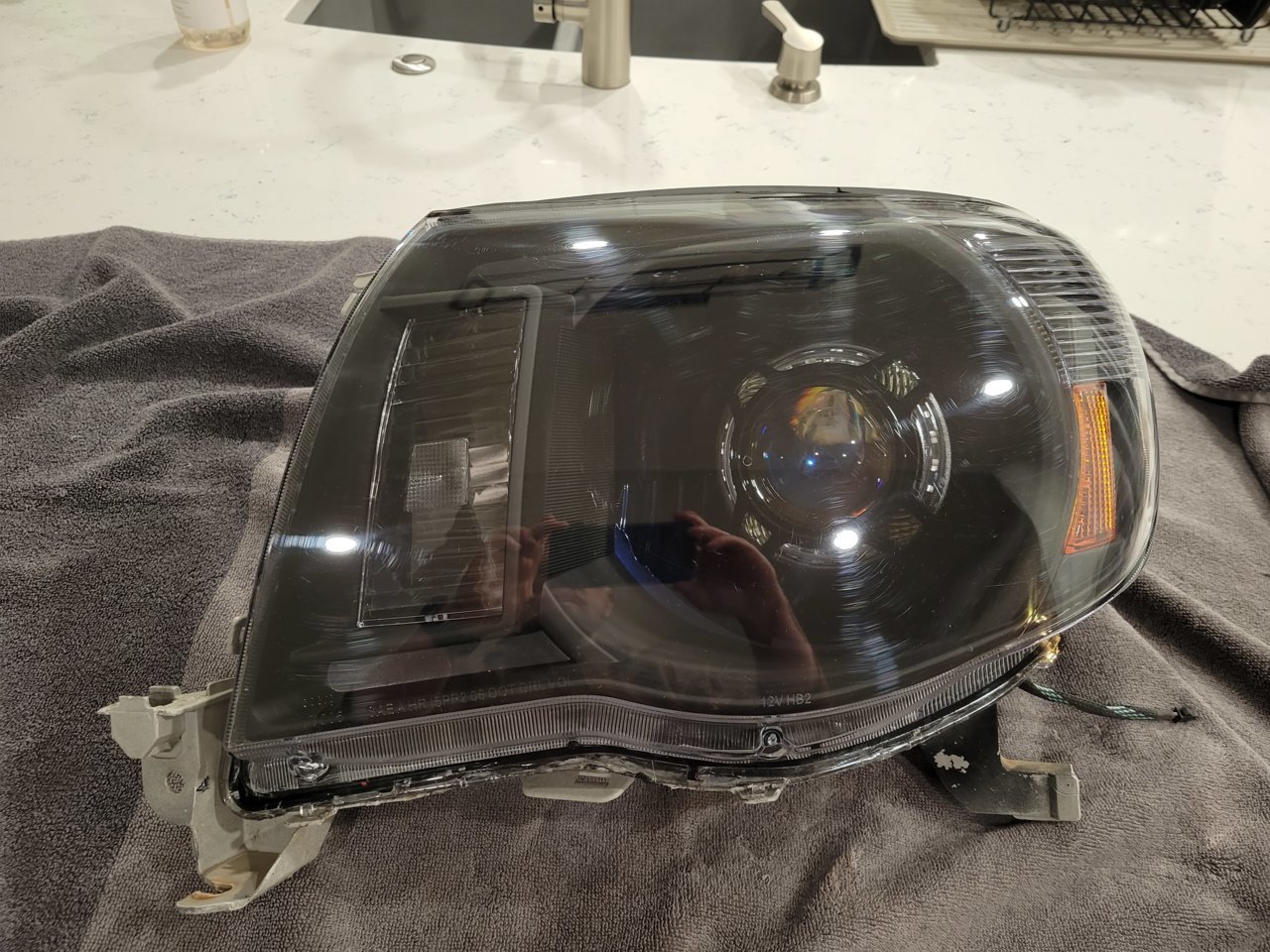

    Making some progress..
    Headlight retrofit
    Frame boxed, cmc, spindles gusseted, limit strap mounted, tie rod sleeves and secondary hoop made by Warfab
    From Betty, swapped over the 2" TC expo kit with the kings up front. Rear got the deaver springs and icon shocks (temporary).
    Front fenders cut 2"+ and wheel well beaten (rear to be cut)
    SCS F5 17x8.5 -10 wheels
    Toyo open country r/t trail 35x12.5
    SOS perf big brake 6 piston kit up front
    Headstrong extended SS lines in the rear
    Magnaflow offroad catback
    OTT tuned (need to reflash after regear)

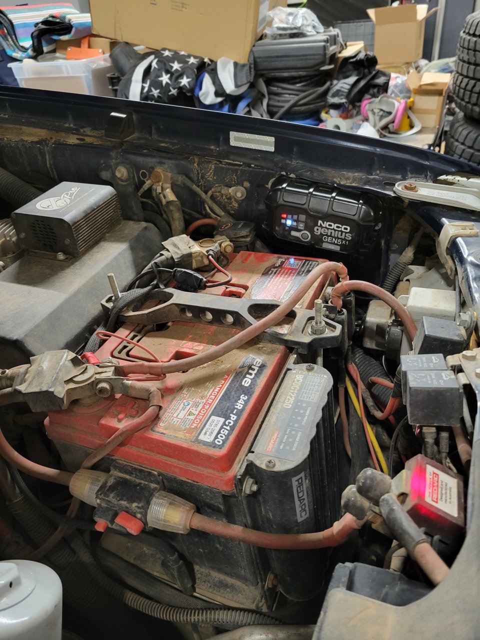

    Genesis dual battery diy tray with a set of odysseys
    Switch pro 12 with a power tray for engine bay mount and wired in the cab...
    Expedition essentials above radio assessory mount
    Birdawg techdech
    Weathertech floormats and window vent shades
    DRL delete
    Smartap blinker relay
    I think that's the big stuff so far..
    working through some maintenance items too to start fresh. Engine and front diff oil changed so far. Will do tranny, tcase and rear diff before our trip in July. Air and cabin filters changed (went with afe pro dry for the intake). Belt to be changed, new wheel bearing assemblies will be swapped in..
    basically hitting the refresh button on maintenance items so i know where exactly things are at. Carfax gave me some good news seeing all the services done by toyota, but you never know unless the truck has been in your hands.
    Long list to knock out still in a short time to get it ready for a 2 week adventure!

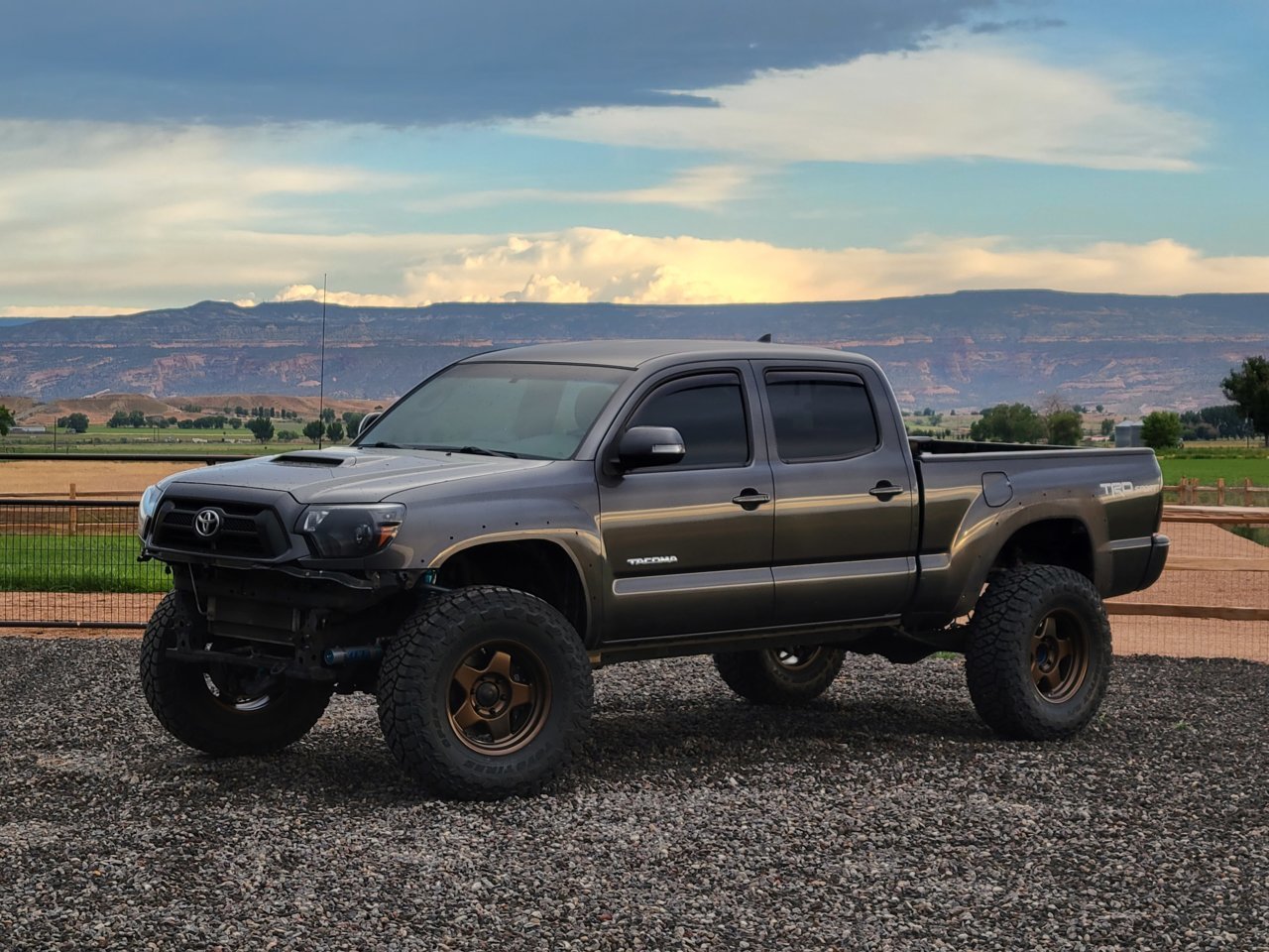

    Almost time for electrical work and fine tuning some items...
    Front bumper didn't work from Betty, so i need to rethink that...

    tires look small on the truck. the DCLB makes tires have weird proportions. everything else looks good tho

    Damn that looks sharp ! I think that's my favourite Tacoma color for sure - congrats
