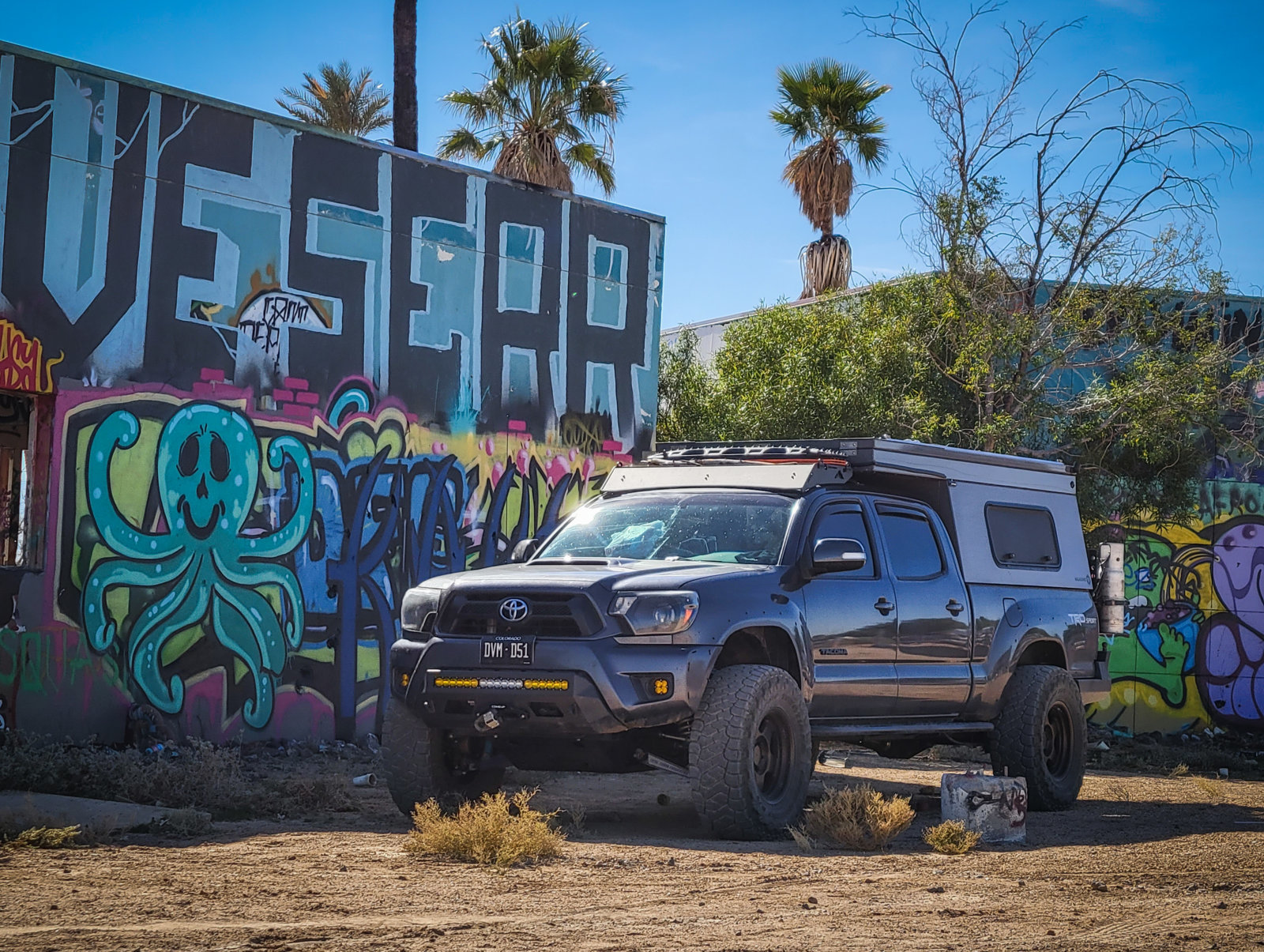

    Figure it's time for another update...
    Maggie is nearing completion on the initial buildup... should be able to get her wrapped up in the spring. She's mainly in hibernation these days... I'll need to get a build page going for her, she's got a lot of fun going on.
    Here she is before we hit the Mojave Road back in Nov..

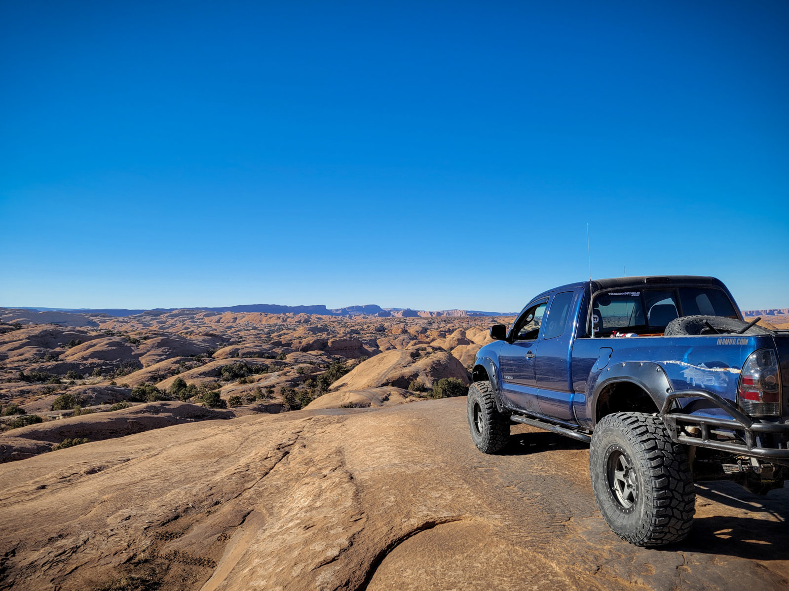

    And Betty has returned in the form of a dedicated wheeler.

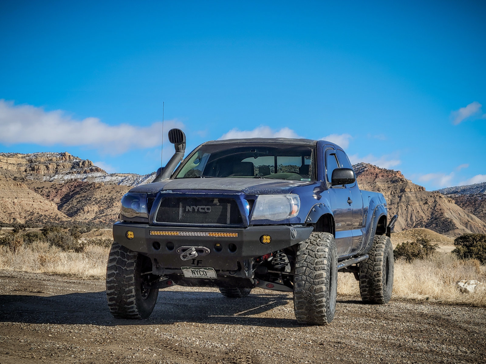

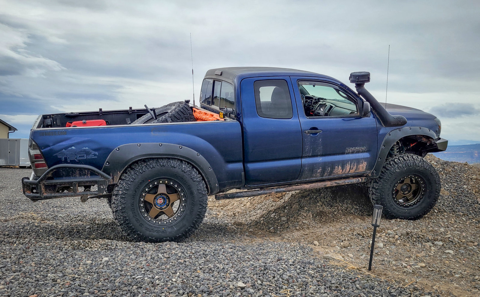

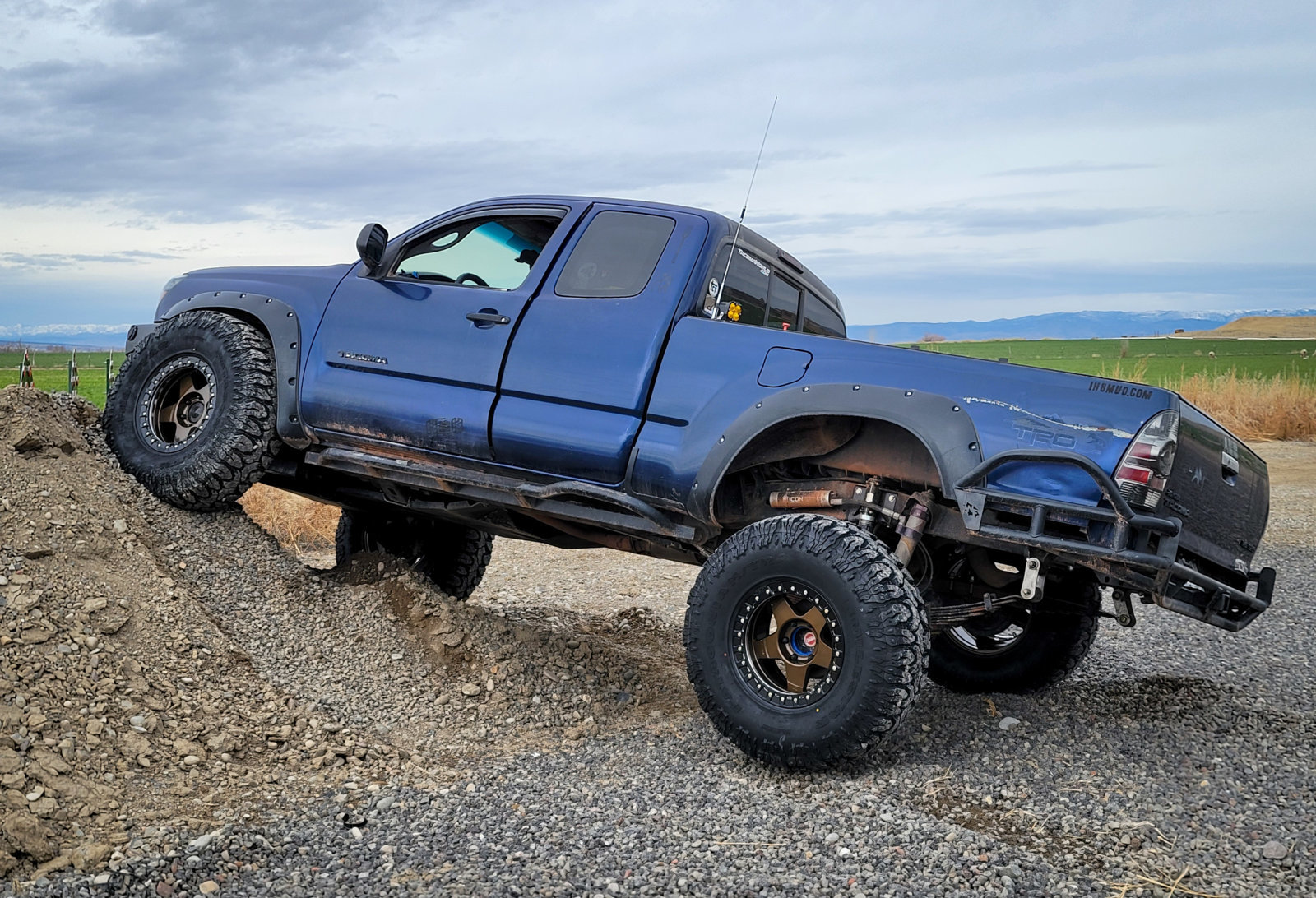

    JD Fab 2.25" LT kit with fox up front. Kept the icon rear shocks. Took the overload leafs off the deavers. Threw on an archive garage shackle flip kit i had laying around. Added Icon hydrobumps. Warfab desert storm rear bumper. Spare now in the bed on a mount i had laying round. Group 31 battery mounted in the bed. Took the switchpro out and really simplified a lot of things.... glad to keep Betty around, gonna be fun to wheel again without having to worry about all the weight and expensive things on it.
    Time to revisit some moab favorites and add more to my completed list

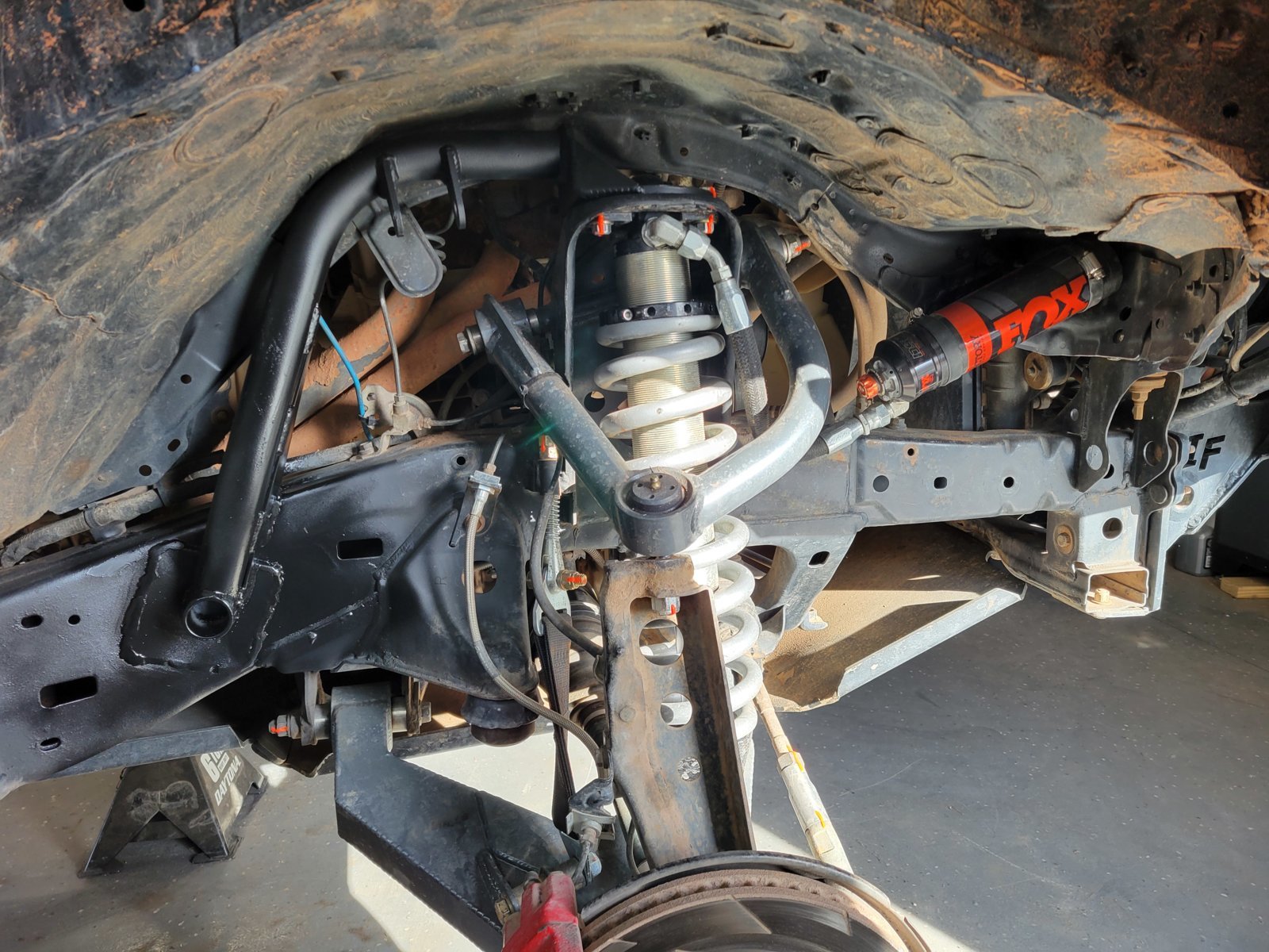

    Chippin away... had to cut out my TC shock hoops for the JD Fab kit.. ended up getting the JD hoop to add back in there. Adds strength to the bucket and gives me the secondary option later if i wanted to get fancy.
    Also moved my resi mount up and out of the way more for better tire clearance...

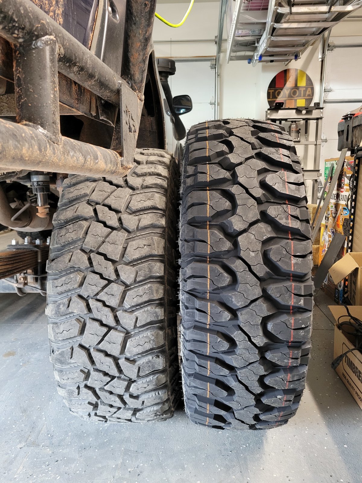

  13. Mar 18, 2024 at 11:29 AM
    #6973
    NYCO
    NYCO [OP] go explore...
    Jul 27, 2010
    #40842
    19,126
    bOb
    Colorado
    Blue Betty - '06 TRD OR
    dents & scratches

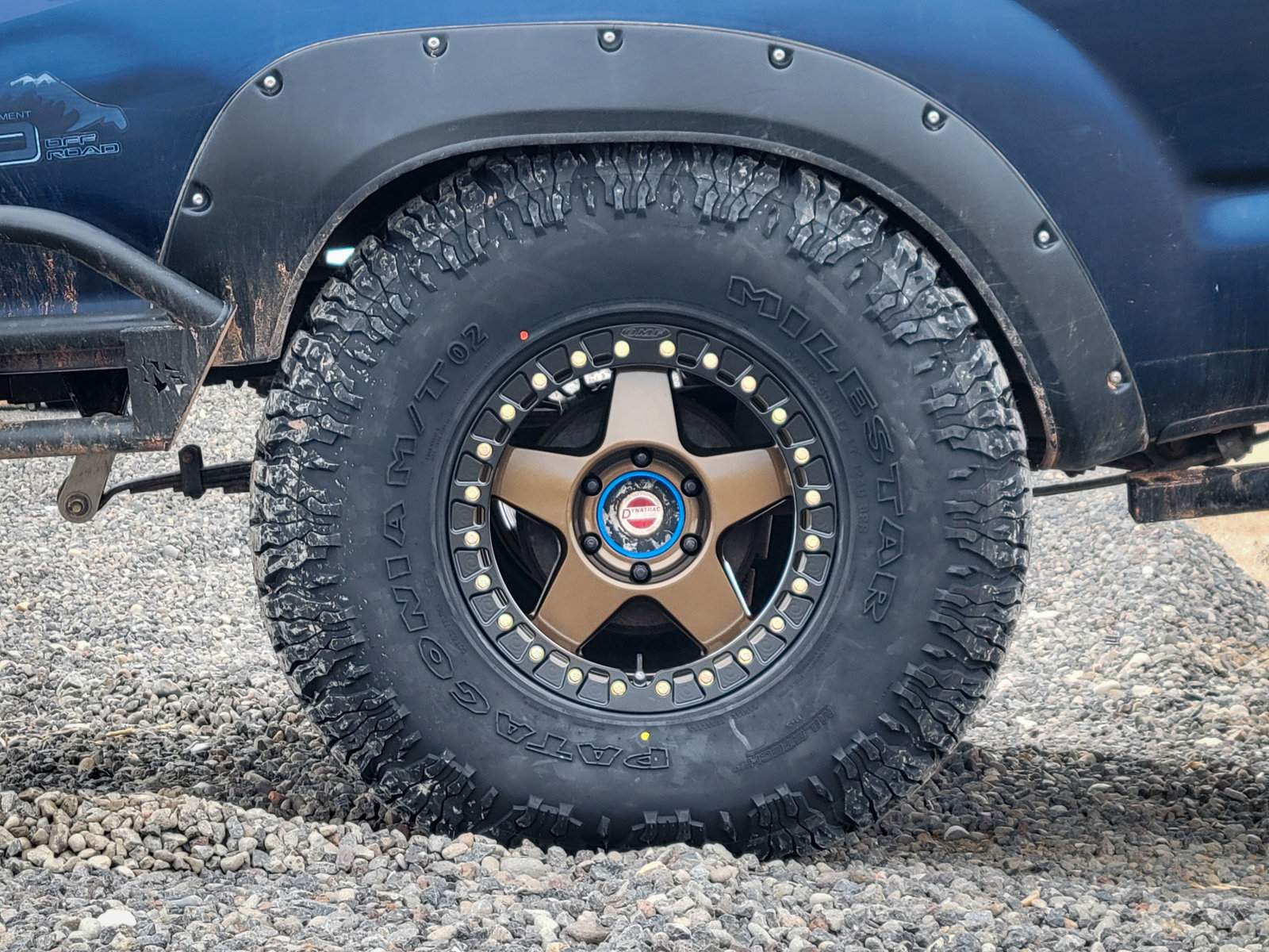

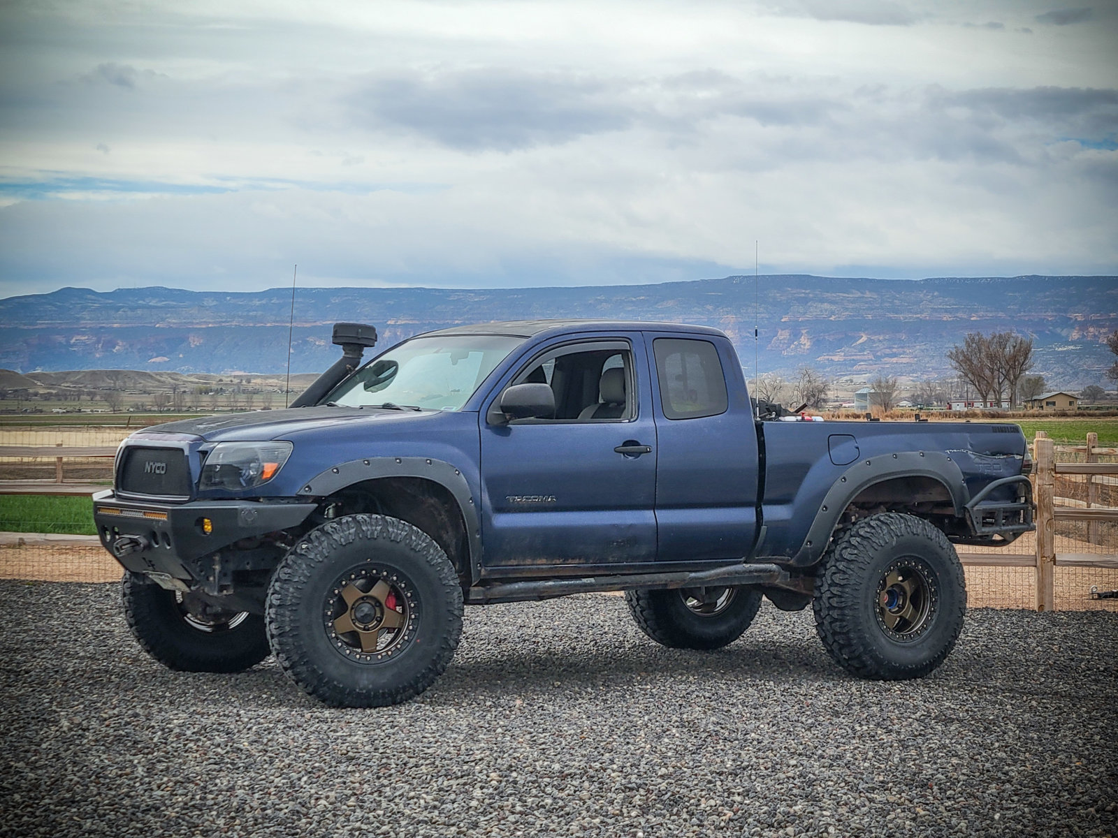

    New shoes... some assembly required
    la0d0g, PS78, BradyT88 and 5 others like this.

  16. Mar 30, 2024 at 12:16 PM
    #6976
    NYCO
    Jul 27, 2010
    #40842
    19,126
    bOb
    Colorado
    dents & scratches

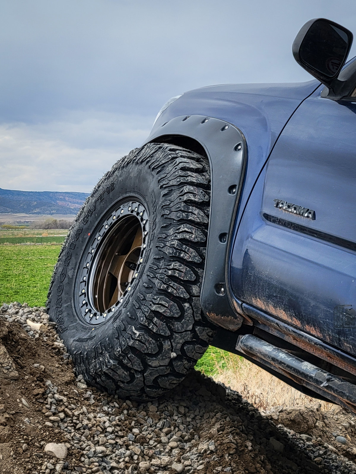

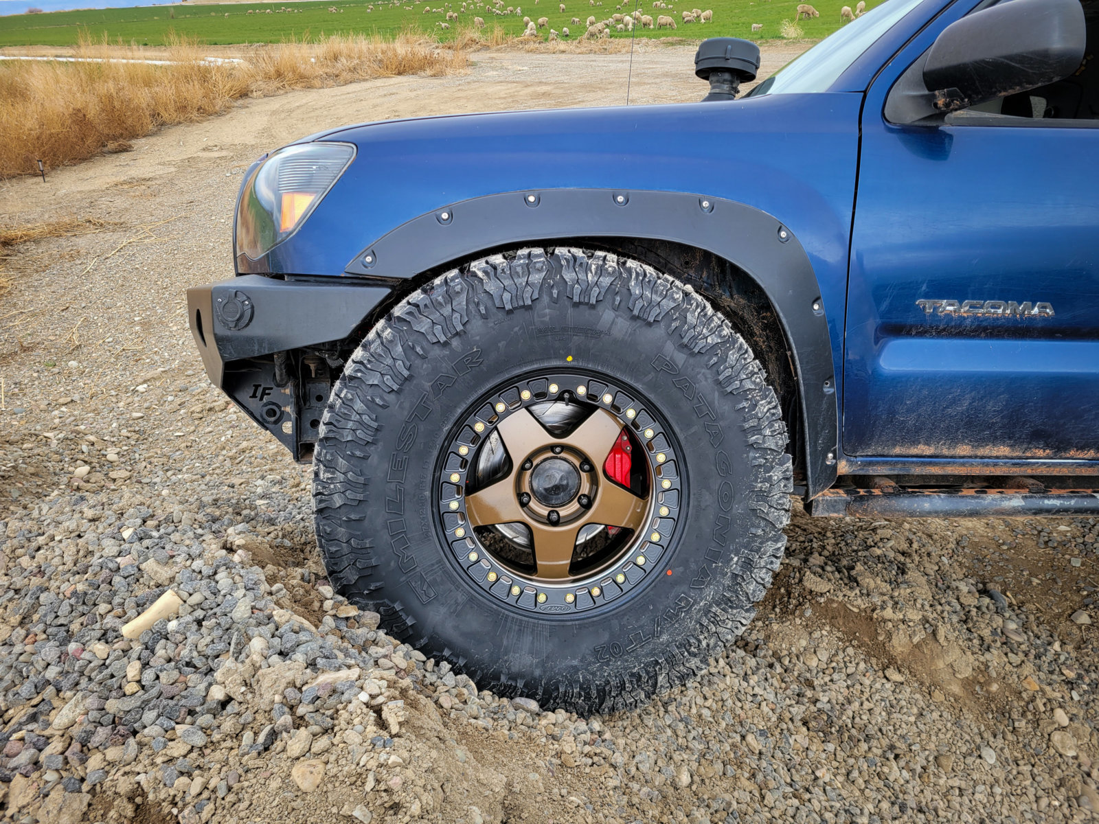

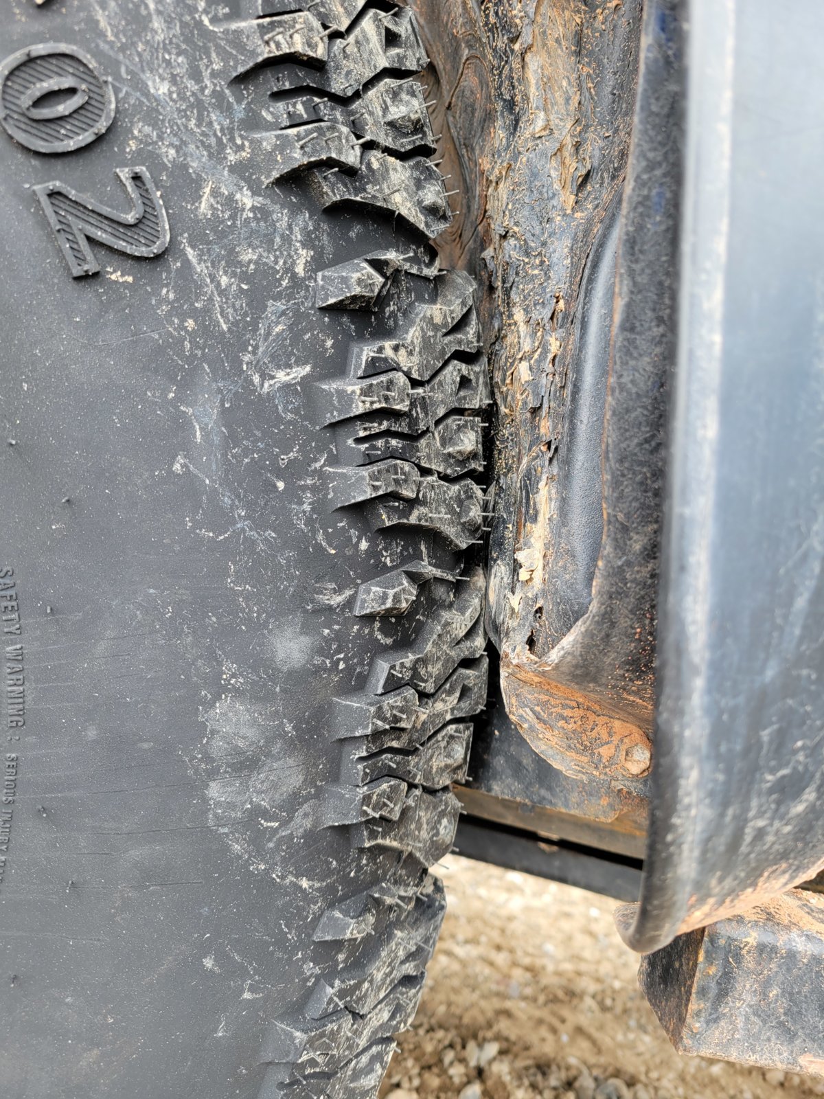

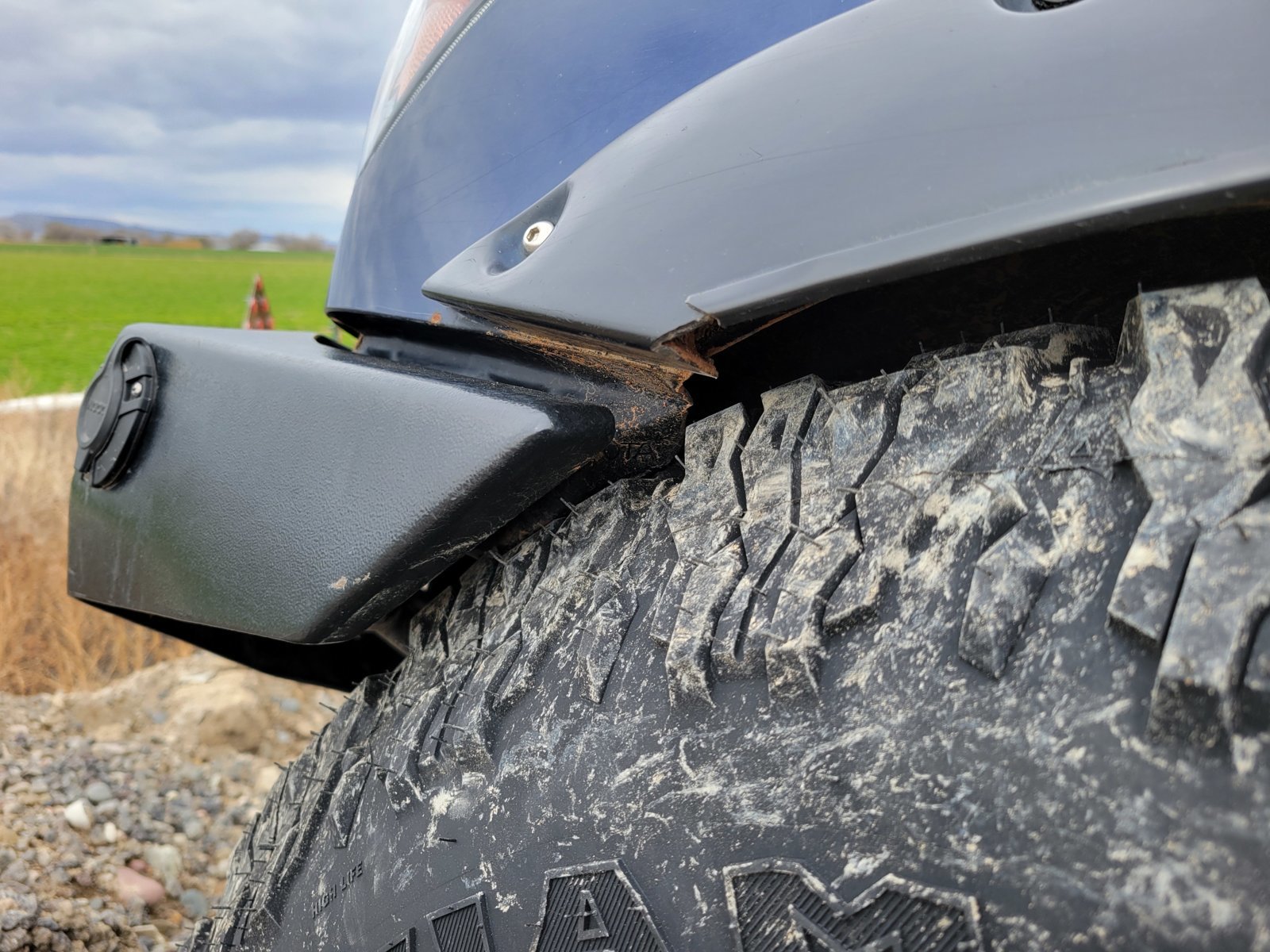

    Got some work to do for max clearance, but she's damn close and looking real good on 37s!
    alee891, Winkle99, la0d0g and 3 others like this.
