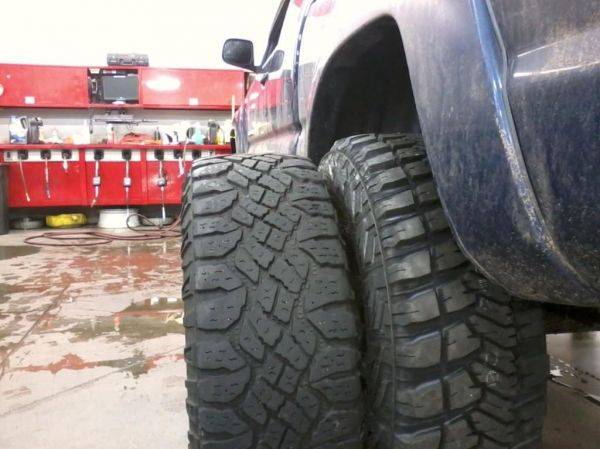

    what did you order for tires?
  3. Mar 23, 2013 at 7:27 PM
    #1283
    hard2kill
    hard2kill Well-Known Member
    Apr 28, 2011
    #55714
    3,862
    John
    Rhinebeck NY
    06 4door trd sport white 6spd
    ...315's,2in bora wheel spacers,safari snorkel,wheel spacers,bruteforcefab rear bumper and sliders,afe filter,hi-lift jack,5100 with OME 886 & 1/2in spacer,allpro expo's,icon 10in rear shox,flip kit,ss brake lines,cobra cb,fog light mod,yellow fogs,weathertech mats,fullsize spare tire and extra sport rim,tinted windows,aeroturbine 2525 muffler dumped over axle...rear diff breather mod...removed factory spare...removed 2nd air filter...THULE roof rack and fairing....bud builts front to back,allpoo front bumper,BAMF lca skids,overland Offroad roof and bed racks,
    gaurd dogs.....315-70-17's
    i run them in 265 on my work truck and they WAY out perform my km2's believe it or not....

    34.8x11.4 for the 315-70-17
    plenty tall and alittle more narrow then the 35x12.5/17 km2's i have on there now...more clearance less rub

    YEAH .....the 315-75-16 is 12.2 wide an the 315-70-17 is only 11.4in not sure why but im ok with a 35in skinny ;) and best part was 949 for 5 shipped to my door
