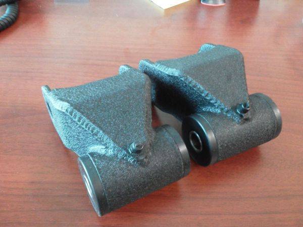

  16. Mar 29, 2013 at 1:07 PM
    #1356
    NYCO
    NYCO [OP] go explore...
    Jul 27, 2010
    #40842
    19,126
    bOb
    Colorado
    Blue Betty - '06 TRD OR
    dents & scratches
    got these guys in today :D
    also got some TC spindle gussets ordered up today...
    so much for not doing many mods this year :eek:
  17. Mar 29, 2013 at 1:40 PM
    #1357
    Gramps
    Gramps My walker is faster than your Prius!
    Feb 7, 2011
    #50695
    14,327
    Gramps
    Colorado! Where else?
    07 TRD DC 4x4
    A small handful of select mods.
    Where do you work again? I am so coming to your office and stealing those off your desk. :D
