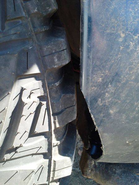

    nope...gone full lock to lock though with no issues...
    compression and turning, i have no idea yet...but from the looks of it from when i was on the rock, there's no major issue at the moment
    pinch weld is already beaten and with the fender and flare beat/cut back, it should be close to good..
    there are instances where my tires would stuff more...like here,
    and may need some trimming on the top of the flare, but we'll see when i get an opportunity to push it that far..

    ^That is where you will have issues if the pinch weld area is not beat back enough. The two main areas for me are up front underneath the washer fluid reservoir on PS and the same area on DS, and the pinch weld area and about 3-4 inches towards the frame.

    you're having issues up front too? hmmm i don't recall anything coming close up there..but i never looked that hard up there as most of the issues commonly are found in the back of the tire

    At full stuff and full lock (with coilovers pulled out), yes. I had to bash that area upward about an inch. It shouldn't stuff quite as much with the coilovers in though. But my goal is to have no rubbing at all, ever. So I figure I will do more than is needed..

    just looked up in there this morning...i see what you're talking about...i'll have to see how close i come with the bumps...but maybe a bfh and snips could help out a bit..
    i've gone in about another inch in that area and beat back the metal fender in that area as well..should be good back there...
    it's now whether or not i'll hit up top on extreme compression and in the front like jon was pointing out..
