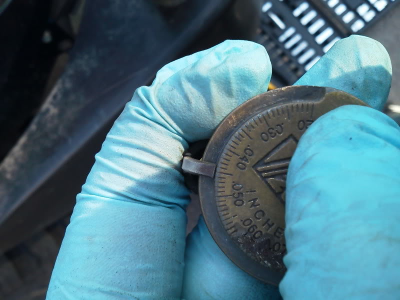

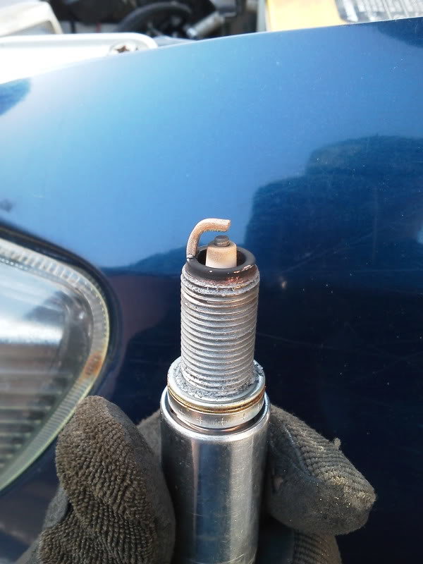

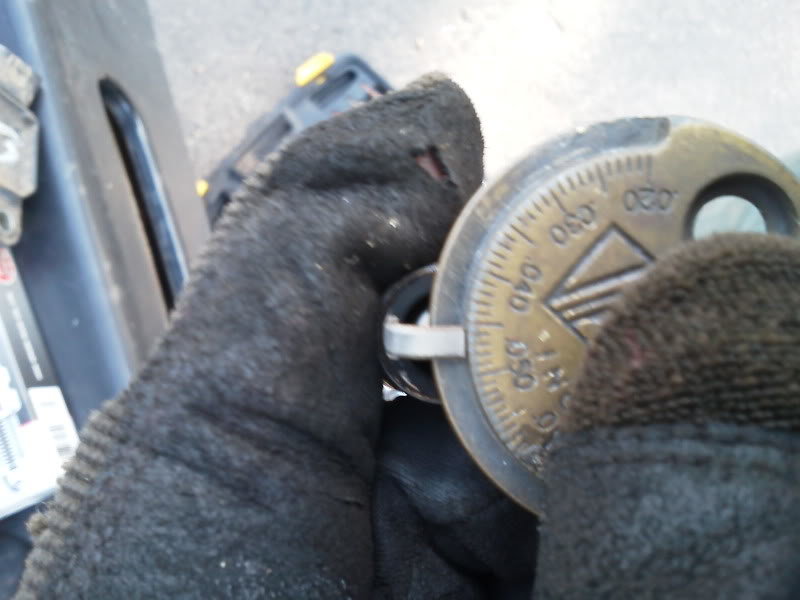

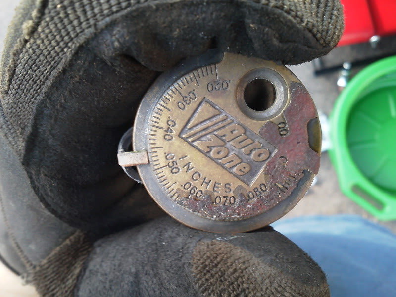

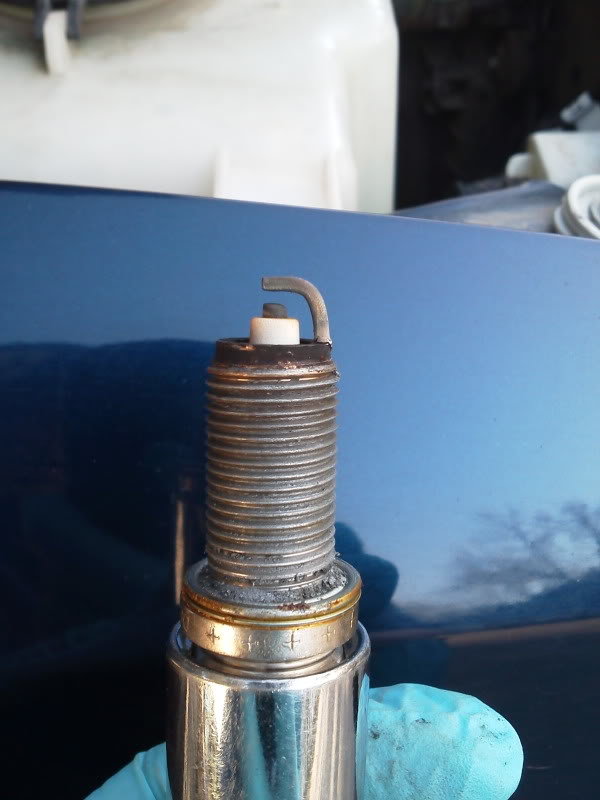

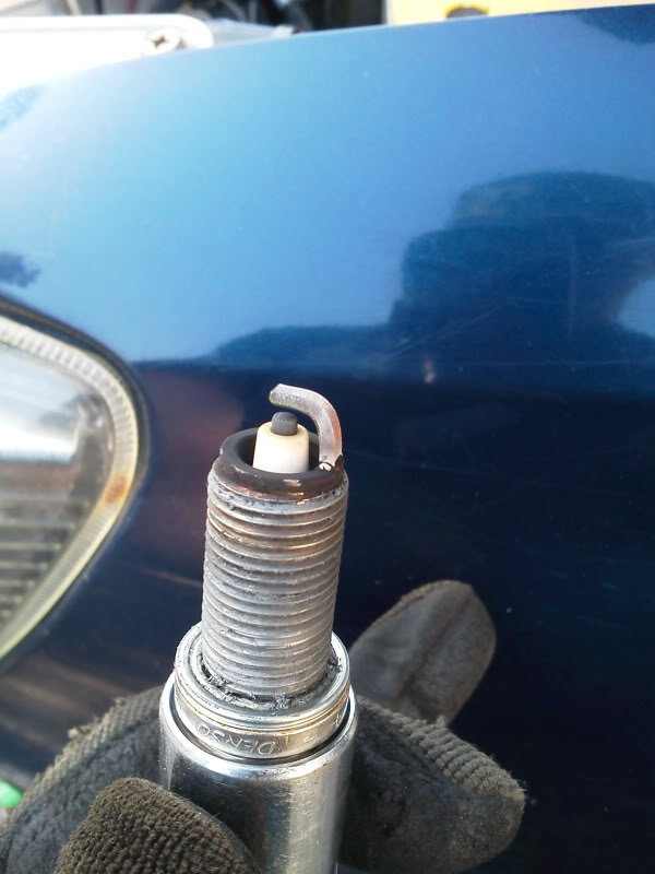

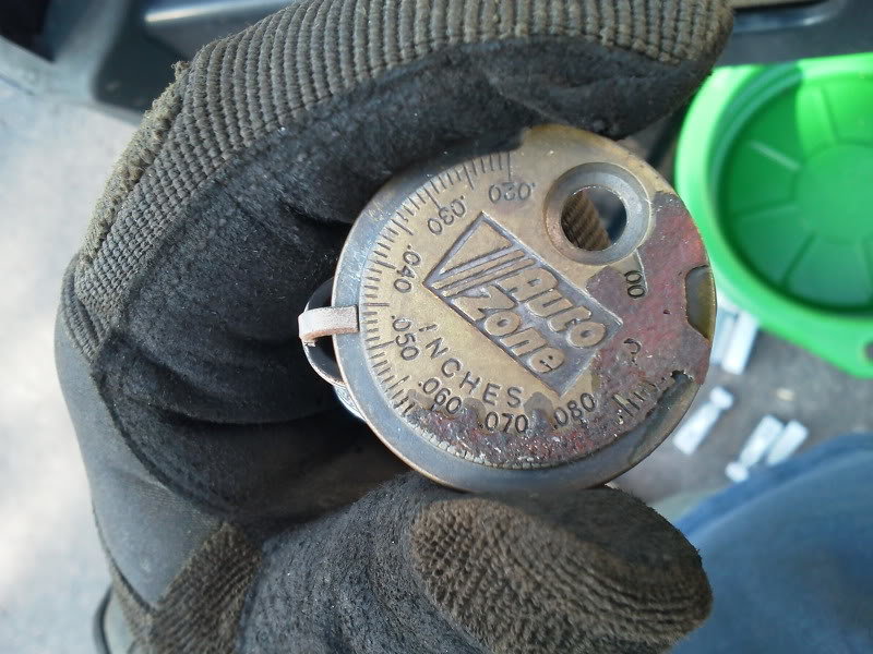

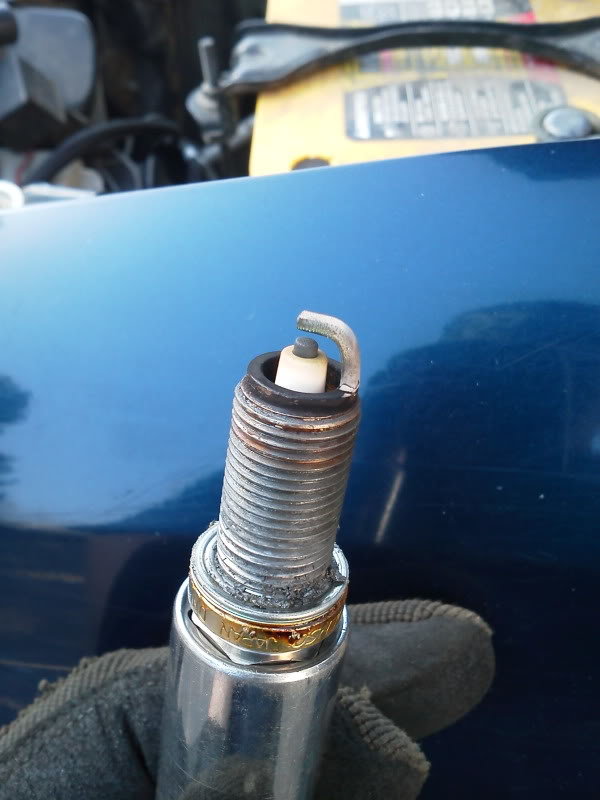

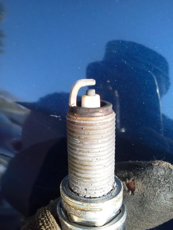

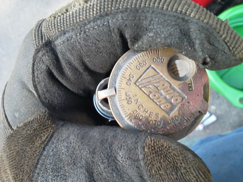

    for reference.. ~120,000 mile plug change
    plugs from 1,3,5,2,4,6 in order (passenger front to rear, driver front to rear)
    3
    5
    2
    4
    6
    fluid changes went well too...engine oil, front & rear diffs, tranny & tcase all changed saturday as well with nothing notable in the magnets :thumbsup:

    Because I'm too lazy to look it up and I'm changing mine soon, what's the gap supposed to be?

    manual transmission is fairly straight forward...drain and fill til is starts to flow out
    diffs, tcase and tranny used 75w-90 gear oil (mobil1)
    if you have auto and/or LSD in the rear then you'll have more things to watch/do
    gap on plugs should be .043..those pics are what the old plugs came out to showing the wear on the plugs
    gapped mine at .042 this time around on the new ones
